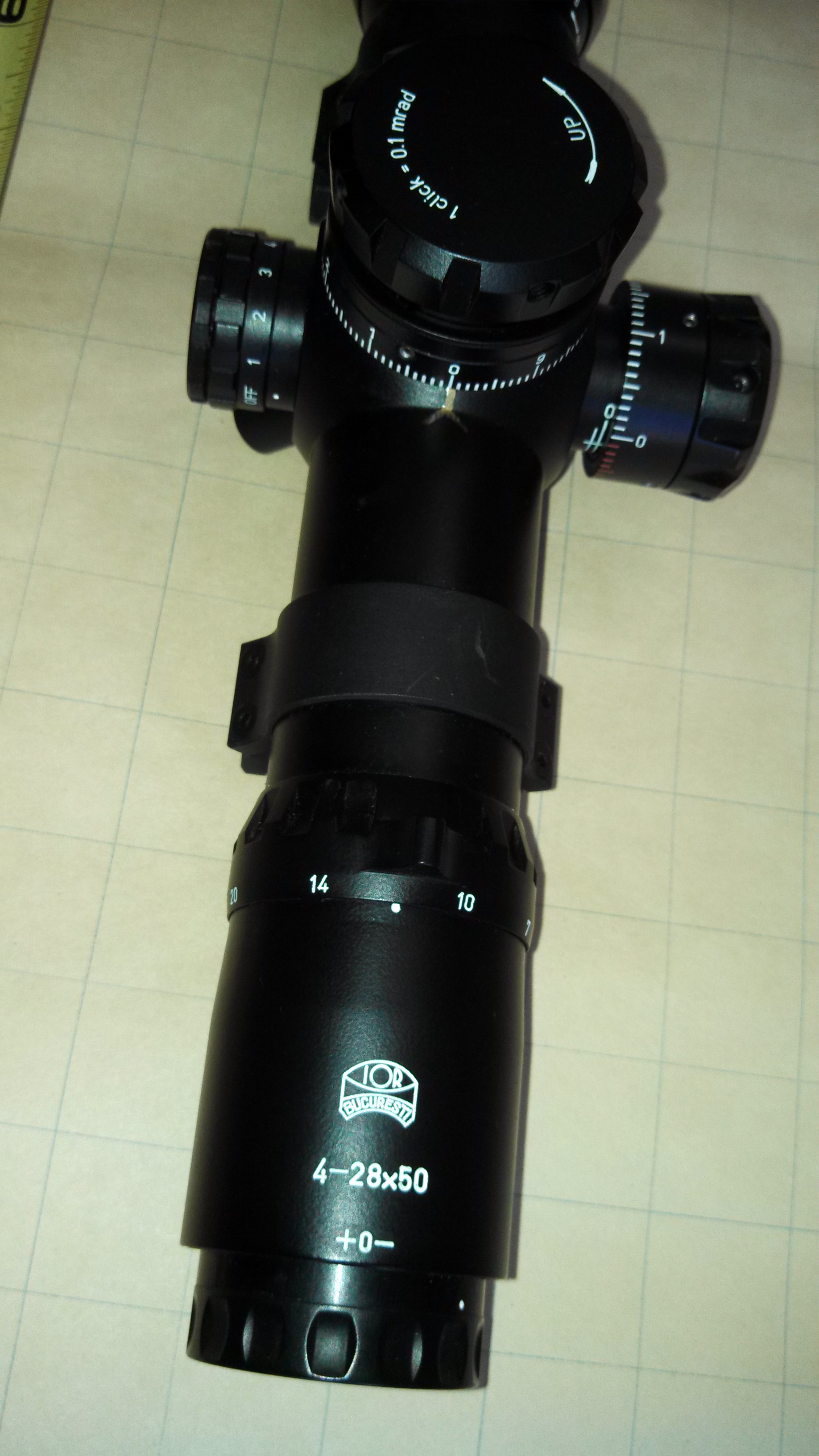

4-28x50 40mm RECON Tactical FFP, Mil/Mil, Xtreme X1 illum. Reticle Review.
I am not affiliated or employed by IOR, Valdada or US distributor in any way shape or form. I have not been compensated, reimbursed or have any financial or material gain in the product nor company. I am not a professional writer or shooter. But I have been an active shooter and competitor for many years. These are my personal observations and experiences with this product. YMMV.
Over the last few years I have seen a few of the IOR scopes around, predominately the 3-18x42FFP scope and I have heard about the durability issues of those units in the various generations. So for he most part, I let others be the early adopters and Beta testers. However I spoke with Val at IOR-Valdada last Summer and he mentioned they had a new scope the 4-28x50 Recon Tactical FFP, Mil/Mil scope. Sounding very tacticool. Long story short, I decided to try it and the CC came out…..
I’ve had it for a few months but hadn’t really had a chance to sort it out, but I finally got down to do some testing.
The scope particulars:
Magnification: 4-28 stated in literature, unverified
Tube Diameter: 40mm
Objective Lens Diameter: 50mm
Reticle: Xtreme X1 (Modified MP-8)
Reticle Illumination: Center Dot Only
Adjustments: 0.1Mil/0.1Mil (10mil/turn elevation)

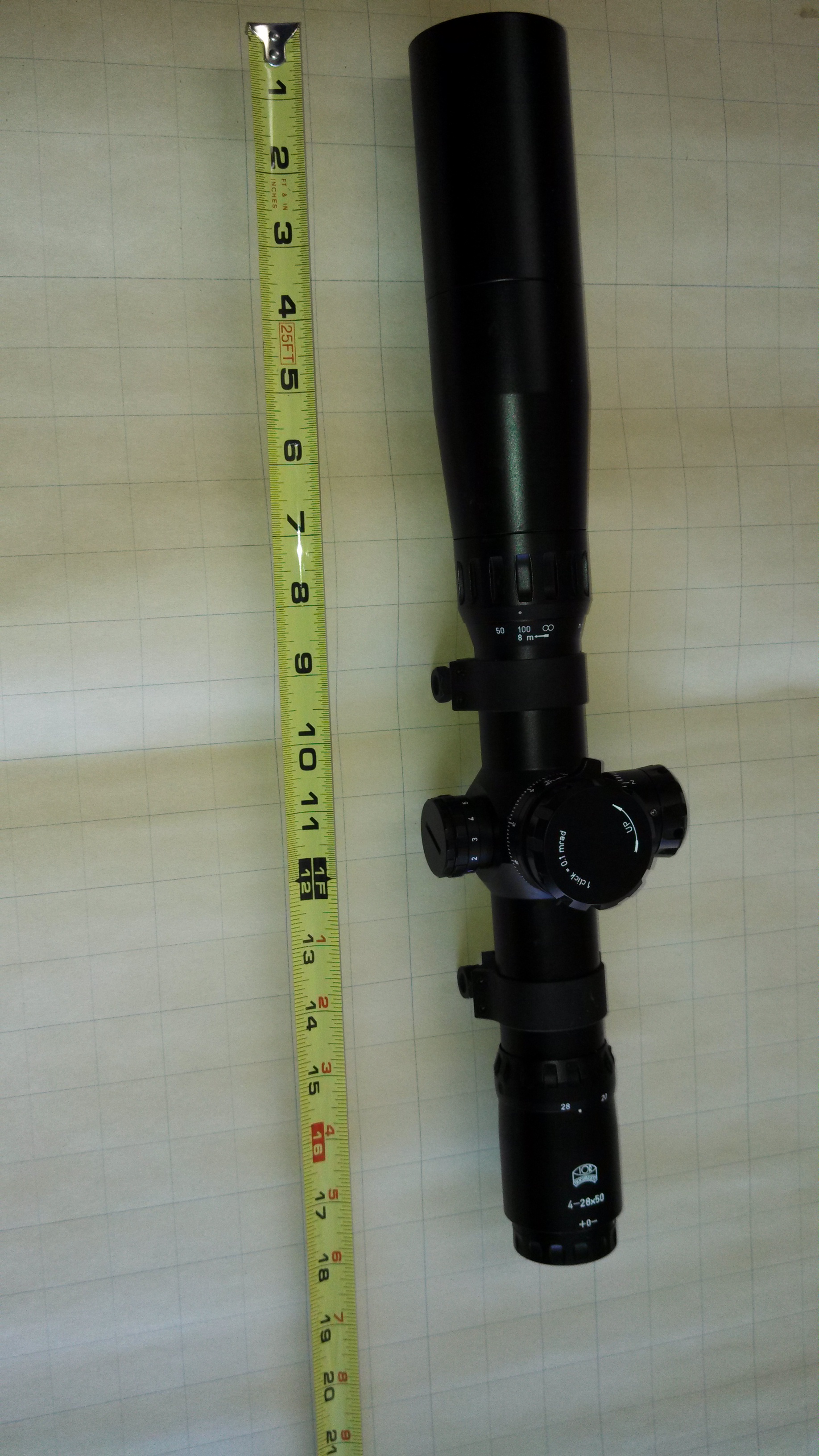

Length: 14”
Sunshade: 3.5” included
Ocular Adjustment: Fast Focus

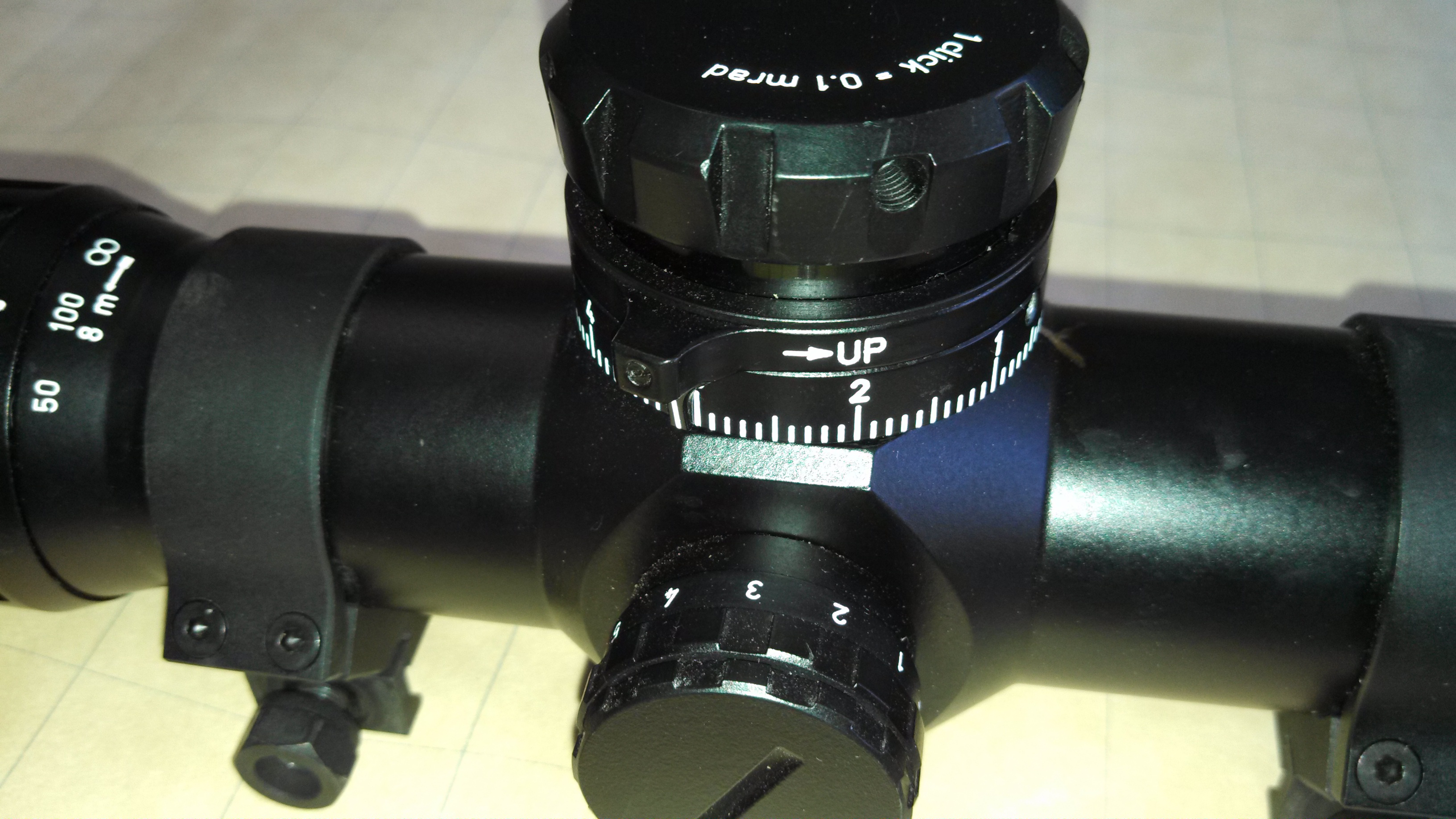

Zero Stop: Yes, adjustable collar with setscrew
Resettable Knobs: Yes, Elevation and Windage, 4 grub screws
Secondary Zero Indicator: Elevation Only with setscrew
Parallax Control: Front Ring adjustment
Weight: 39 ounces without rings or sunshade
Optics:
The Ocular Adjustment is the fast focus type and was easy to get adjusted to my vision. I won’t go into clarity a great deal, as that can vary from user to user, but these are my observations. The scope is very clear up to about 25X with sharp contrast and no noticeable chromatic aberration. It does tunnel a bit from about 7x and below, but since I don’t use it in the low range, wasn’t an issue for me.
I compared this scope to: USO 3-17x44ERGO, Kahles 5-25x56, Bushnell 6-24x50 Elite Tactical.
IOR vs USO 3-17x44ERGO: the clarity and contrast was a toss up with a slight edge going to the USO during overcast conditions. In sunlight, there was no difference.
IOR vs Kahles 5-25x56: the clarity was again a toss up. However the IOR had better contrast. My particular Kahles might be a Gen1 and has great resolution but doesn’t have quite the contrast of some other scopes.
IOR vs Bushnell Elite 6-24x50: the IOR was noticeable clearer and had significantly better contrast. The Bushnell is certainly useable but not in the same class, but not in the same price range neither.
Regarding clarity, I have astigmatism so I am most likely the limiting factor.
Mechanics:

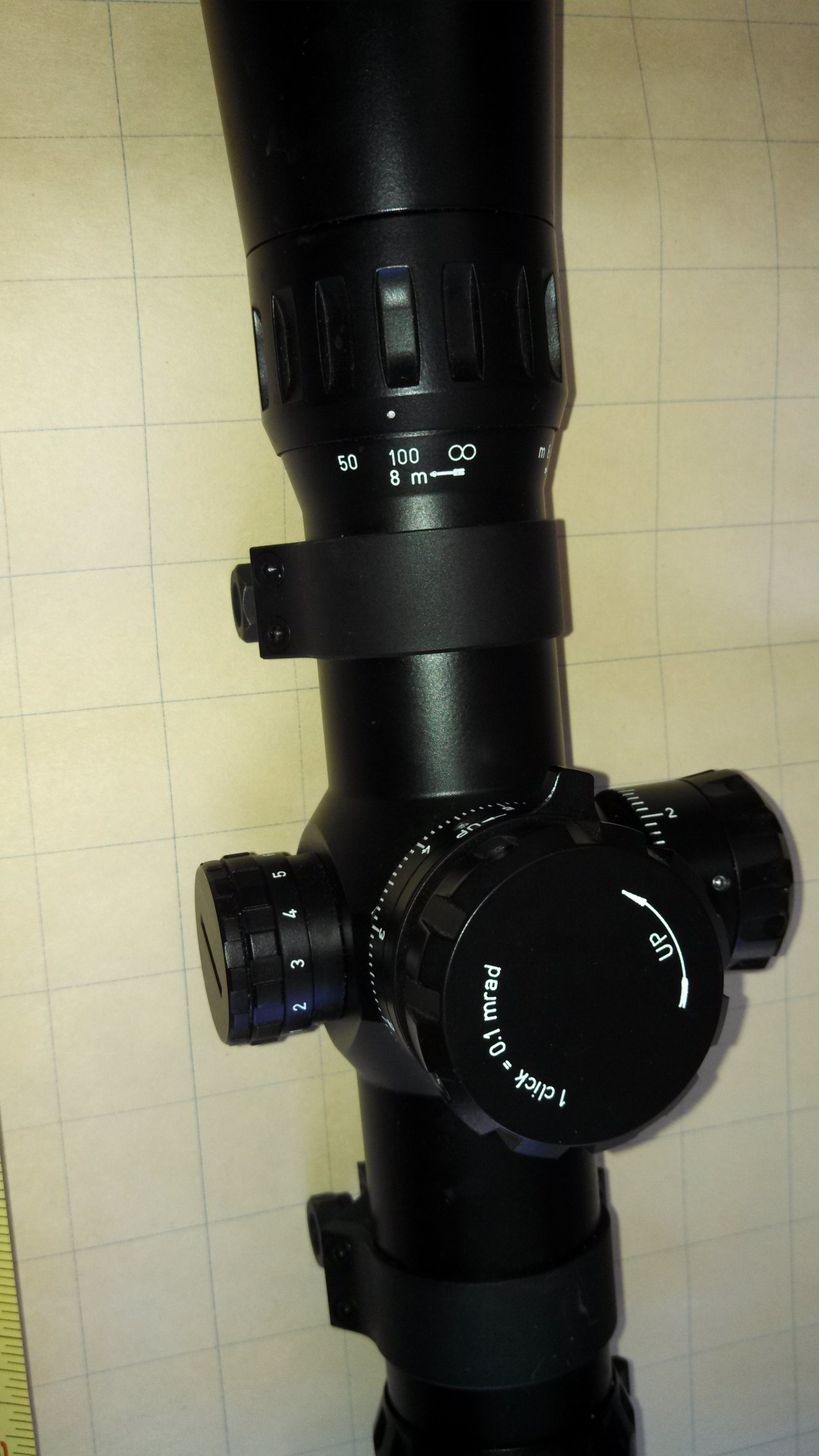

Knobs: The IOR has 10 mil per turn elevation knobs, with a zero stop collar and secondary zero indicator. The knob is very large with distinct clicks and space between the clicks. I had 20mils of elevaton travel from my Zero, so far more than I will ever need. The knobs are reset with 4 setscews, which isn’t my favorite but they work. The zerostop is a collar on the outside of the elevation knob. You loosen the collar setscrew and turn it down, while holding the main elevation knob. When it’s set, you lock the setscrew. The knobs worked fine but to my feel the clicks were a little too light, meaning the knob turned easier than I would have liked. The knob is huge but the clicks felt a bit delicate. That’s only my opinion and you might like them just fine. There is also a secondary zero indicator for the elevation knob, which can be set for another distance or whatever then locked with a setscrew. I never used it but might come in handy for something. Both elevation and windage knobs have travel hashmarks but no tactile indicator for the second revolution (ala Kahles red pop up).
I was able to do a tracking test with the four scopes, all mounted to the same rifle.
Rifle: AIAE MKIII with 20moa canted base
Tracking Test Methodology: From zero, shoot one shot going up 2mils each time, up to 8mils (limit of paper), go down 2mils each time down to zero, go up 8mils, down to zero, up 8mils, down to zero.
Tracking Results:
IOR:
All adjustments repeatable.
Adjustment Error: 2.4 % High (Dialing 8mils gave 29.5”@100yds instead of 28.8”)
USO:
Adjustment Error: 0.18% Low (Dialing 8mils gave 28.75” @100yds)
Kahles:
Adjustment Error: 1.6% High (Dialing 8mils gave 29.25”@100yds)
Bushnell:
Threw one shot wide at 4mils and 6mils, otherwise repeatable. Don’t know if it was ammo, shooter or scope related.
Adjustment Error: 5.0% High (Dialing 8mils gave 30.25”@100yds)
The tracking champion is obviously the USO with essentially perfect tracking. Whether 2.4% or 1.6% error is big enough to worry about; I’ll put it this way: dialing 10mils will put you about 0.2mils high. You have to determine if that’s too much. The Bushnell will put you 0.5mils high…… that is too much for me. But they all repeat, so you can make your own DOPE cards. The sample size is of course too small to make any blanket statement. These tracking errors are to these units only.
The reticle is called the Xtreme X1 is essentially a modified MP-8 with Christmas tree every 5 mils. It is noticeable thicker than the Kahles reticle and a center floating dot what looks like a 0.1mil. It works well. My personal favorite reticle is the USO-MPR.
Misc:
The parallax control is on the front ring, but the objective lenses does not turn. The elevation knob has a pronounced nub for easier turning. The reticle illumination is nearly worthless to me. Only the center dot illuminates, not bright enough to be used during daylight. 40mm rings and bubble level are going to be harder to locate.
The Lukewarm:
Not crazy about the setscrew knob reset.
Clicks too light for my taste
40mm tube limits choices
Illuminated dot reticle (Entire reticle would be BETTER)
2.4% tracking error. USO can get it right, why not IOR? At least it's repeatable, so can be compensated.
The BAD:
The scope appears to not be hard anodized but instead looks painted a matte black. Out of the box it looks great, but the finish easily wears and shows scuffs. I don’t abuse my gear but I don’t baby it either and the finish already looks worn, without any matches. I’m guessing rings marks are a guarantee. This scope deserves to be hard anodized.
It’s a HEAVY pig. The saddle is a huge rectangular block. They didn’t try to take any weight out of it. Must be getting paid by the kilo.
That is about it.
