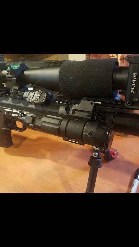

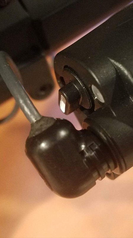

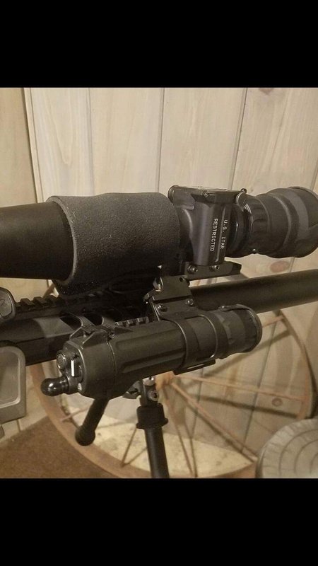

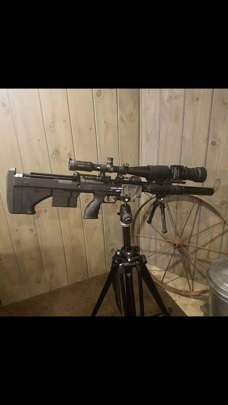

I did a ton of reading in search of a quality IR to help illuminate my pvs30 on dark nights. I tried the luna optics ELIR-3 ( which someone recomended here who loved it) and sent it right back to optics planet. Its realy weak with those new filters. It went back immediately.
Than I tried the Steiner SPIR and wow was i pleasantly suprised. Made in usa, came with a hardcase, 90 deg. pressure switch, amazing quick detatch, even the screws had stoppers so there is no chance of dropping the miniature washers. I mean this thing is a work of art. It petforms amazingly and its got a profile i can live with ( not bell shaped). I strongly recomend this SPIR if you can afford the $600. Rated to 1000 meters i knew i wouldnt out grow it. I love it, life changer for NV.
