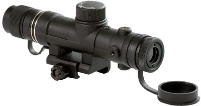

Go to Russia via Pommeyland. Should not have any problems with ITAR going that route. This is probably what you seek. This unit is a super excellent performer. It will light up out to 1500 meters no problem. Eat a meat pie and wash it down with a Toohey's for me. Miss the hell out them meat pies. Where are you located in the land Down Under? Gunnedah for me from 66 to Nov 78.

The illuminator you linked looks almost identical to the Lunar optics ELIR?
That Illuminator is the exact same as what is called a Luna ELIR-3 over here in the States. They are made in the Dipol factory in Belarus.

If you search some of my posts you will see some more detailed information about that very unit. Pictures of how I set them up with Thumbscrews in the windage and elevation adjustment holes instead of those allen key screws. Makes it a lot quicker and easier to center up to your optics. Also have some photos taken at 1,000 yards that will show the beam. You can adjust the beam from wide to a laser pinpoint light saber.
