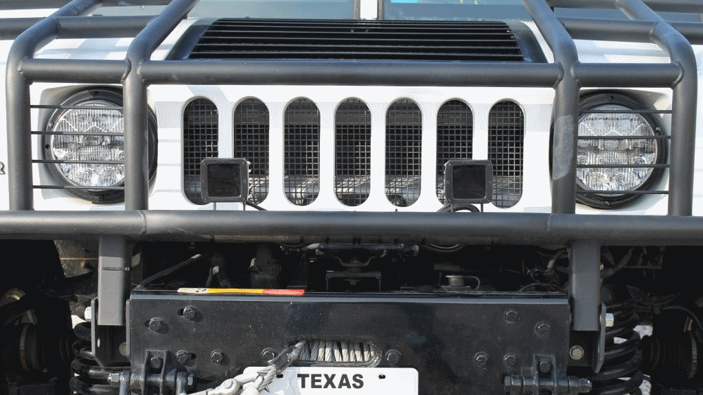

    I put 2 4” Rigid IR driving lights on the front of my truck and they’re plenty for driving in the dark. On a bright night I don’t really need them, but I’ve got a few hunting spots that are off the road a ways. It’s awesome to be able to go down lanes and through fields without alerting the entire area with lights.
    Search ebay for oxley lights, there sre some on there now for 200 plus shipping. Way high but they are hard to come by. I bought two a while back for 71 each. Very small but very bright.
    I did the same thing as this gent did and have been using them for several years. They work fine and Rigid Industries prices are competitive. I had them installed by a person who knows electronics and trucks. They work great with one PVS-14RC.
    Rigid, don't be fooled by how small these are, they put out an immense amount of IR light.
