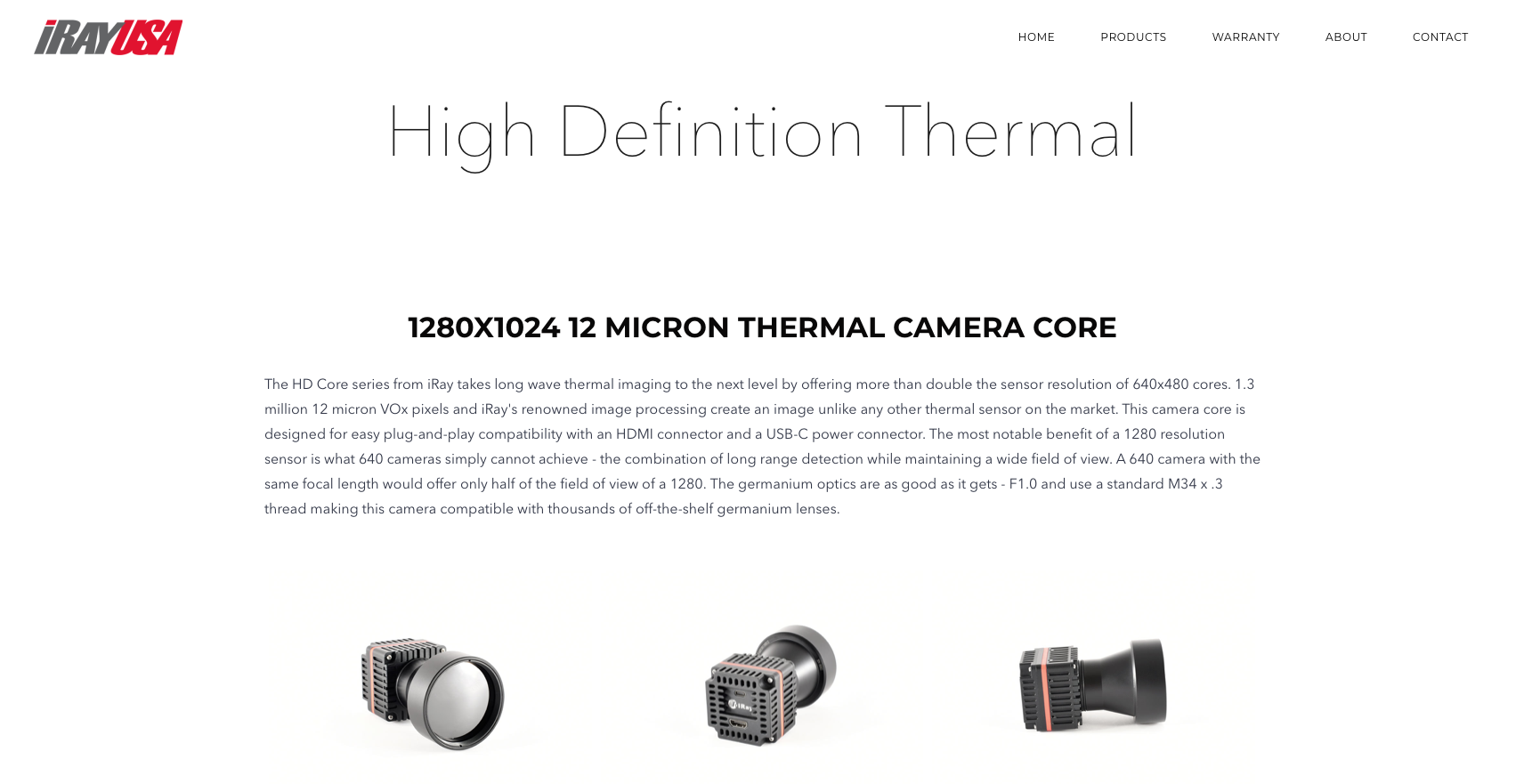

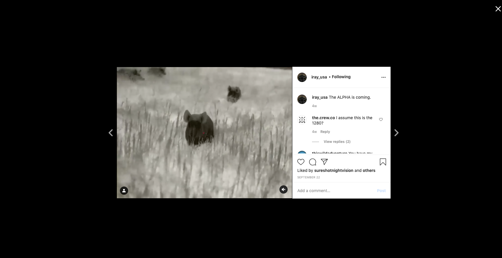

The core has been out for a while, but its not a dedicated weapon sight

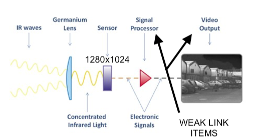

So 1280 core, in theory is just delivering more info to the processor. Unless they change displays & software the image isn't going to improve dramatically... As we can see from the video

Micron pitch on fpa needs to be tighter on the 1280s or lens size gets very large and you're chasing your tail on weapon sights. Specifically LR clip ons.
Theoretically, if we had a 1280 sensor at 12um, that would allow for larger FOV at a given mag right?
Like you said this takes a larger lens; but a unit that has the FOV of a Theon MR but supports the magnification of an LR or ER would be really interesting. To take advantage of the sensor if seems like 1280 or even 4K screen quality would be necessary?
@TheHorta I was talking with Ilya and he said some of the 7-10um sensors had some interesting drawbacks because the wavelength of light they are capturing is the same pitch as the sensor which I hadn’t thought of. I’m sure someone will find a way!
