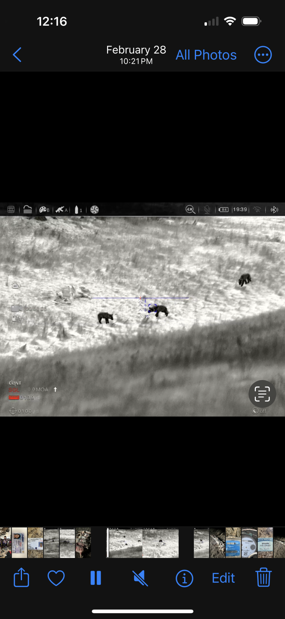

This pic is about 200 yards. It’s clearer in the scope than the pic. I have it posted for sale if your interested
