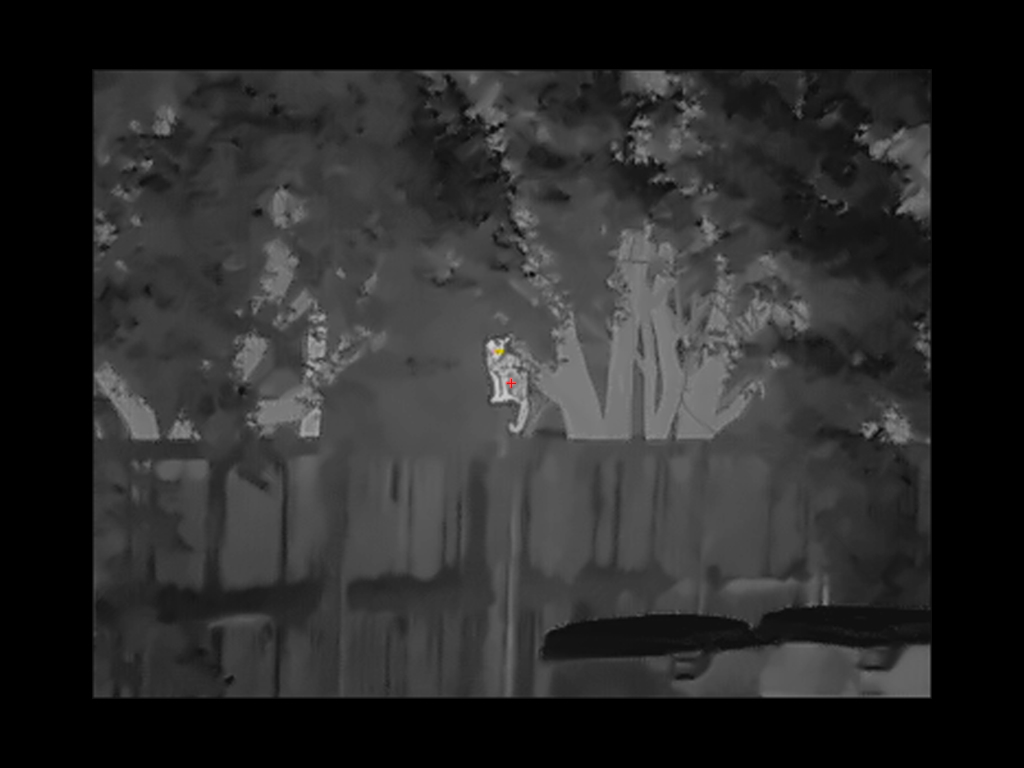

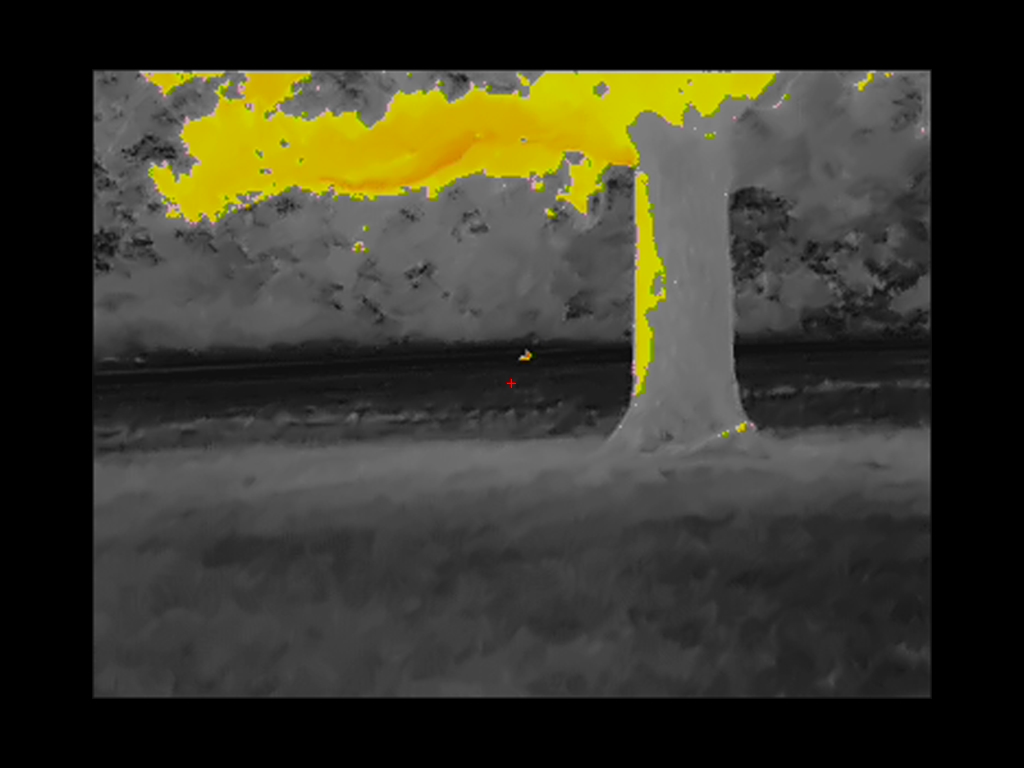

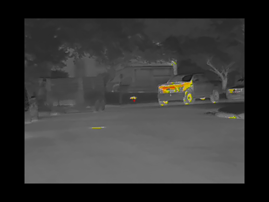

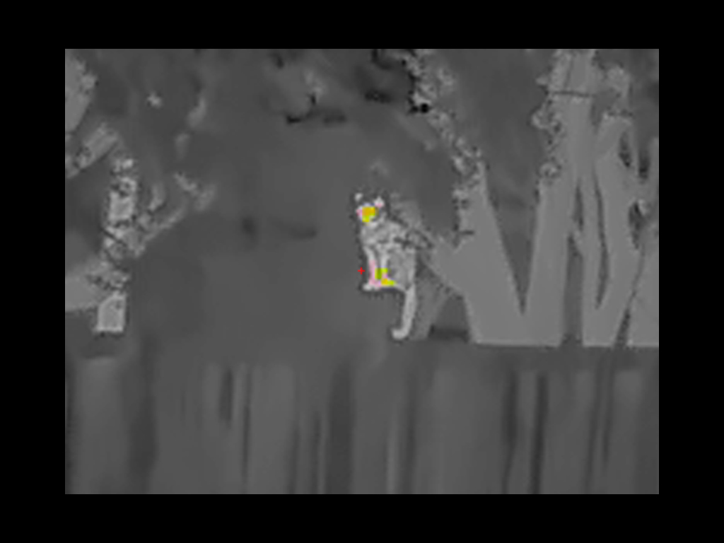

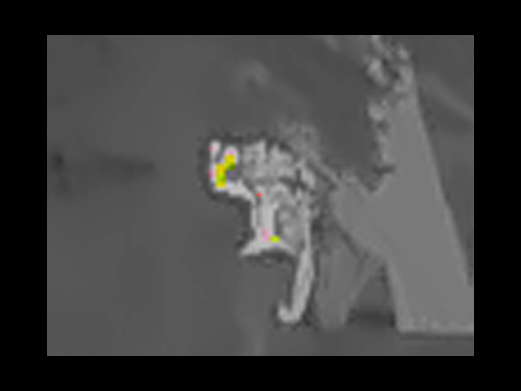

I recently purchased one. I haven't shot with it yet but have used it as a handheld both in my neighborhood and in the woods scanning different animals at night. So far I think it is a good unit.
I'm no expert and only have my Pulsar Helion 2 XP50 to compare it to so these are simply my initial thoughts/opinions with a few weeks of use
Likes: I like the different crosshairs and the ability to change the brightness and color of the crosshairs
I really like the size. Walking around with it was very comfortable. So easy to stick it in my pocket. Very convenient.
I like that it uses 18650 batteries
Out in the open I was able to easily locate animals at night in various conditions.
I bought the ADM mount and plate because others recommended them above the standard mount that comes with it. They are nice but were not cheap.
Cons:
I dislike that it does not maintain my color selection setting. I always have to go in and change to red hot. I hope IRAY USA can update that quickly with the firmware or I can figure out where I am being stupid and get it to save my setting.
It struggled in the woods identifying things compared to the Pulsar. I know it probably isn't a fair comparison with different sensor sensitivities/resolutions/etc... but the Iray would not pick up things at first that the pulsar did easily. I could eventually detect the animal but had to continuously change all the settings to tweak them just right. I don't know if the pulsar algorithms are better or what, but the pulsar needed no tweaking. I was able to spot deer, possums, porcupines, and turkeys with the pulsar and still see the trees and background images more clearly. I don't know how to describe it other than to say the Iray "flared" a bunch. It worked and I could eventually spot a lot of the same animals, just not with the same ease of use. I had to constantly adjust settings which made it a hassle.
If you are out in the open and scanning then I think the RL25 works really well. If you are going into any wooded areas you will need to be more patient with the RL25. I didn't save any images of the issue I was facing in the woods because I was just trying to get it to work but the tree/rabbit image kind of shows what I am talking about with the "flaring" (my word simply b/c I lack another descriptor at this time.) You can see the rabbit and you can see the tree is all lit up. Now imagine you are in the woods and all the trees are lit up. That was making it difficult at times to find the rabbit in all the trees if that makes sense. When I turned down the sensitivity I couldn't see the rabbit. Just had to make constant tweaks where the pulsar didn't.
Here are some sample images all using it as a hand held:
Neighborhood cat roughly 20yds away at the various zoom levels of the device
Rabbit roughly 95 yards away
Possum roughly 55 yards away
