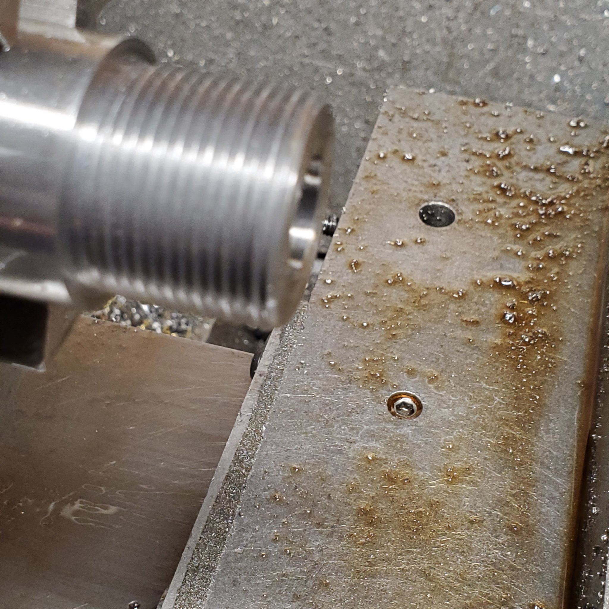

Here's a 1.250" for barrel for 338 Lapua case head, 26" long Remington Varmint countour...but 510 caliber.
Yes it works... Is it the best?
