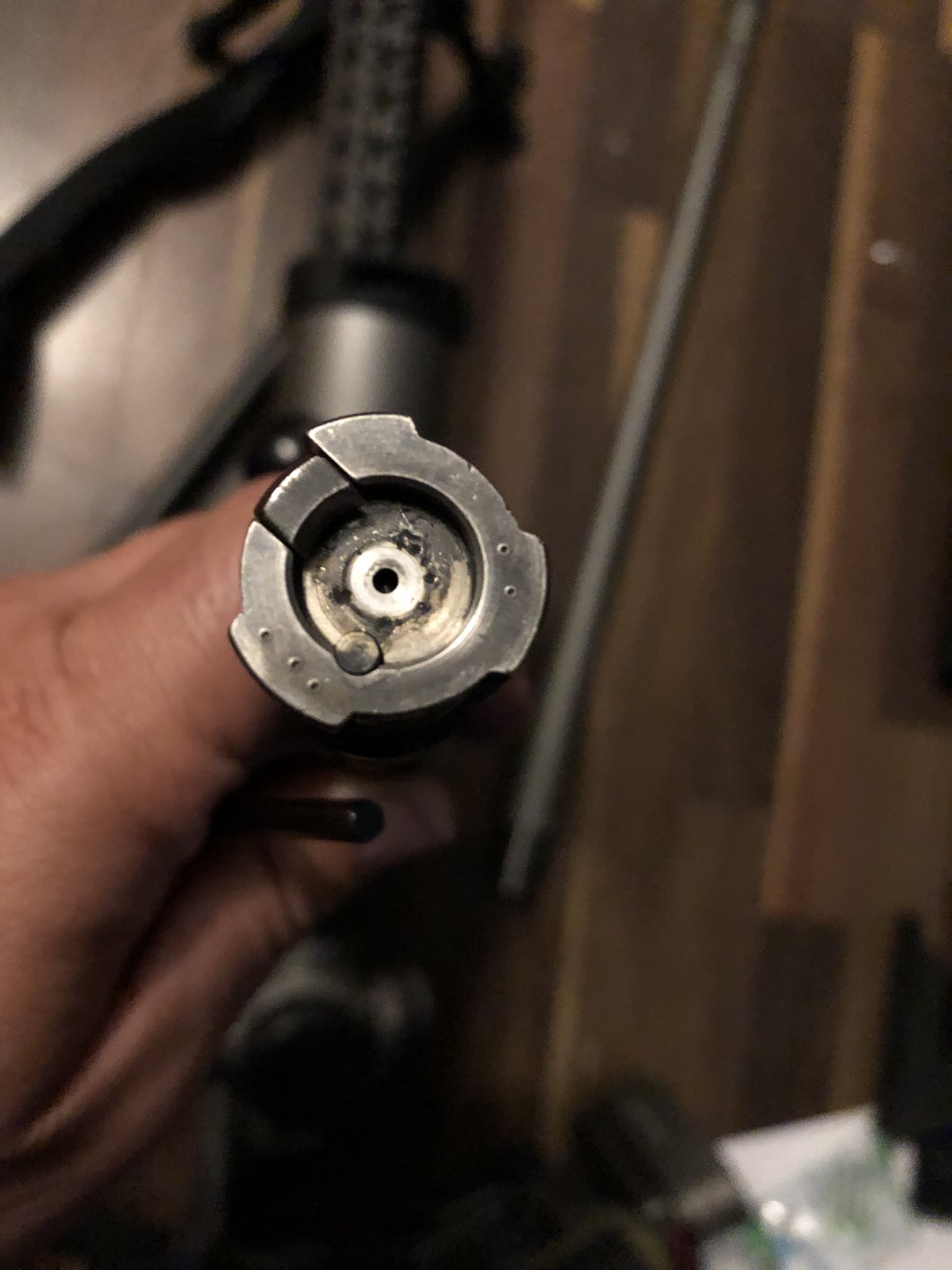

As stated in the title, is there a safety issue with my bolt?
I bought a second hand AI AXMC and upon receiving the rifle I found the bolt to have quite a bit of fire checking. It looks to have been bushed (after the initial fire checking I believe) so I don’t expect anymore issues with it.
Thanks guys!

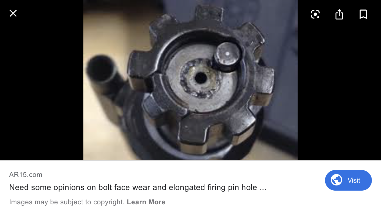

Here is an example on an ar bolt.
Mine is a bolt action. It has happened to me due to soft primers. Can also be caused by excess pressure.
I don’t know what caused it on my newly acquired rifle.

Just about every bolt I own sadly has some of that gas plasma cutting evident.
Winchester primers a few years ago matched with FGMM brass has been my cause.
Safe or not I cant say.
I shoot all my rifles though.
Your AR bolt is way beyond anything my rifles evidence of the problem.
If your AI has one or two pits I cant see it being an issue.

None of my bolts have that. Its not good but its not catastrophic either. You should be able to continue to use it just fine but Ill wait for a pic before any real opinion can be given.

I always have to wonder how the shooter/reloader just lets that go and doesn’t see a problem. I have a friend who did that with one of his guns(shame on you James, you’re better than that!). If the primer just falls into the pocket, drop both into a trash can and move on. Then evaluate how you’re killing primer pockets and work to avoid it.
OP, none of that is directed at you of course. That bolt head is interchangeable, and can be swapped out for a new one by Mile High. That bolt doesn’t look bushed to me, but I could be wrong. Remove the striker assembly and put your caliper on the tip of the firing pin, if its .080” or so, what you have is all factory.
Reactions: Spblademaker
I will only speak for myself and I will say those pictures give me the heebie jeebies. I've never had that happen and if I did see it starting, my response would be along the lines of "Holy Shit"......I dunno, to let it get that bad seems akin to knowingly shooting reloads that have split necks.
I'd get a new bolt head pronto and find out why it was happening and take every step necessary to stop it from continuing.
Reactions: FUNCTIONAL
Looks like pitting to me, but if someone is staking their bushings in place like that, we need to out them, and do our best to make sure nobody uses them ever again.
Your probably right, my vision isn't quite as accute as it used to be.
Since I'm not an AI aficionado like many on here I have to ask since its also in the picture and caught my attention.
Why are there punch marks on the face of the bolt ?
Saw those too............could be someone (maybe even the factory (?)) checking the hardness of the bolt. If it was the factory (?), probably nothing to worry about. If it was someone else (maybe checking hardness because of the pitting/cutting), that would be an additional concern.
Again, if it were me, I'd get a new bolt head pronto.

It isn't a safety issue but could lead to function issues. i call small dings in the face of the bolt cosmetic. But hot loads can result in hard bolt lift if the brass presses slightly into the depressions. Clearly there is a limit of how much bolt face you can be missing but I don't think you are approaching it.
If that bolt is bushed, and it looks like it may be, your problem may be a poor bush job. The Ai bolt is very hard (I think it is 17-4PH) and the face of the bolt is case hardened to the point that it is slightly brittle. It is very hard to puncture it with gas.
Because the boltface is so hard, it is very easy to chip if you don't use the right tooling. I can't imaging bushing a bolt like that without using an oversize bushing to cover the damage. That is what I would do if I received this bolt for a bushing job. What you may be seeing is chips that have fallen out that occurred during the bushing job.

Well, no dice on the new bolt as per AINA:
Hello Victor,
Reply from Service Manager:
A new bolt head cannot be purchased. The makes on the face of the bolt is gas cutting from primer pocket leaking gas. This is from reloading and the primers not being seated properly. A new bolt would have to be purchased. 20012BL is the AXMC 308 bolt, or he could go with a Small Dia AXMC pin and bolt assembly for the 308 AXMC bolt only(28340BL).
I guess I'll just mag particle the bolt face to make sure there aren't any cracks and keep an eye on it for now.

There is a lot more reasons than properly seating a primer that causes gassing. Over pressure, headspace, primer fit from expansion of case head< sometimes a primer change can solve this.
Your first inspection of a case should be when putting fired rds back into ammo boxes, case mouth down, do a quick glance.
I'd clean my bolt face with a solvent and monitor going forward.
