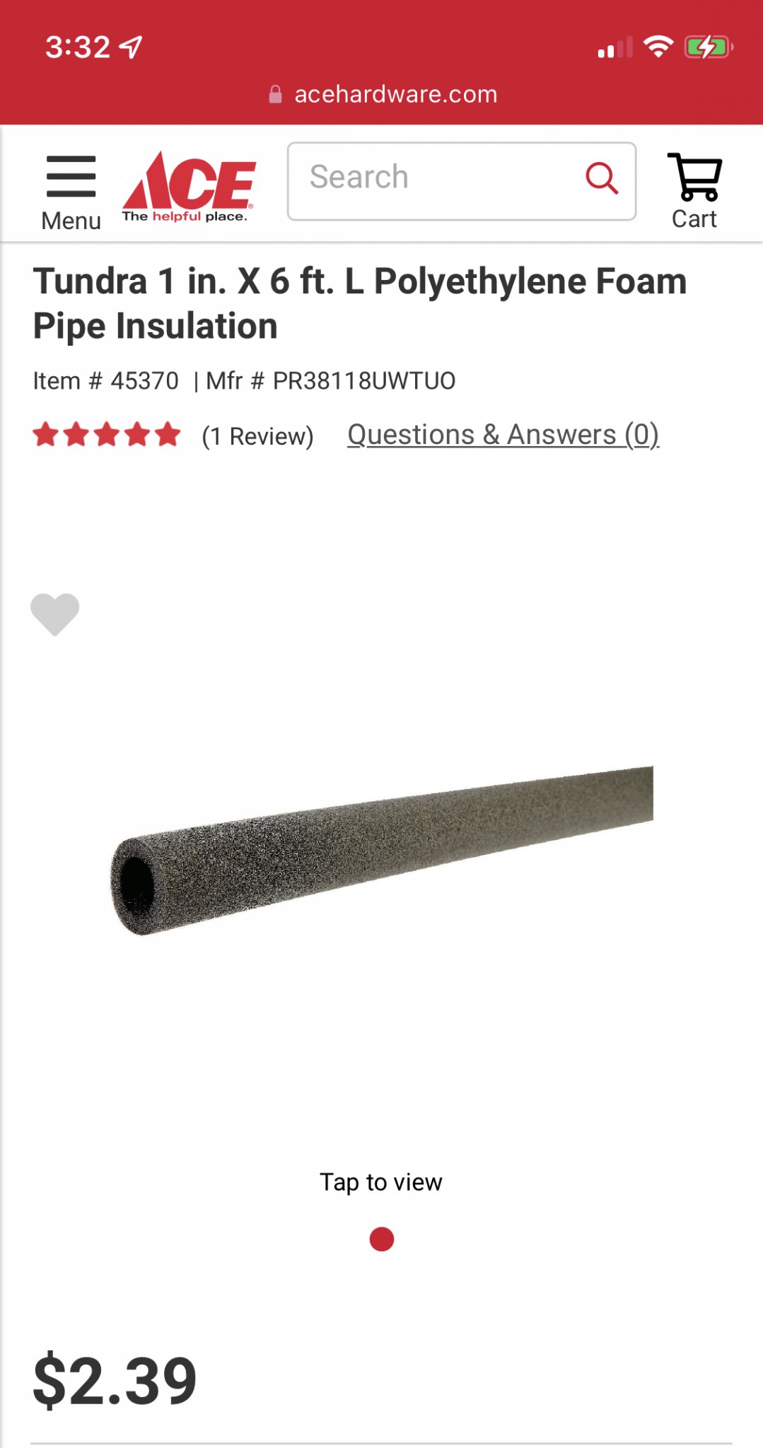

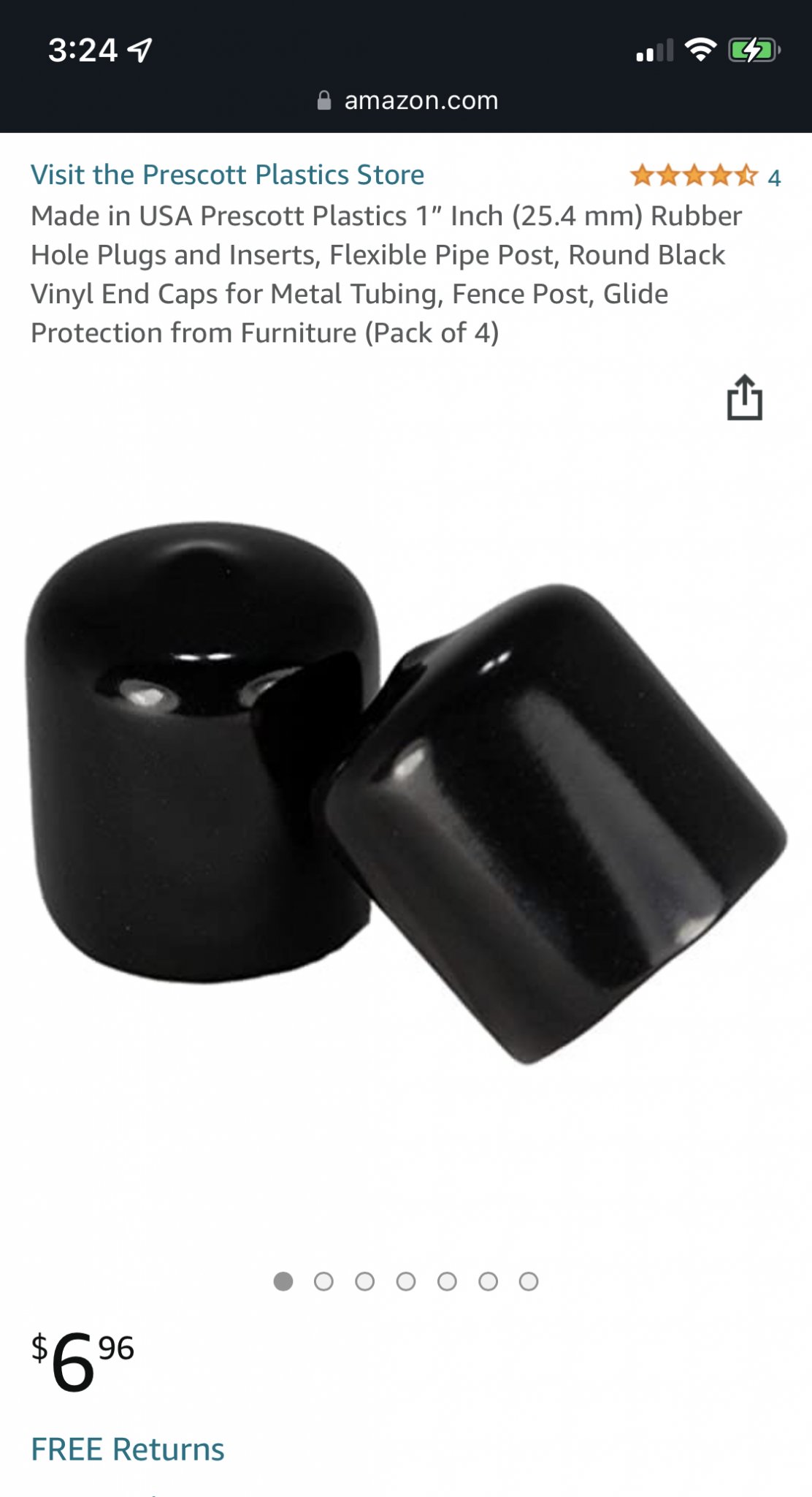

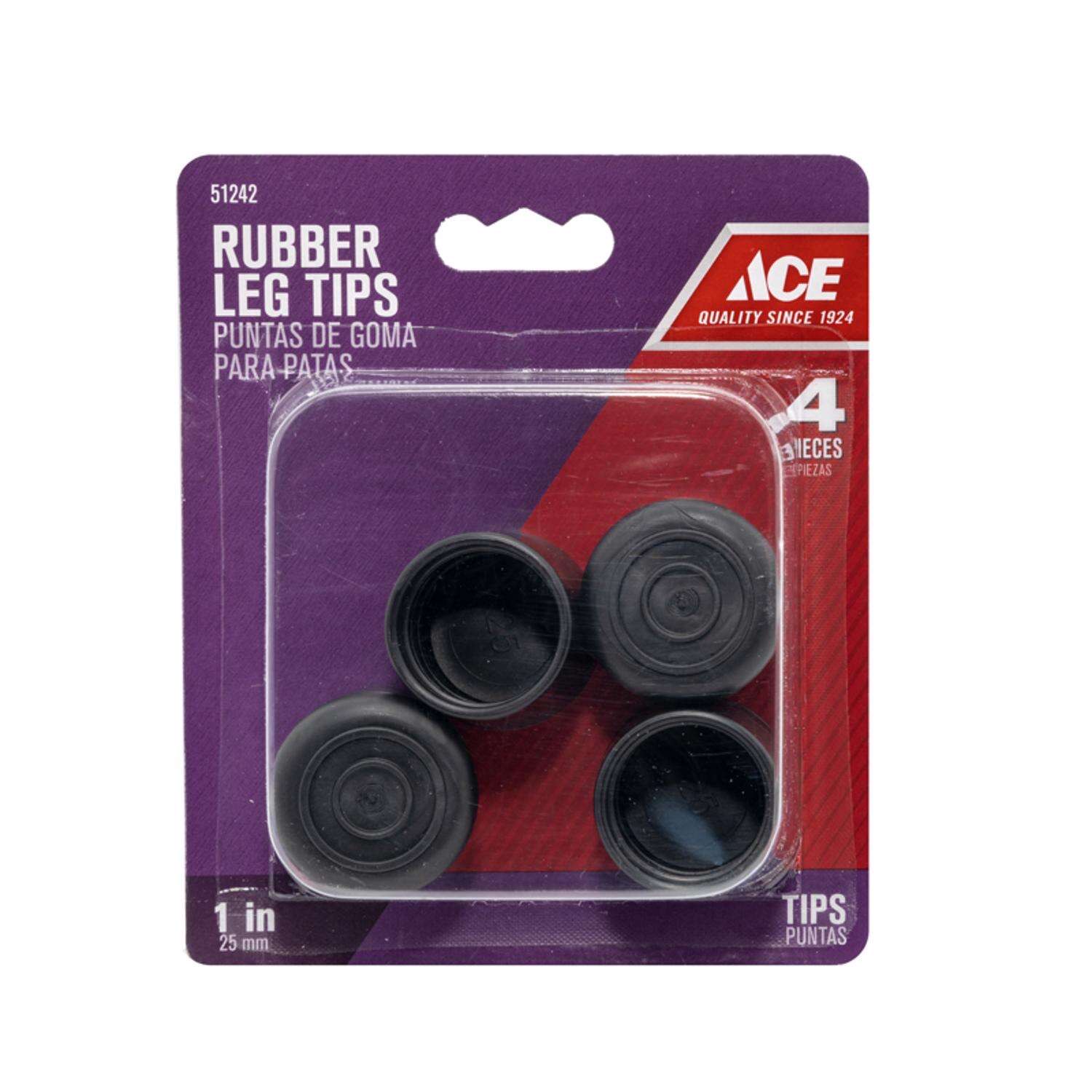

You only really need to protect the ends. Here’s your answer. Either will work great and only come off when you want them to come off.
Had a barrel shipped with the top ones.
Tore through and buggered the muzzle threads to where nothing would thread on.
That is what has made me think of something more protective.
Threads were easy fixed in a vice with a quality thread file, as only a small part was buggered.
Prolly wont get bounced around near as bad by me as the goobers at UPS or USPS. 🤣
True. I can tell you that the cane tips are very rugged and would have to be beaten pretty hard to fail.
Oh, and to protect the barrels:
I know that none of that is task specific, just offering up the low budget options.
