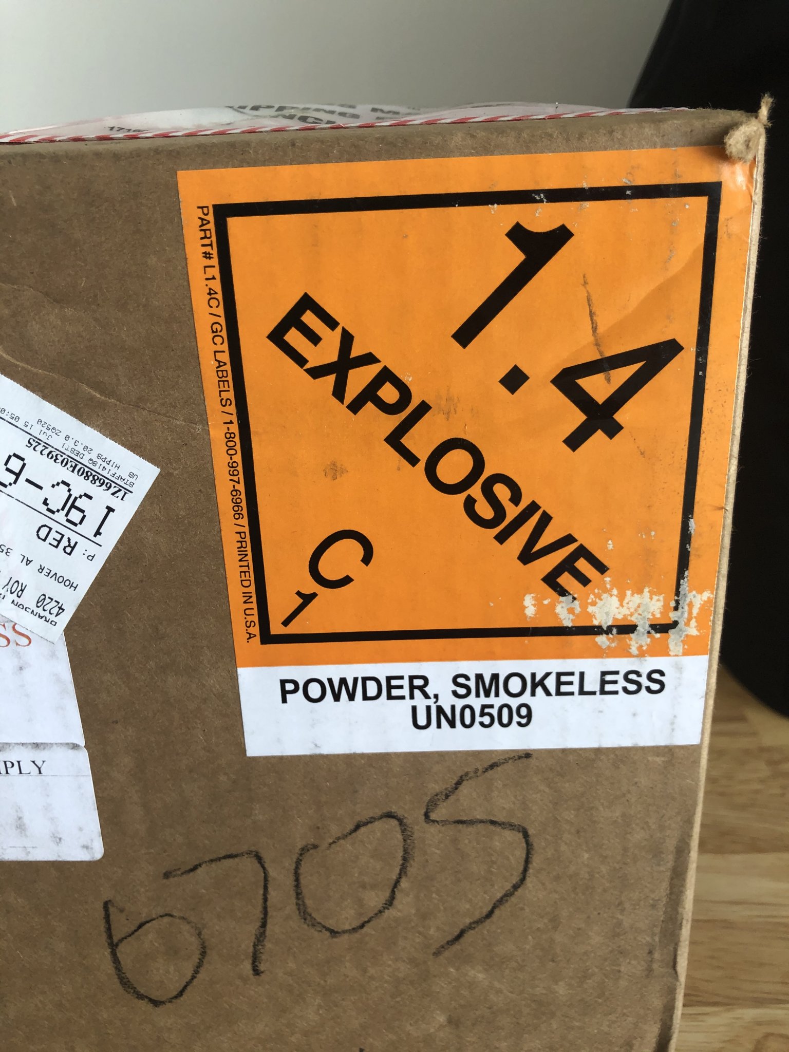

Is anybody else getting "Explosive" stickers on their smokeless powder deliveries?
sandwarrior
Apr 21, 2007
6,611
2,220
in yooperland
I just opened my last delivery of an 8# jug of powder and noticed it had the "Explosive" hazmat sticker on it. If this is now classified as "Explosive" and not "Flammable Solid" (highly flammable) this may be why powder is going through the roof.
A few years ago during the Obama Administration, we (all across this nation) got this issue quelled. We thought. If this came up again, it was not done LEGALLY! There was no public announcement or input as to changes (The Obama Administration also tried to dodge this). Any change to policy and procedure of the Federal Regulations must be put out and given a time period for public observation and input.
FWIW, this classification really kicks us in the nuts, because as competition shooters, we are no longer allowed to store unlimited amounts of smokeless powder if this has been reclassified,
I do know that all of the hazmat classifications were updated to a new standard a year or so ago, with companies given a grace period to confirm. If I recall correctly, it had to do with standardizing classifications globally. Imagine that, a workaround method to accomplish the same thing. <sarcasm>

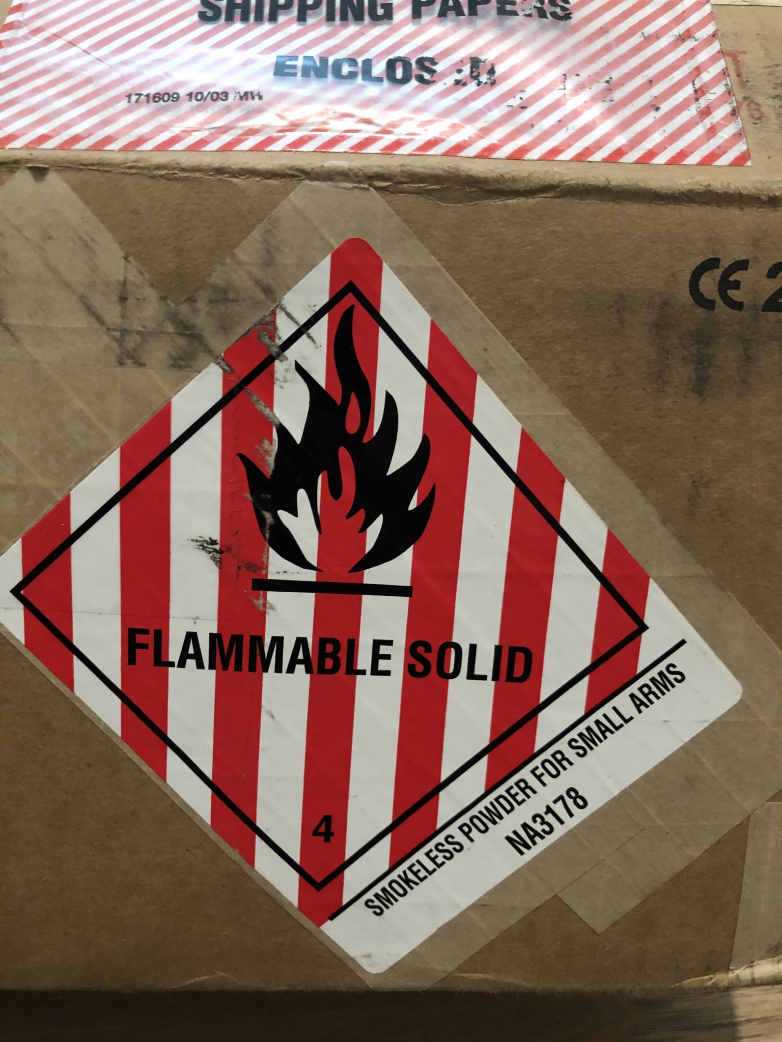

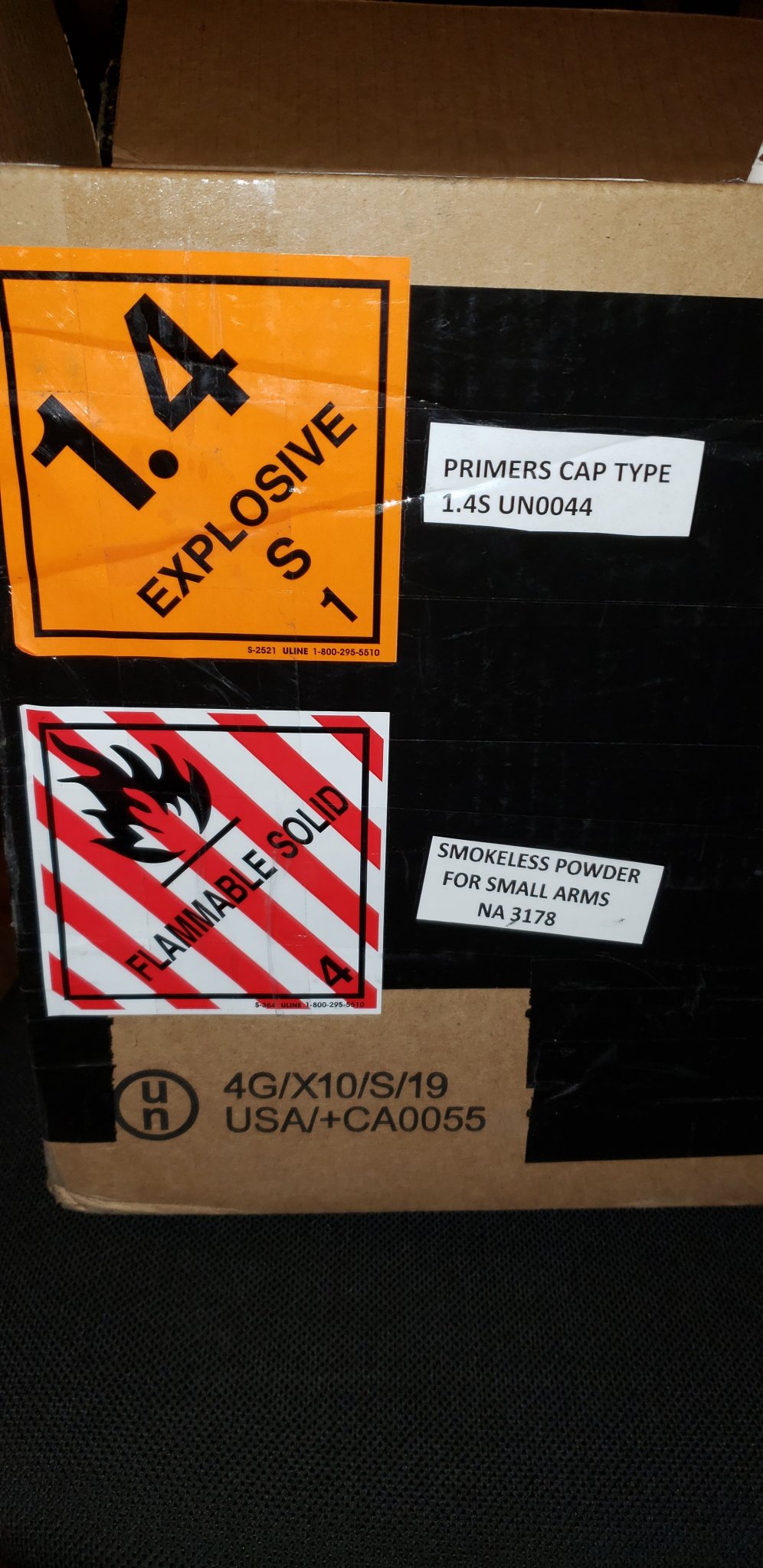

Just got this box from Bruno's with primers and powder in it. Maybe they haven't got the message n the new stickers.
View attachment 7371001View attachment 7371001
Packaging like this reminds me of shipping hazard class items in the MIL.
We always packaged items with the most labelling. It was a consistent process. We never labelled it less, because it wasn't going anywhere. This meant that no matter how we sent something out it was labelled properly.
As for the primers above, lookup un0044. Although it is a 1.4 item, labelling isn't required, but you can always add it... I haven't dove into the new standards in cfr 49 but, unless you do it everyday you wouldn't know everything... Even then very few people, even in the mil, do it properly all the time.
Secondly, I was reading cfr 49 172.102 and I came across this excerpt for item 50.
"50 Cases, cartridge, empty with primer which are made of metallic or plastic casings and meeting the classification criteria of Division 1.4 are not regulated for domestic transportation."
So if things get hairy just sell cases with primers installed, as long as it domestic you can ship them with less stringent measures.
Reactions: sandwarrior
Regarding the powder above, the shipper would have to verify with the manufacturer on how their powder is classified. NA3178 still exists in cfr 49 172.101. UN0509 has different standards. The manufacturer would have to have their item tested by an "Approving Authority" to verify what standard it fit. This would also go along with the packaging instructions.
Different modes of travel require different rules on how its packaged, labelled, etc. Something that was sent out for a truck shipment could be labelled/packaged differently than something that would go through air. This also includes items that would go overseas,rail etc.
Just for your sake of curiosity the marking in the bottom left of the box are POP markings. These describe the standard to which the box was made.
4=Box G= fiberboard (cardboard box)/X10= Gross mass in KG the box is rated for/S= Solid inner packaging/19= Year box was cheated for shipping/USA= country box was created for shipment/+CA0055 is the Certification mark or Manufacturers ID.
As for the special provision for cartridge cases i mentioned above the un# associated with them would be un0055, and un0379 (14.2/1.4c, respectively).

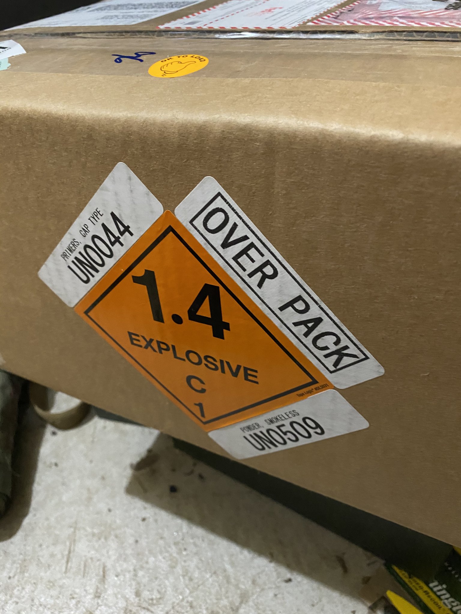

Just looked at some previous shipping boxes and one order came in a factory Hodgdon box that had the 1.4C placard "printed" on the cardboard... Wonder how long this has been a thing?
