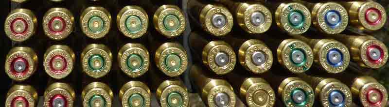

I usually take a good pic of the primer side sitting in a 50 or 100 round box to identify a load that might be iffy.
Used to keep them separated 1, 2, 3, and 4th fired, now it's new cases (to make once fired) and few and many fired.
Had a 100 round box mix up 10 round loads on the trip home once.
Now I ring the primer with a colored sharpie for each load.
