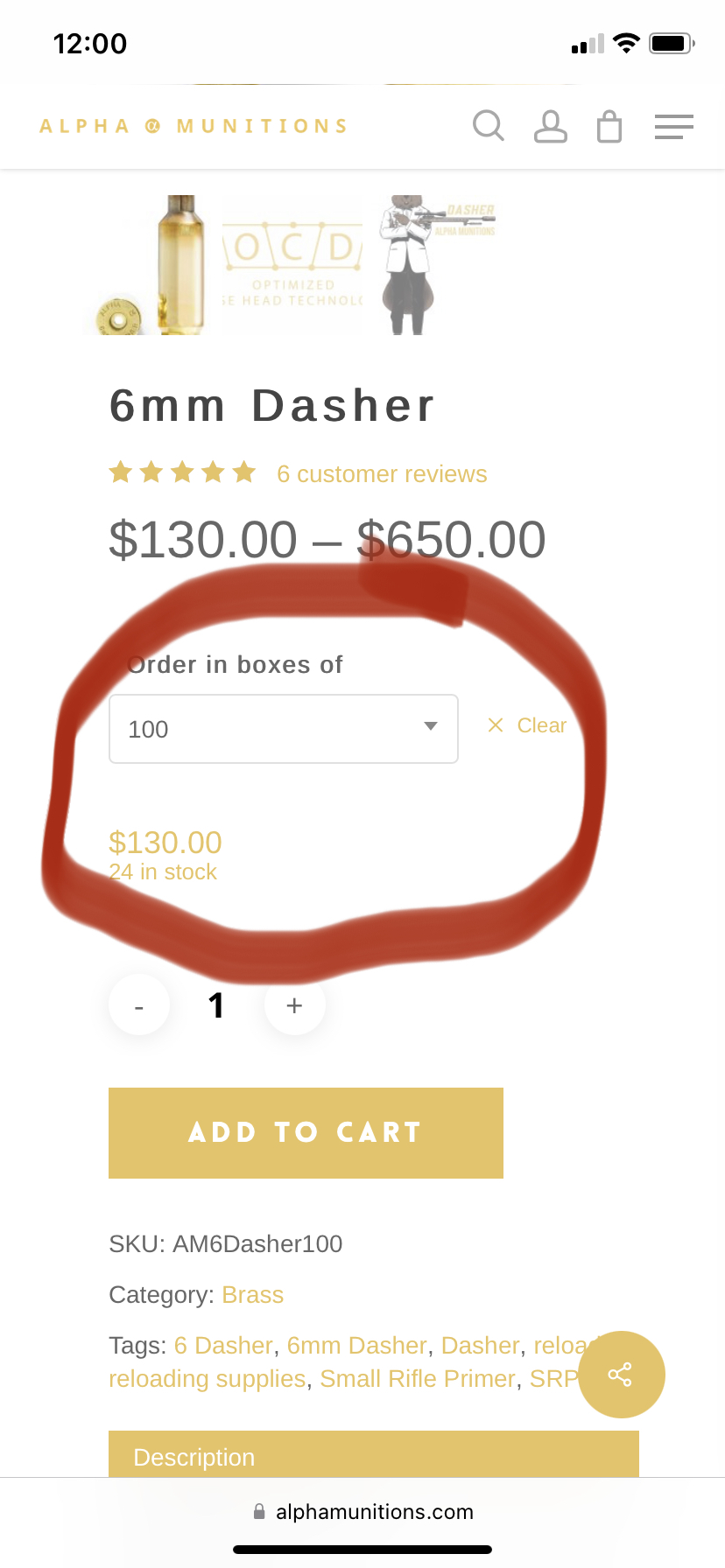

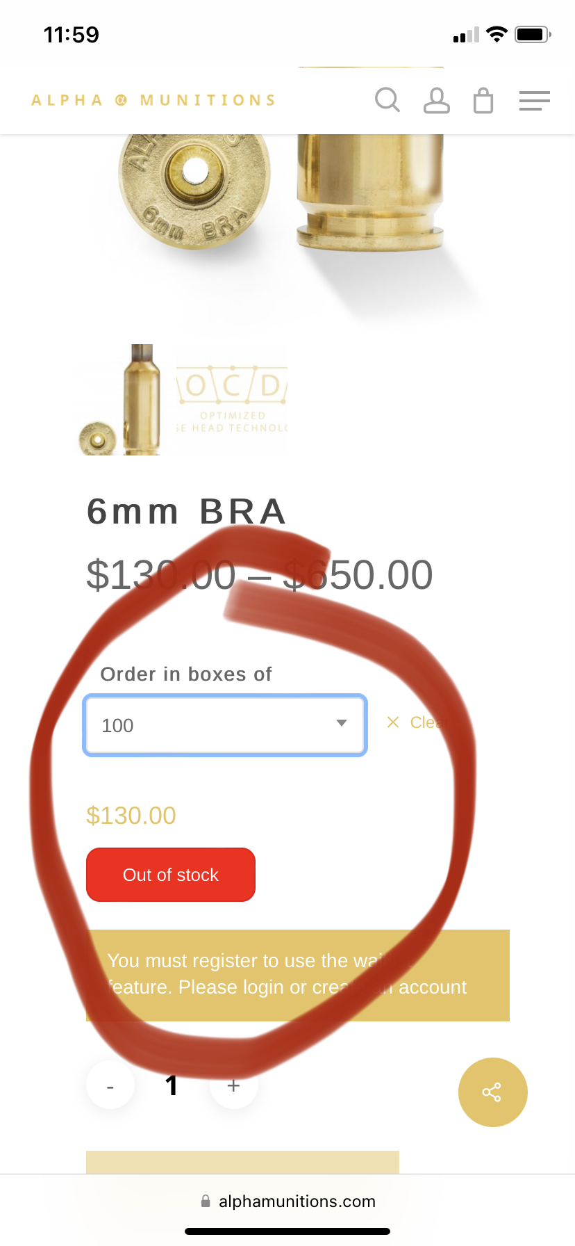

@hookedonbrass, that is cool for BRA guys. I haven’t been looking long but haven’t seen the 6BRA in stock yet. Good there’s that option now though.

Not being snarky, I’m curious why 6 BRA seems on the rise vs 6Dasher? BRA is probably easier to fireform?
That’s it. Easier complete forming with bra over the dasher. Well a longer neck too but you’ll be hard pressed to find that dimensions effect once you set the calipers down.
But with both having factory headstamped cases available now that’s not really a big variable anymore.
