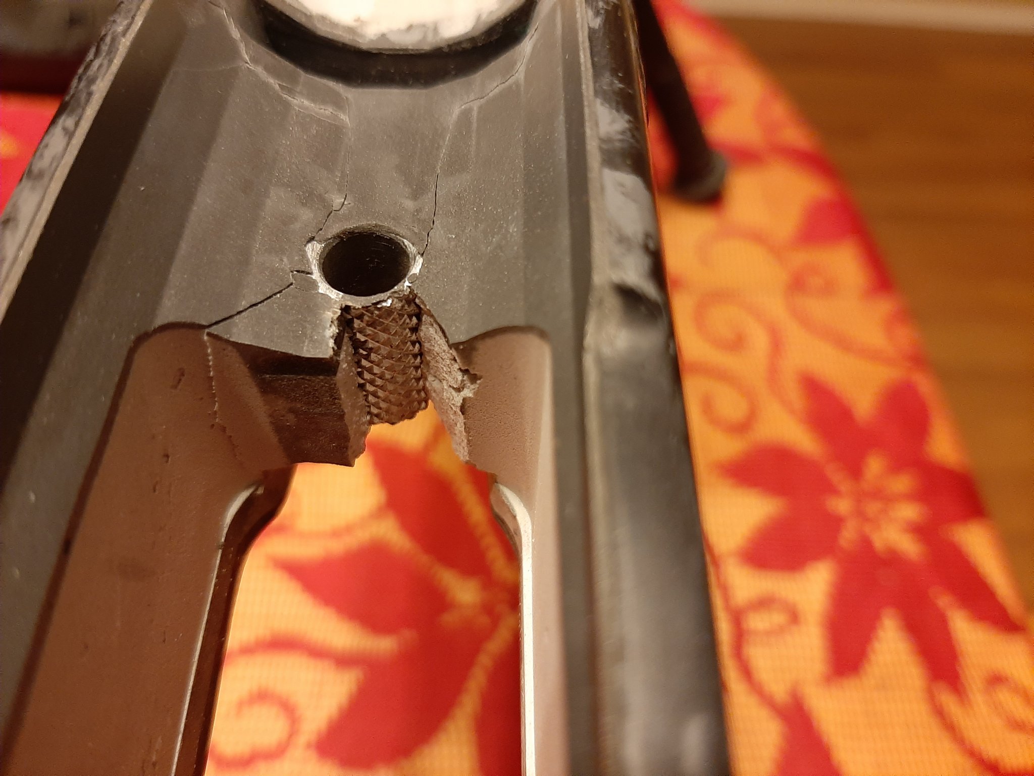

    Noticed that accuracy was getting erratic and started troubleshooting. Action screws had come loose and found this . Is it repairable or not worth the effort? I'm not wild about this stock in the 1st place anyhow and I'm considering starting over with something I know I like.

    I have fixed far, far worse. Short of running a composite stock through a tree chipper or a furnace, you really can't ruin it. All you do is create more work for yourself.
    If your stuck and don't want to throw it away, send it to us along with the barreled action. It'll be like it never happened I promise.

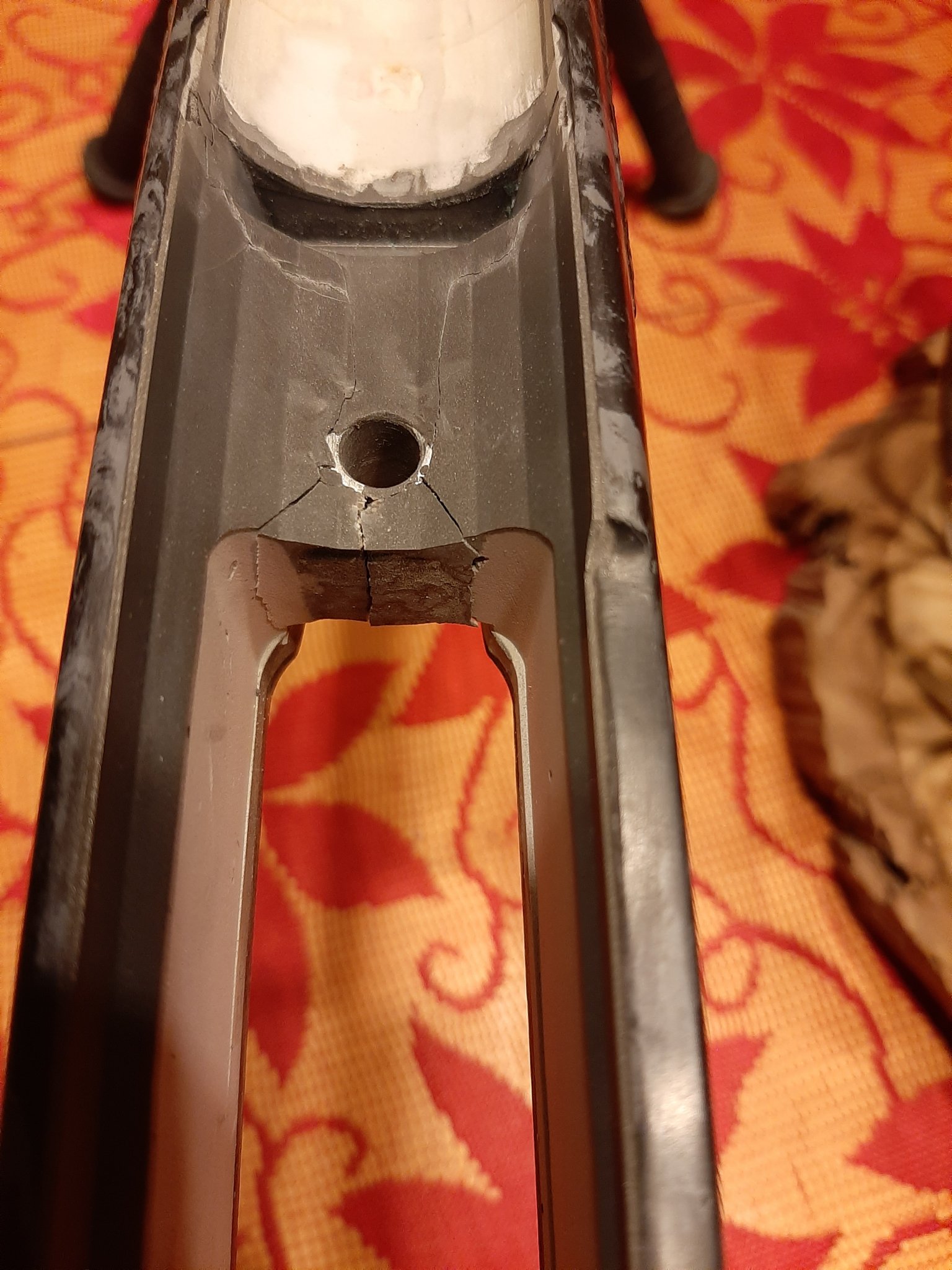

    odd place to break. Almost as if the action screw was acting as a recoil lug inside the pillar.
    That was my first thought but then I saw that the recoil lug pocket is all cracked up too, I think it was all just more than the material was designed to handle and it is all giving out. Wonder if the previous owner noticed it and dumped it off on you Weiser?
    The recoil stresses appear to have started a crack at the rear face of the recoil lug bedding. As soon as that gave, the recoil forces were transmitted to the pillar, which likely gave out immediately.
    As has been stated by the forums fine gunsmiths, the shell and filler materials were insufficient to handle the recoil forces.
    It can be repaired if you want, but since your already not happy with the stock, replace it with something made with your level of recoil in mind.
    Looking at it closer the entire surface for the lug face is broken up. Wonder if there was an air pocket in that area of the bedding and it just collapsed and caused a domino effect.
    Just curious, were you able to confirm what fill the stock had? I know a couple folks posted that it looked like Mcmillan's Edge fill from the pics.
    If so, is that likely the culprit behind it cracking? Or possibly an air bubble in that area? 300 Norma has pretty stout recoil, but I am kind of surprised that it did that. Looks like it isn't the first time it's happened either, from what others are saying.
    I'm also wondering if the recoil lug support area giving way was the cause of the loose action screws. Which in turn led to the pillar taking the recoil impulse and giving way?
    Who knows, we'll see what Mcmillan has to say about it. If it's edge fill and they won't warranty it I wouldn't blame them. I think the edge fill is rated to 300 WM only. If they ask what cartridge I was shooting I'm not gonna lie just to try and get it fixed for free .
