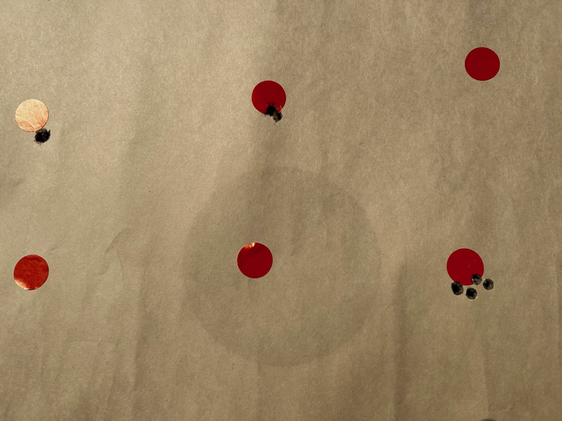

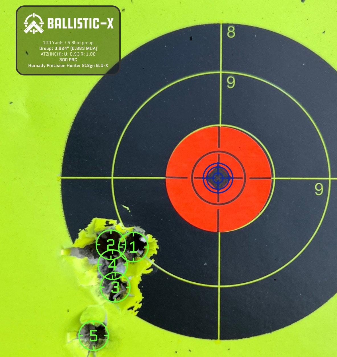

Is it me? Or my rifle?
Scrotty Dog
Sep 17, 2023
7
4
Indiana

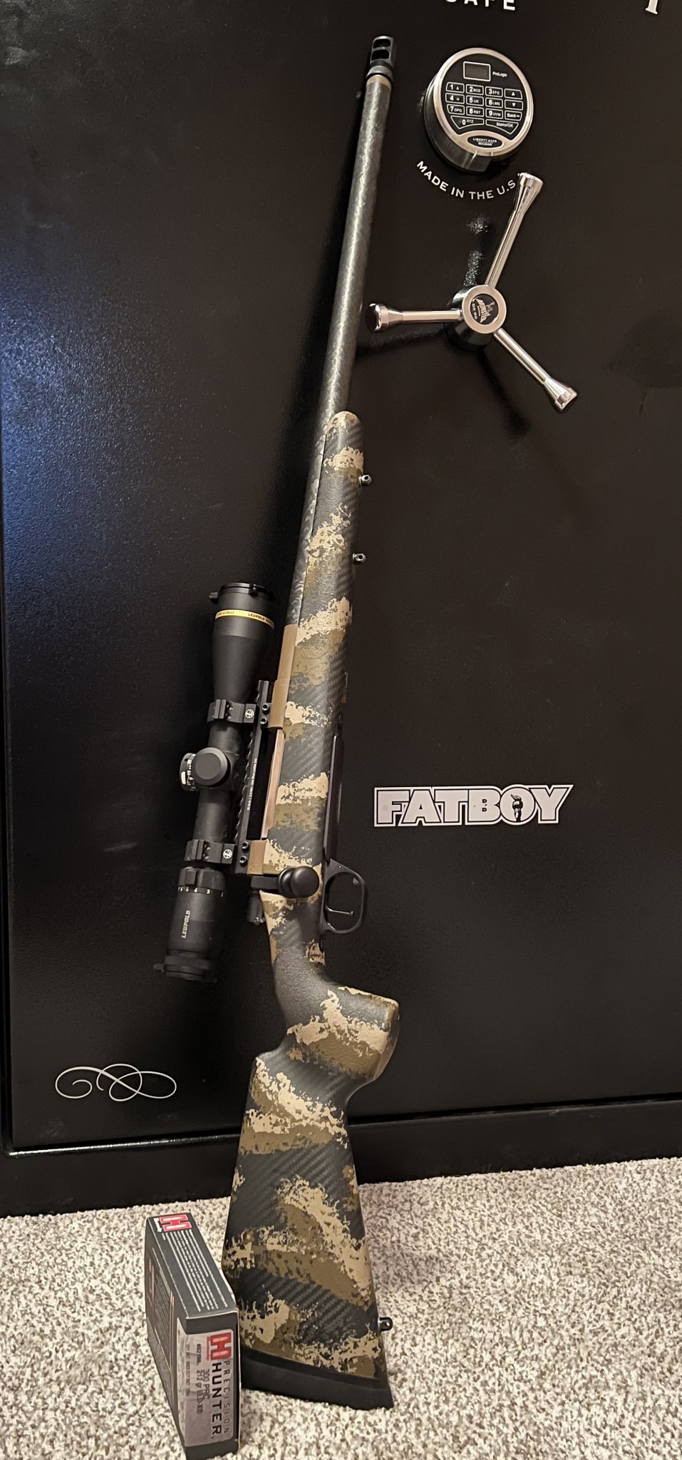

I had a custom build by a local shop when I lived in Alaska. It’s a 300 PRC with an American Rifle Company Mausingfield action, Mesa stock and Proof Research 22” sendero barrel. I moved out of state shortly after getting the rifle and am just getting to break it in.
I’m struggling to get accuracy better than 1 MOA, despite using a couple different powders (IMR 7828ssc and H-1000) at different charges, trying a broad range of seating depth. I broke down and ordered some Hornady Precision ammo today out of curiosity.
Should I start to question the gunsmithing at this point, or should I continue exploring more loads? Is it reasonable to expect better from a custom hunting rifle?
I would consider myself to be a fairly proficient shooter, and compete regularly at the national level for the Army, just for reference.
Thanks for any advice you can offer!

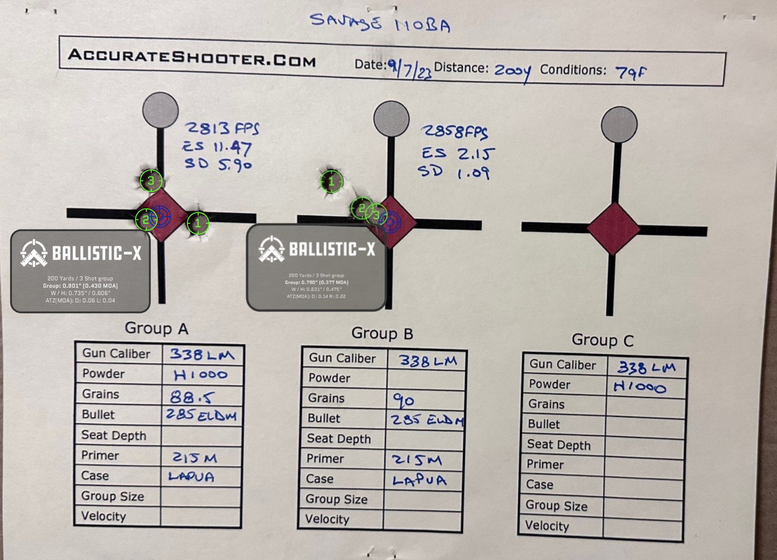

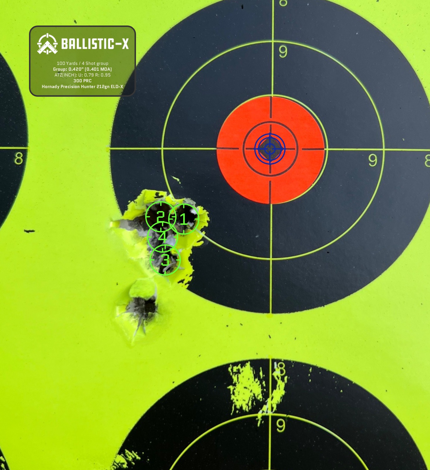

What bullets have you tried?
Was the chamber cut for a specific bullet type?
I have a 1-10” twist 6mm BR that doesn’t like Sierra but loves 75gr Hornady V-Max.
Just leaving the range with some success.

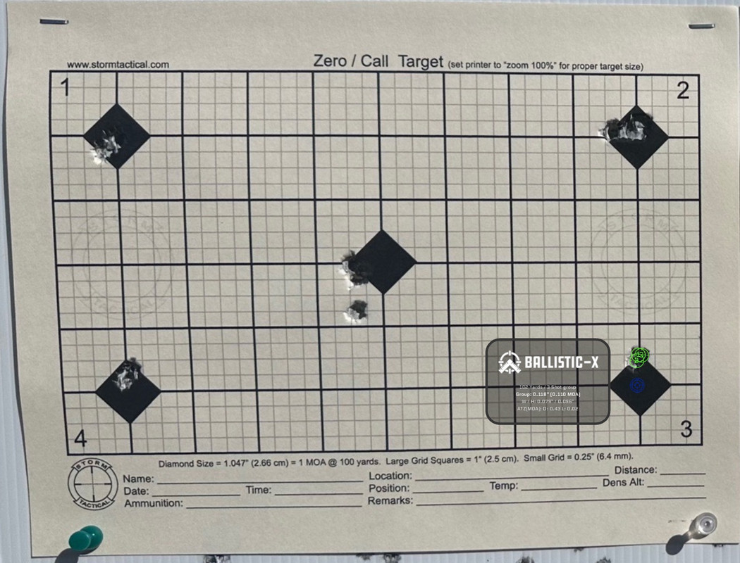

What bullets and what did you do for seating depth?
What powder charge?
What velocity?

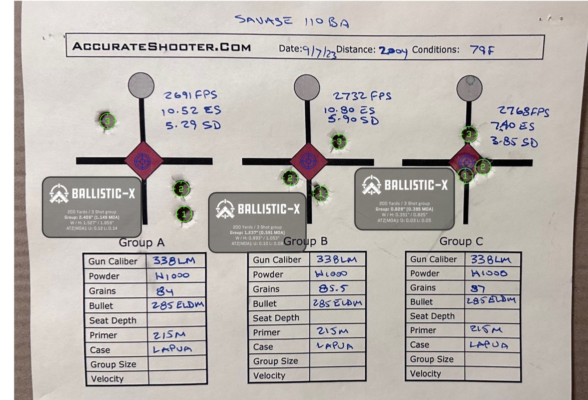

With my 300 PRC I recently had to switch from Berger 230 hybrids to 230 OTM hybrids so needed to redo seating depth. Below is the difference between .015" off (right side, lower) and two groups of three at .018" (upper center and left).
.003" is the difference between a crappy shooting 1 moa rifle and bug holes.
Reactions: FisherT&C
Definitely need to try more then one bullet before you go after the gunsmith. I know you say that you are a national level shooter, but unsure what in. If your not experienced in heavy recoiling rifles I'd get a friend to help.
But I agree tear it down and retorque everything first.

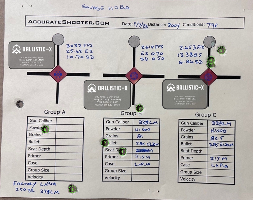

Thank you all for the input. I definitely will run it through some different bullet types and weights.
My competition experience is with gas guns/service rifles. I certainly didn’t mean to misrepresent myself as a seasoned competitor with bolt action, and I can see how it might come off that way.
I have much to learn about reloading and fine tuning, and I greatly appreciate the wisdom and suggestions.
What loads you shooting? Grain weight bullets?
300WM case stretch can be up to 20 thou from virgin factory brass. I don't get too concerned until I can get the case shoulder bumped .002 from max stretch. Getting Peterson Long brass can help with this.

Here is what a Lapua factory 250gr .338LM group looks like from my Savage 110BA.
That group is representative of what that ammo shoots in my gun next to my ladder of Hornady 285 ELD-M I loaded to magazine length.
Based on the performance of Lapua 250gr factory ammo my rifle is junk.
Based on my preliminary ladder test I have 4 groups under 0.5moa and 3 groups under 0.4moa.

I’m sure I’m not the best at handling this thing, but it’s shooting well. I had a five shot group with a flyer turn out to be .88, could’ve been .40 without the first shot, and a second group of four at .66. I’ma call it a 1/2 MOA gun, roast me if I deserve it😂
  • Ballistic-X-Export-2023-09-20 19:57:52.085613.jpg
  • Ballistic-X-Export-2023-09-20 19:57:30.586496.jpg
  • Ballistic-X-Export-2023-09-20 19:55:40.984365.jpg
Reactions: Modoc and Baron23
Yeah that's definitely a huge POS. You need to dispose of it before it costs you more resources. I am willing to help dispose of it safely, just send it to me.
JK. Looks like its shooting fine for being a light rifle in a heavy recoiling caliber. Most of us usually do 3 shot groups on a magnum and more so with a lightweight barrel.
