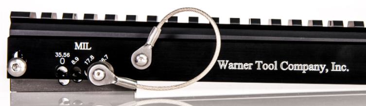

Have had some interest from prospective buyers about making our ELR adj. Scope base in millrad.
I'm good with that but my research has shown a deviation of military / true values. So, what are the makers using? ( THE MILITARY ROUNDED OFF)

If you want your "mil" to be the angle subtended by one unit as seen from 1,000 units away, it had better be a true milliradian; i.e., 1/(1000*2*pi) of a circle. There are 6283.185308... milliradians per full revolution.

You would be correct if it were a base in which the amount of tilt is fixed. But it isn't.

I’d rather it be an integer number of mrad, instead of moa-equivalent, which is I think what they’re doing.
A significant portion of Warner Tool's client base wants stuff in MOA and by having the base marked in MOA on one side and its mil equivalent on the other he doesn't have to manufacture and stock two SKUs.
The only change I would make would be to round the 35.56 mils to one decimal place as that matches the finest adjustment increment in pretty much every scope out there.

That's the objective. Trying to make it usable by a few select Marines. OOOPS, I said that out loud! Crayons sold separately.
Alan
Spot on. Making it in mil will most likely yield increments of 0, 10, 20, 30, and 40. Making the front and rear blocks are time consuming and we never know what action is next till we get an order. Hardened and ground A-2 with locations all within .0005 true position. Usually better than that.
5 positions and four different sine bar lengths. Running clearances are .00015 to .0002.
