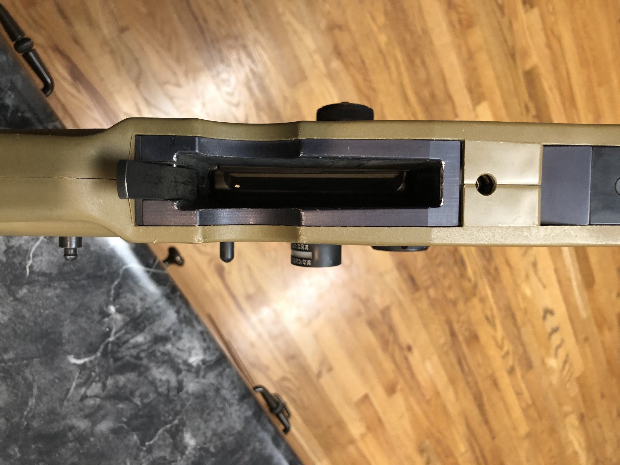

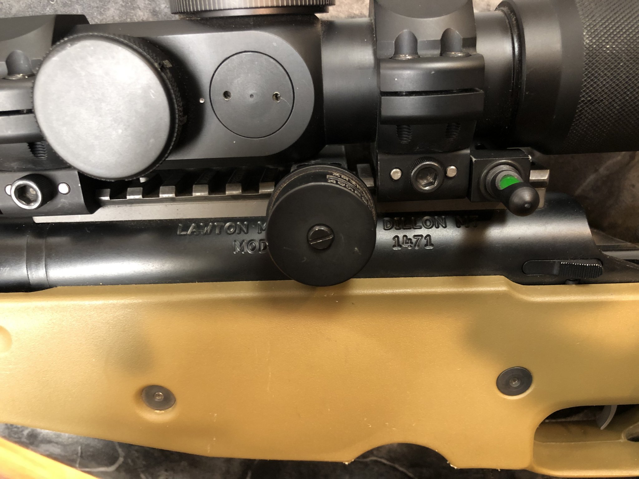

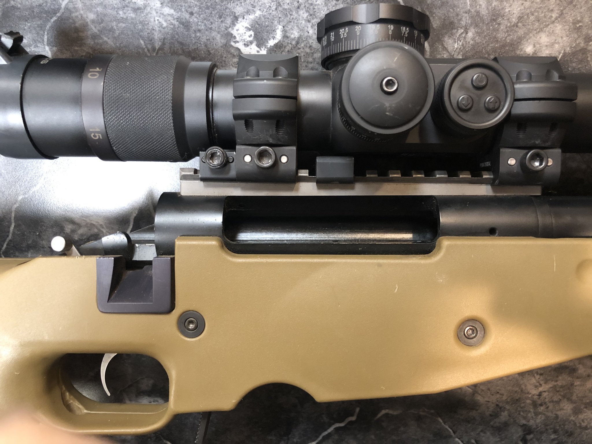

Hi guys, need some advice please; the barrel on this 300WM will be burned out in about a year at the rate I shoot it and I'd like to move up to 338 (any magnum) to be able to reach out a little further than the 300 is capable of. Is it possible to convert this to 338 lapua or some other 338 magnum? Obviously I don't know the first thing about how this works which is why I'm asking here. It's a Lawton 7000 action and I know Lawton is out of business. What all would be involved and what kind of costs am I looking at? Like to salvage as much of this setup as possible when it's time to rebarrel. Thanks.

Don't think it is impossible, they did offer a .338 Lapua and many of the parts such as the bolt are Rem 700 compatible. The shot of the bottom metal and magazine well may be your sticking point though.

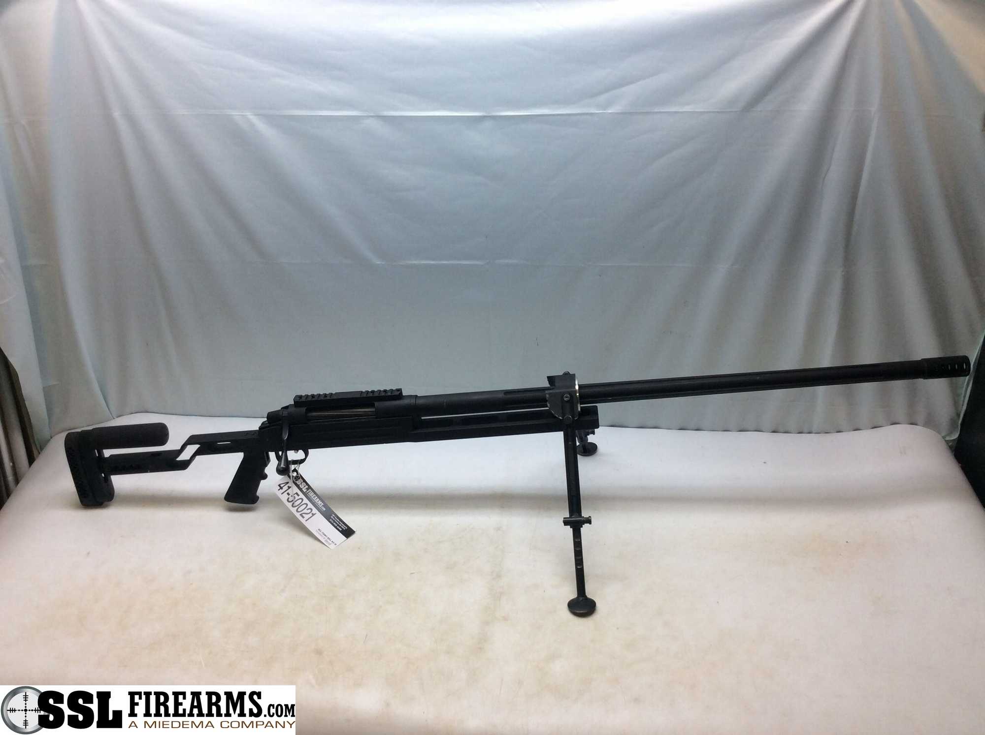

On another note, thinking of 375cheytac; something simple and more wallet friendly like this old single shot 375CT might make me part with my money....
