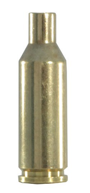

Well, besides from the the 224 Valkyrie, the 22PPC is the only one of the ones you mention that is available for reloading here, I can not find any brass for the others. The 224 Valkyrie seems like a "mini 6.5 creedmoor" to me, I am mostly interested in that one. 22 PPC is more "Short-Fat" so I wonder how it will feed from a magazine, can it get more easily jammed than the 224 Valkyrie?
22 PPC
View attachment 7359254 View attachment 7359256
22 PPC
If you start with the Howa mini action, I can't think of a reason why you would go through the effort to change the bolt face to go .224 Valkyrie unless it was to get factory ammo. Get a 6.5 Grendel mini action and handload for the 22 grendel or 22PPC. It is better than the .224 Valkyrie.

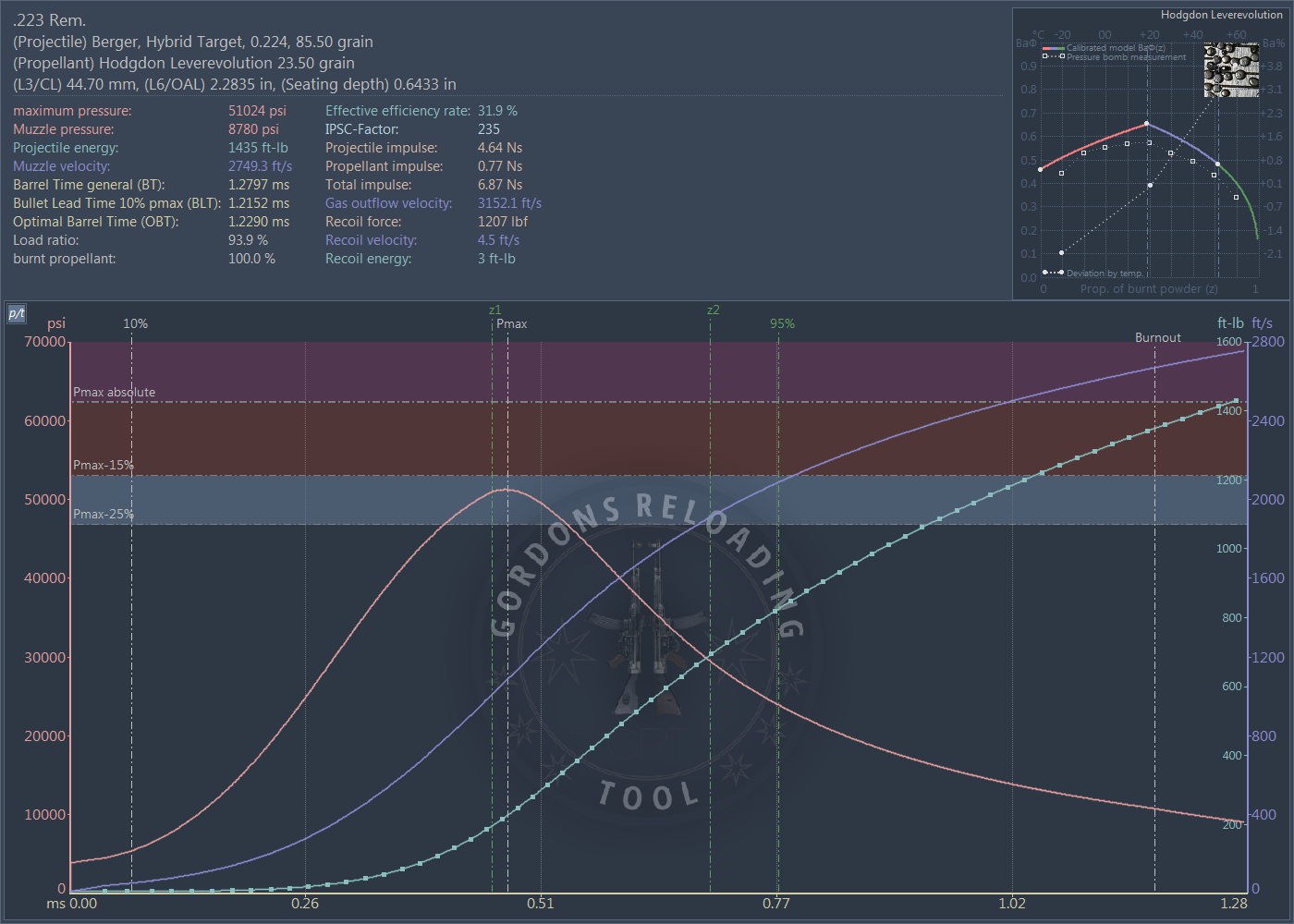

Well, the 223REM does not offer any easy way of loading 80-90 grains bullets, it takes either a rework of the chamber throat to be able to set long bullets far enough out to be able to fill the case with enough powder. Case capacity is less, so I will not have the velocity I can achieve with the 224 V.
Simulation of 223 REM and Hodgdon Leverevolution powder with Berger 85.5 grains bullet in GRT, with C.O.L = 2.2835" in a 24" barrel:
Notice bullet seating depth (0.6433")

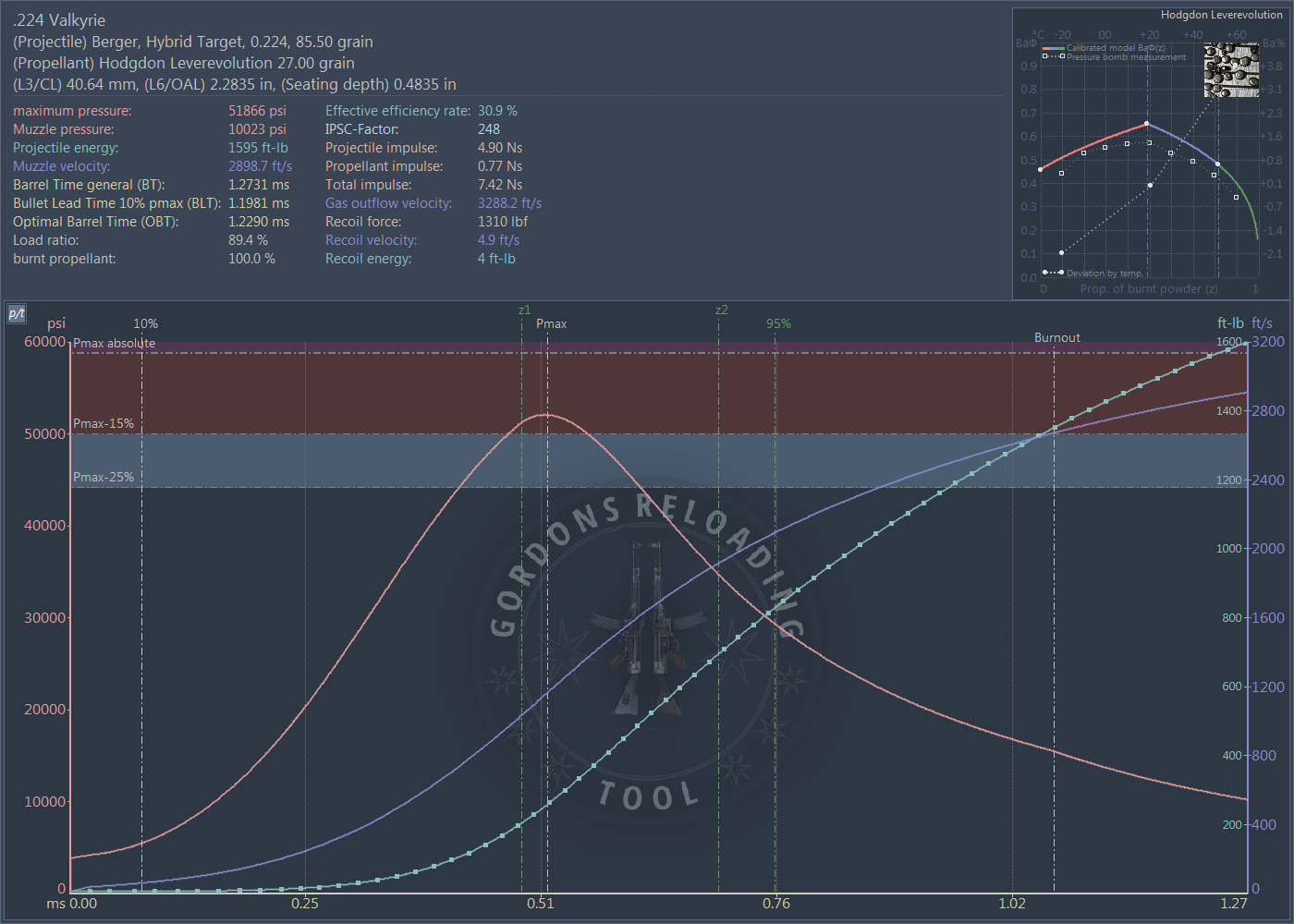

Same simulation with 224 Valkyrie, same bullet, same C.O.L, but more powder:
Seating depth is 0.4835"
Pressure is about the same.
Velocity is superior in the 224 Valkyrie.
22. Nosler might be a good choise, yes. Not sure if that cartridge will last though.....
Only Norma makes brass for the 22 PPC, if they discontinue that case the rifle have to be rebuilt to another cartridge. I am not willing to bet on 22 PPC.
