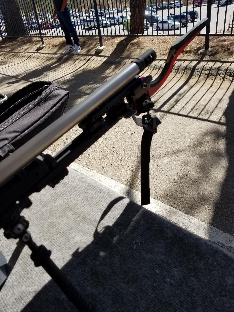

Best thing to do is to figure out a way to install the MS on the chassis or the stock instead of the barrel. That way you can shoot for groups, develop load, shoot at anything/anywhere without worrying about POI shifts. Something homemade like this that I'm using or you can buy a mount from the various companies that make them. I do realize that this may not work with every setup though
@LA260
won't matter.. mounting it to the rail or stock.. the bullet passing over the bayonet will throw it .. it seems for almost everyone it throws away from the bayonet .. mount it at 6oclock the group goes up several inches.. turn it over mount it on the top ... group goes low same 3" ... mount it at 3oclock .. group goes left.. etc...
