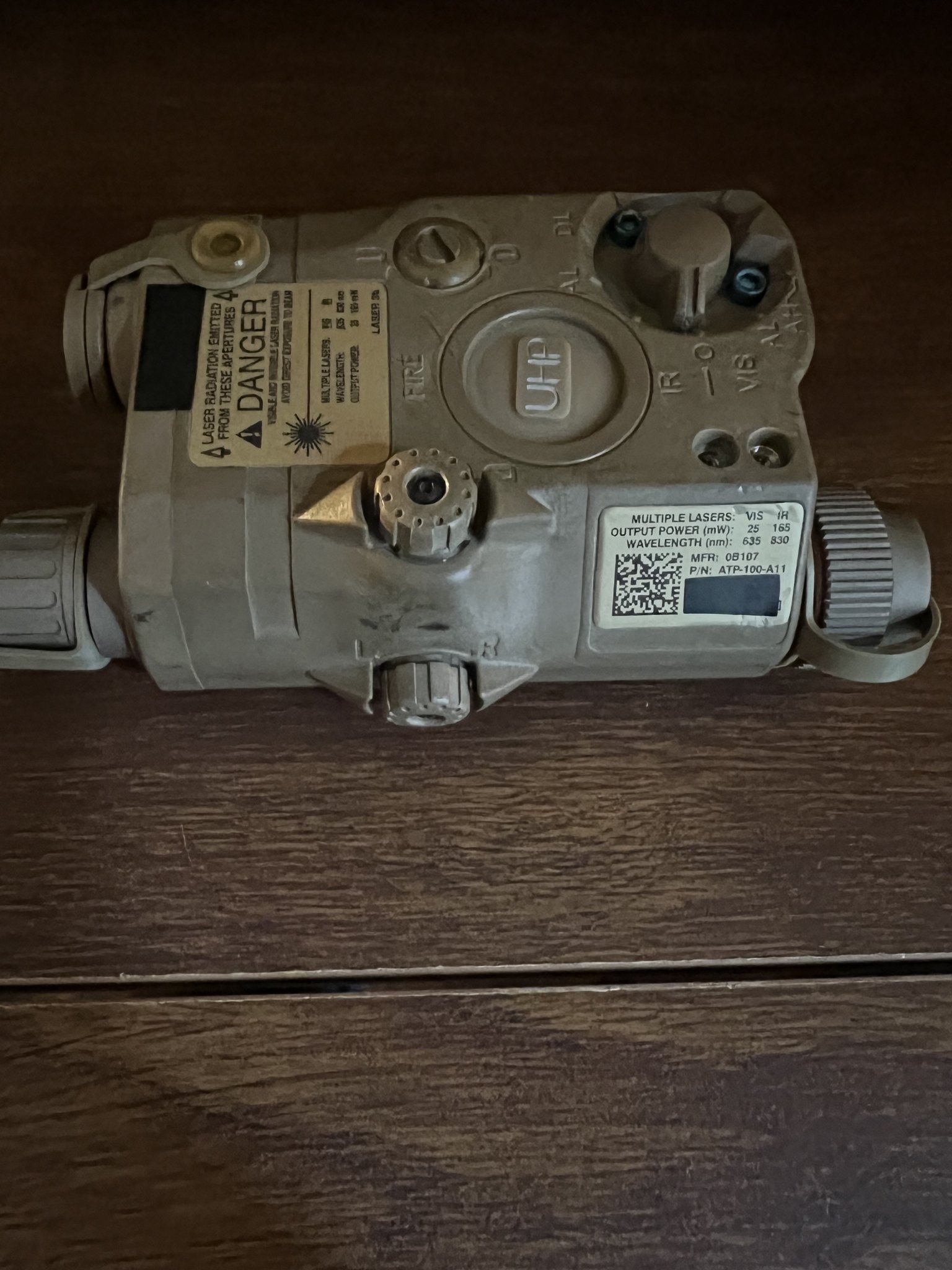

So...being specific do you have a LA5-B or a LA5-C
the C was/is the UHP version. The B is a great unit and in my opinion not overpowered - all relevant to the NV unit your using - and has Hi and Lo output options
If you have a C unit, it will wash out / bloom alot inside of 600 - 800m again NV unit - BUT - will illum vastly further than a ATPIAL 15 / PEQ 15 (The civilian C version I'd pass on) and the best compromise within 800m is a true LA5-B
As always YMMV and all is subjective
You can always keep the diffuser over the laser emitters to tone down the intensity of it as well as the illuminator to flood the illumination a lot more so its not so intense. I would venture to say that at the ranges you would take a shot on a hog at under NV that the regular FP peq15 would be more than adequate for you. I have never needed a powerful laser but more illumination power is always fine by me…. I run a FP peq15 on a 300blk sbr and a ngal a1 on a 14.5” 5.56. Both are more than adequate and if I had sell my ngal for whatever reason, I would not feel underpowered with the FP peq15.

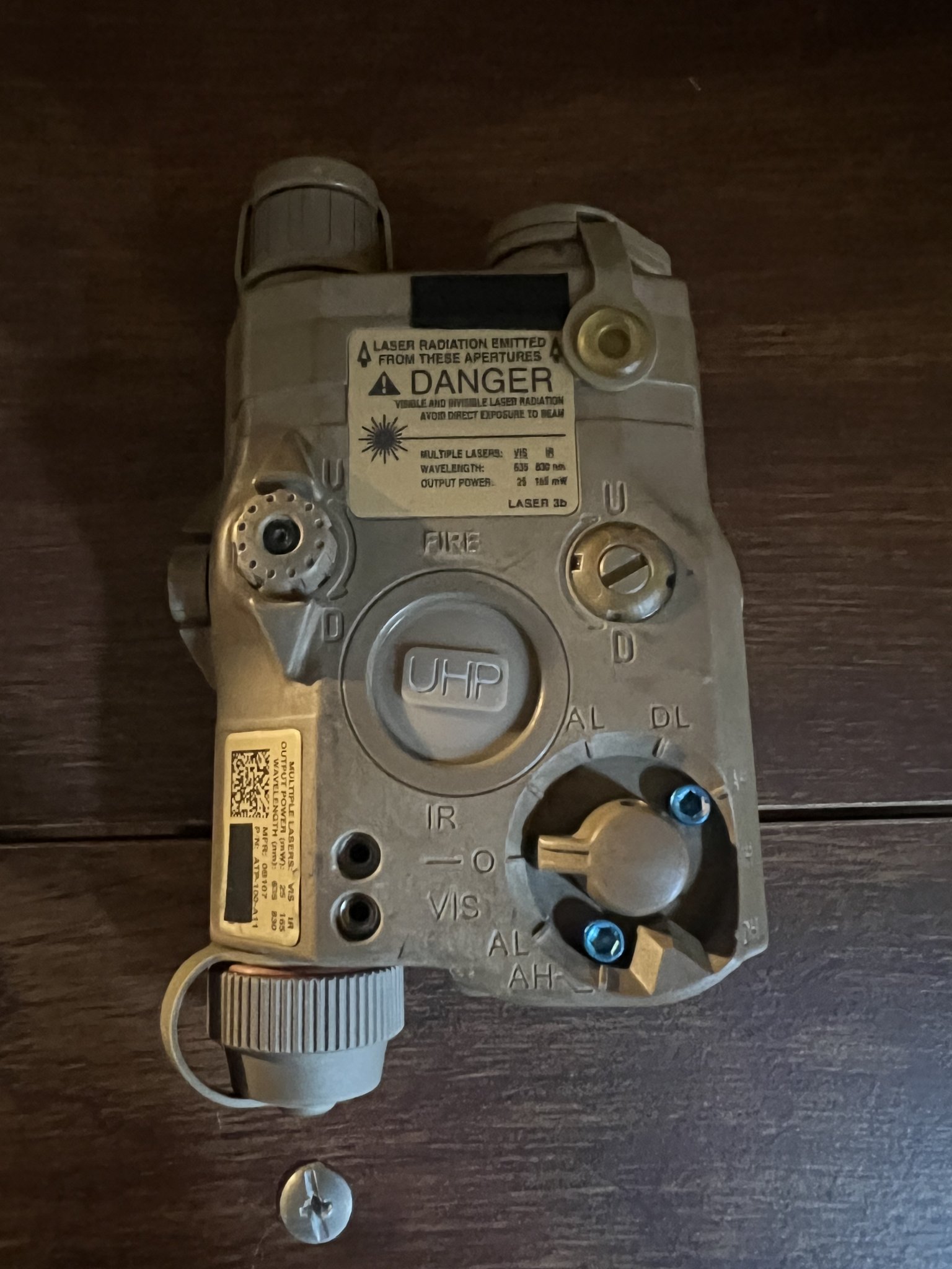

I’m pretty sure this is the C model.
Reactions: tk427
I’ve killed a LOT of pigs with NVGs over the years. Your question totally depends on setup. If using a clip on device shooting 300+ then absolutely not. If doing what I do, getting in close (30-50m), and engaging sounder as they run off out to 300m or so, then absolute yes. I run a DBAL D2 that works great by myself or with a couple buddies. More than that, and anyone outside the cone of illuminated throw is gonna get washed out and unable to shoot. High power laser when hits pig hair will “bloom” and your precise aiming point/dot turns into a basketball on their neck. TNVC TOR mini works way better in that setting.
If you haven’t actually hunted pigs in your environment, I would start with cheapest option and upgrade slowly from there.
