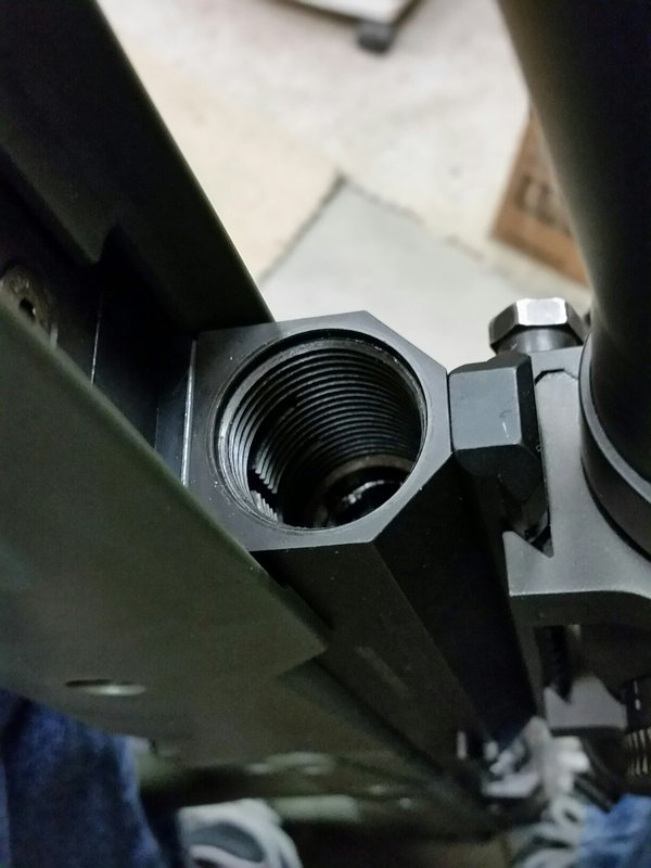

    When I removed the barrel a while ago I took a picture of the treads and clamping feature AI came up with. (they have a patent on it)
    The threaded hole in the action has threads before and after the clamping portion which I would think would help align the barrel in the action.

    The AI QC lock will push the barrel tenon radially into the fixed threads in the action directly opposite the slot between the 2 halves of the "lock".
    It will also pull on the tenon axially (parallel to the axis of the bore) resulting in greater pressure between the tenon shoulder and the action face.
    It's a fairly ideal solution as it will position the barrel repeatably in all 3 axes.
    Wow, what a clever design. Thanks for the Picture, speaks a thousand words.
