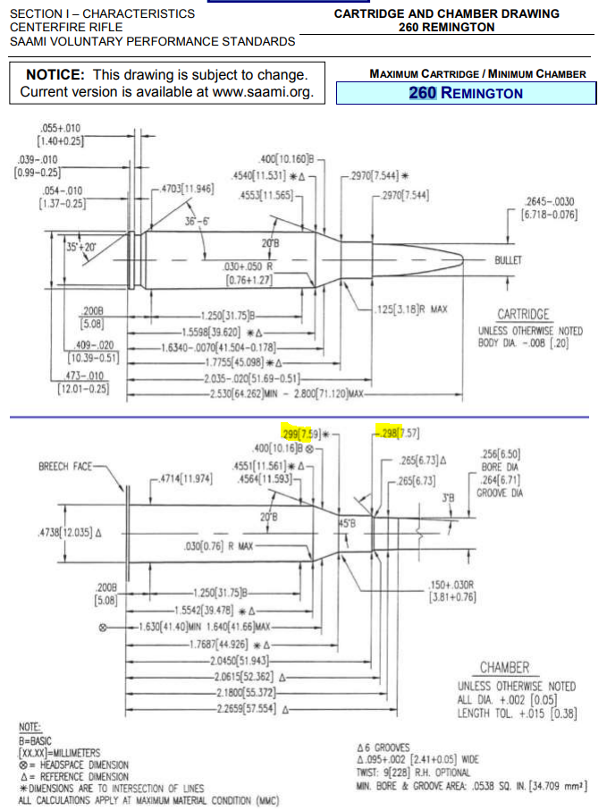

Thanks, this chamber is .260 KMW/Surgeon. Aka, Ft. Bragg, aka T. Cross aka Match. NK = .297. FB = .060
http://pacifictoolandgauge.com/260-cal-274-cal-nopix-chamber-reamers/10751-260-remington-match.html
.260 Rem SAAMI NK = .298 or .299???
saami is .299 and tapers down to .298
Your fired brass is .2965, thats half a thousandth under your .297 neck. So that seems in line.
If your loaded diameter is .2935 that does leave you with .0035 of clearance which is at the minimum but shouldn't be unsafe unless you let your chamber get nasty and built up with crud.

What else I notice is that your freebore is small. Saami has (2.180-2.0615=) .1185 of freebore.
