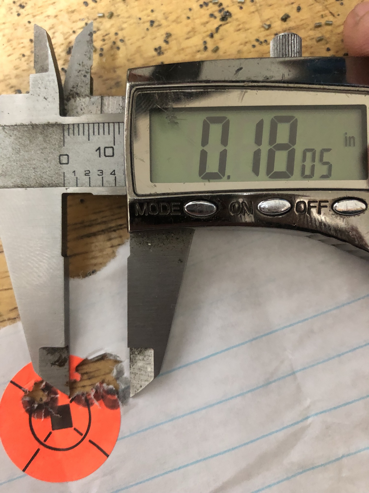

I know they're not in favor and "old school" now, but i have a SDN-6 and 51T mounts on 6 different hosts. It goes on everything from AR-15 SBRs in .300blk and .223 to a IWI Tavor. I was going to run it on my new Howa 1500 6.5CM build, but now i'm reading about how it's not a "precision can", etc etc. Obviously the solution is to shoot the rifle with and without and see how it does, but I was looking for anyone who's already tried it for more background info.
If it hurts groups, should I get a direct thread 6.5 can?

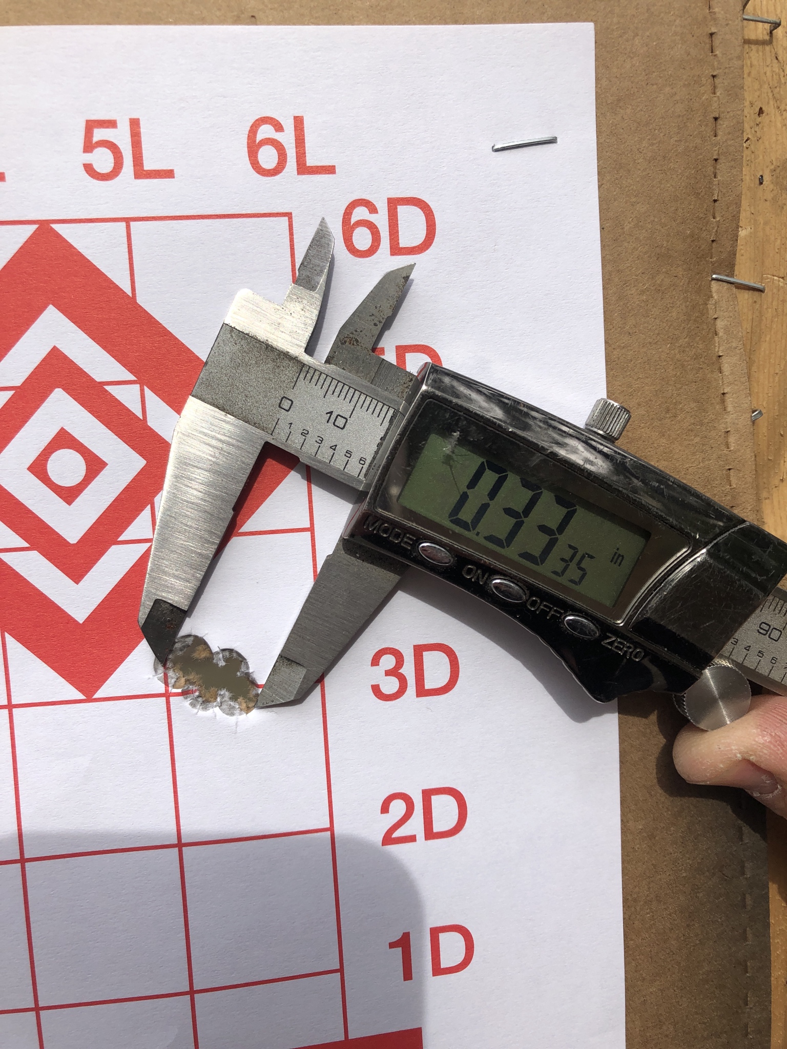

The key is to get a mount that it locks up super tight to. If it skips a tooth it’ll degrade accuracy a little. Very little but a little.
Group’s from my GAP with SDN6.

The only issues I have seen with it on multiple precision rifles is that I have yet to find a load shoot suppressed/unsuppressed the same, accuracy wise. Some loads like the can. Some loads don’t.
I have a new 51T brake on order, and i have one on my .300blk. i'll see which one locks up the highest and run it on the bolt rifle.
Those groups are smaller than your micrometer is showing- you measure from center to center on the bullet holes....
