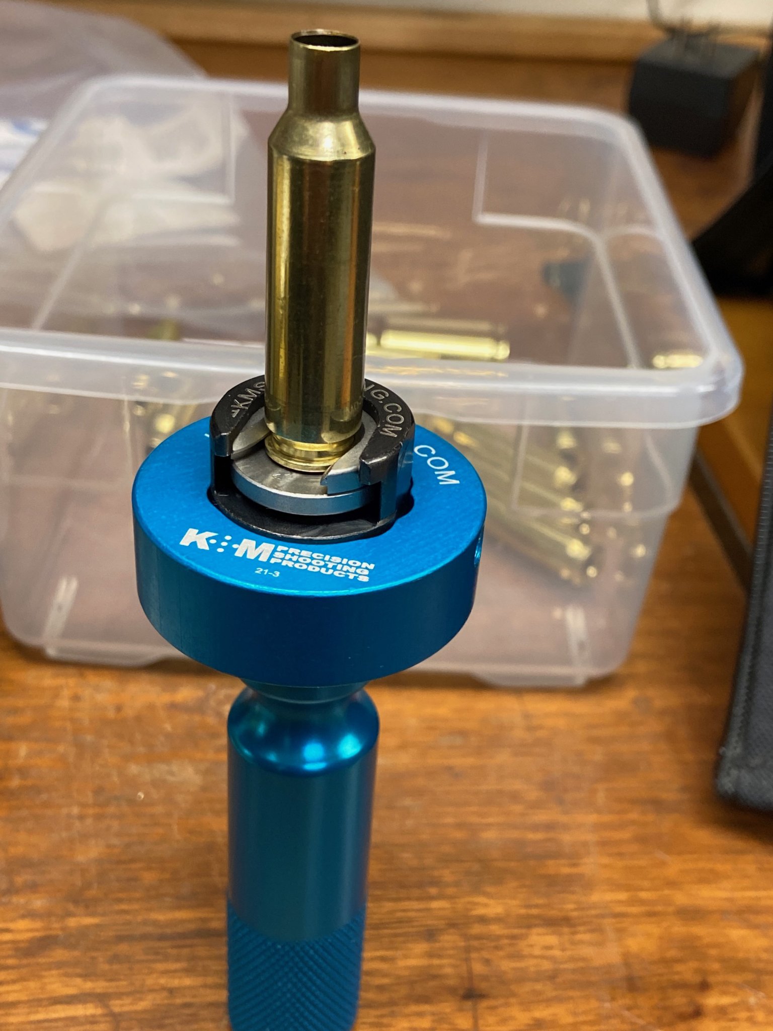

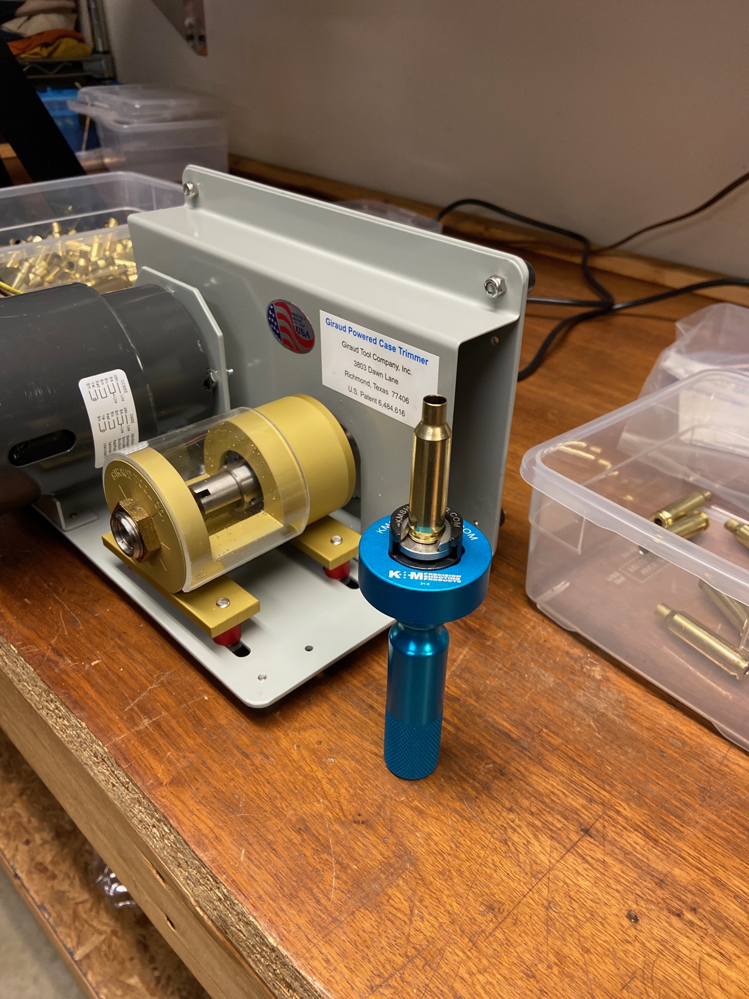

I see that everyone is getting the Henderson, does that mean that my Griaud no longer works?
Just joking, but it seems much simpler than my Giraud (plus one size fits all). I saw the F-Class John video where he compared the two and got better results; havent tested myself so dont know. Does anyone have any experience with both - anyone else compare? Any thoughts on trimming to length via the base as opposed to the shoulder? And if your headspace is consistent does it even matter (I suppose that applies to both)?
Trim length is a pretty unimportant variable as long as you are not too long. Realistically, trim from shoulder is a better measure on a case that headspaces on the shoulder, it seems to me. But the Henderson is really nice looking.

I don’t have a Henderson but I would really like to get one one day. IMO, it’s similar to the forester trimmers which is what I have now even though I have a Frankford Arsenal power station that I don’t use much anymore.
I don’t use it for the same reason I WILL never buy a trimmer like the giraud or anything that indexes off of the shoulder……I don’t care how good of dies/setup a person has the shoulder bump will not be 100% same from case to case. The Henderson or forester is a TRUE case overall length unlike ones that indexes off the shoulder.
I think his findings were related to neck tension measured on the amp and then on paper. But he admitted that YMMV given that other factors or a misalignment could have caused that.

My headspace is all > .001 of each other so if Im trimming to 1.89, the difference would be 1.889 or 1.891 and not enough to make a difference. Personally I would think that as long as your headspace is not crazy different, would not matter one way or another. Remember in headspacing we are in the .00xx world whereas in trimming we are in the .0x world - but again, not claiming anything or to truly know. His review of one vs the other had to do ultimately with which one gives you the better neck tension based on how smooth the chamfer/debut operation is. Again it was one imperfect test, so who knows.

To Giraud owners who have issues with the "ergonomics"...really, wear and tear on your fingers from pressing in and spinning a bit a lot of cases with the attendant vibration, I found a solution that is very much like what Henderson does wrt to holding the case.
From K&M
about 1/16-1/8 turn of that ring tightens or loosens the hold on the cartridge and works wonderfully. Nicely made bit of kit and absolutely a life saver on my fingers. And the total is just a bit less than $50
You need these four items to make up the tool...they are all shown on the page in the link above
