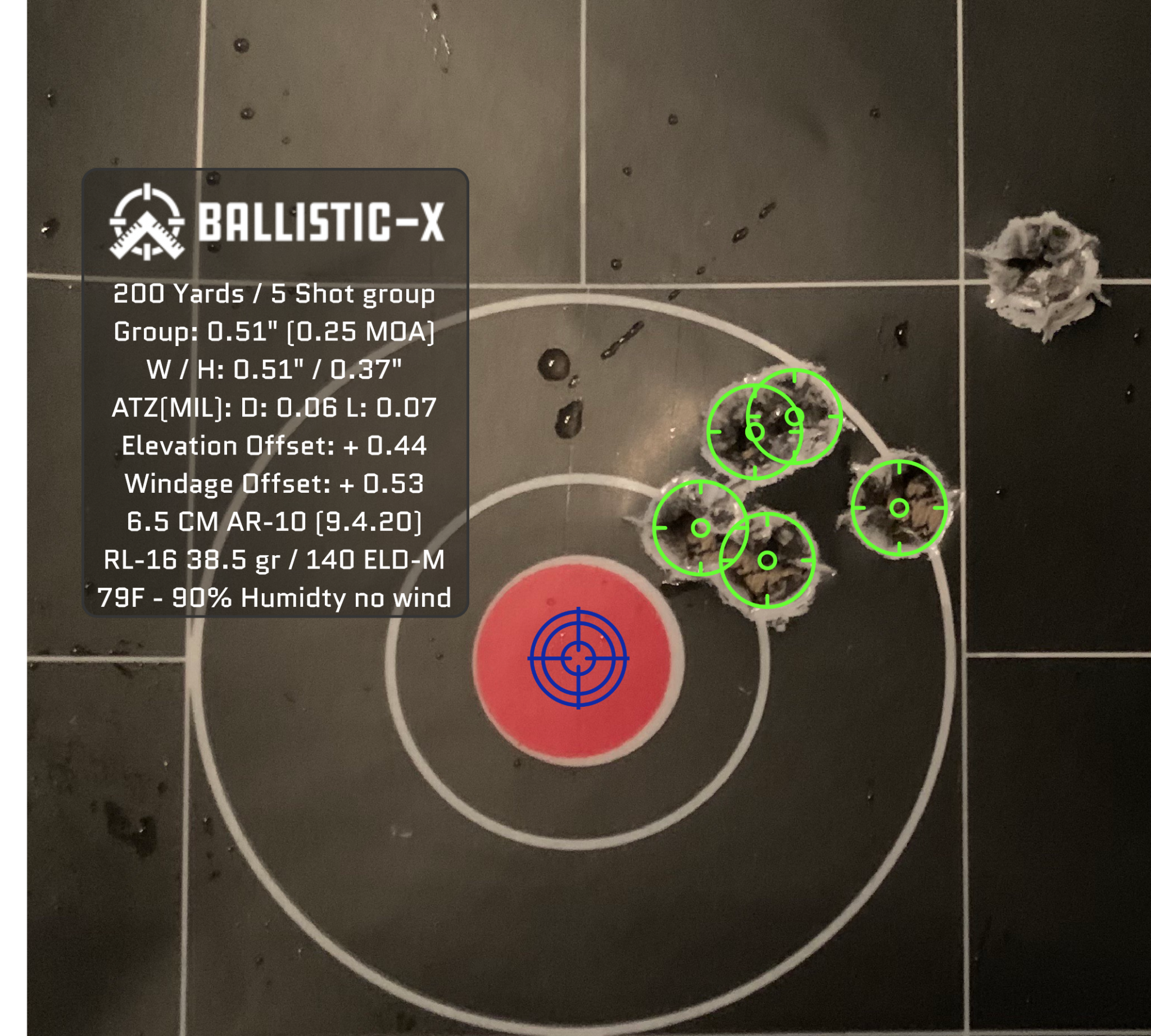

Not one bit. In My 6.5 CM I use hornady 1x fired and do no prep only trim when it starts to flow. Here is my best group but I avg. half moa so far. Same goes for all my ar’s.
