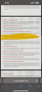

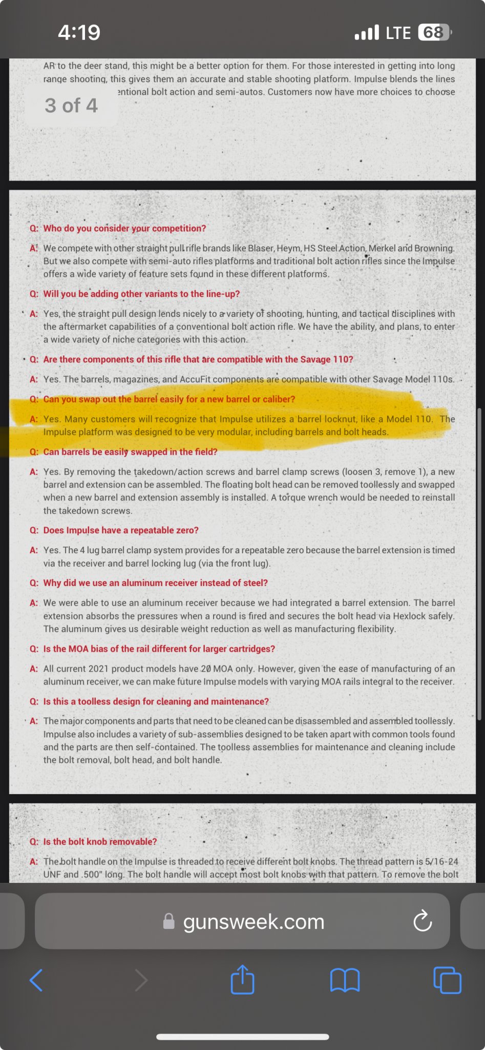

Hey yall I had a question about my savage impulse. I was reading some where and it said that the impulse is a long action with an adapter to take short action magazines and if you can easily change out the barrel is the impulse mutual caliber where you can go from a 6.5 creed to 308 or 30-06 even 300 win mag just by changing the barrel and bolt maybe. So can I technically buy a 110 barrel for a 30 cal and a new bolt for a 300 win mag or 308 and shoot it out of my impulse?
