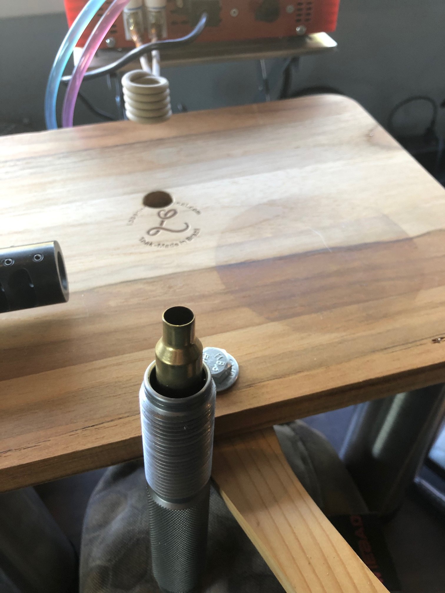

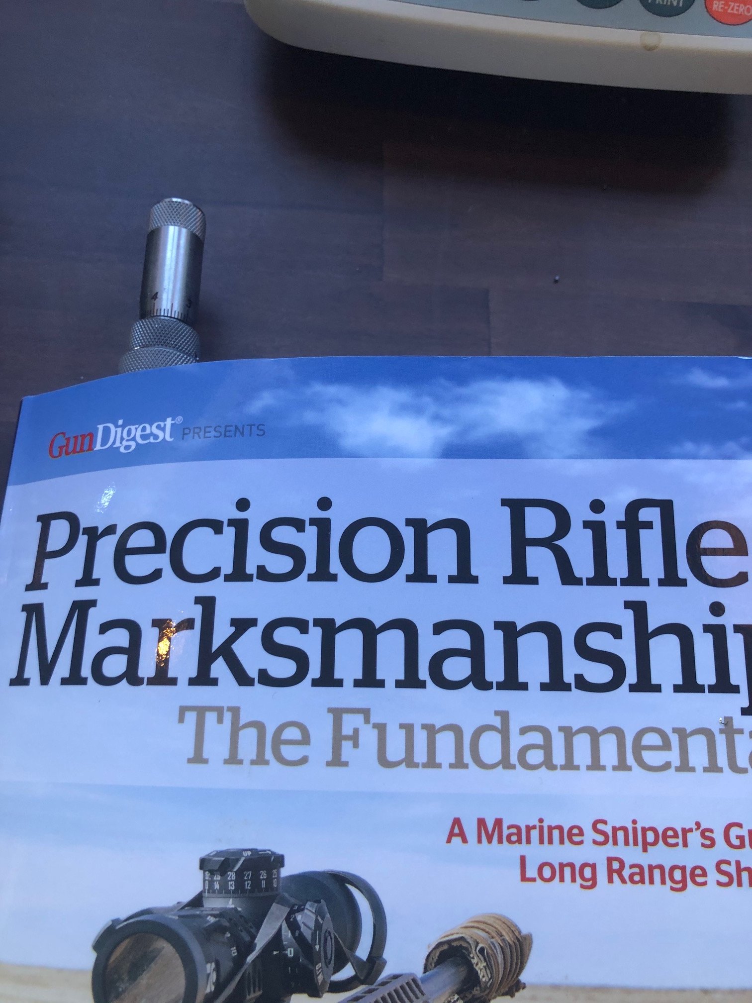

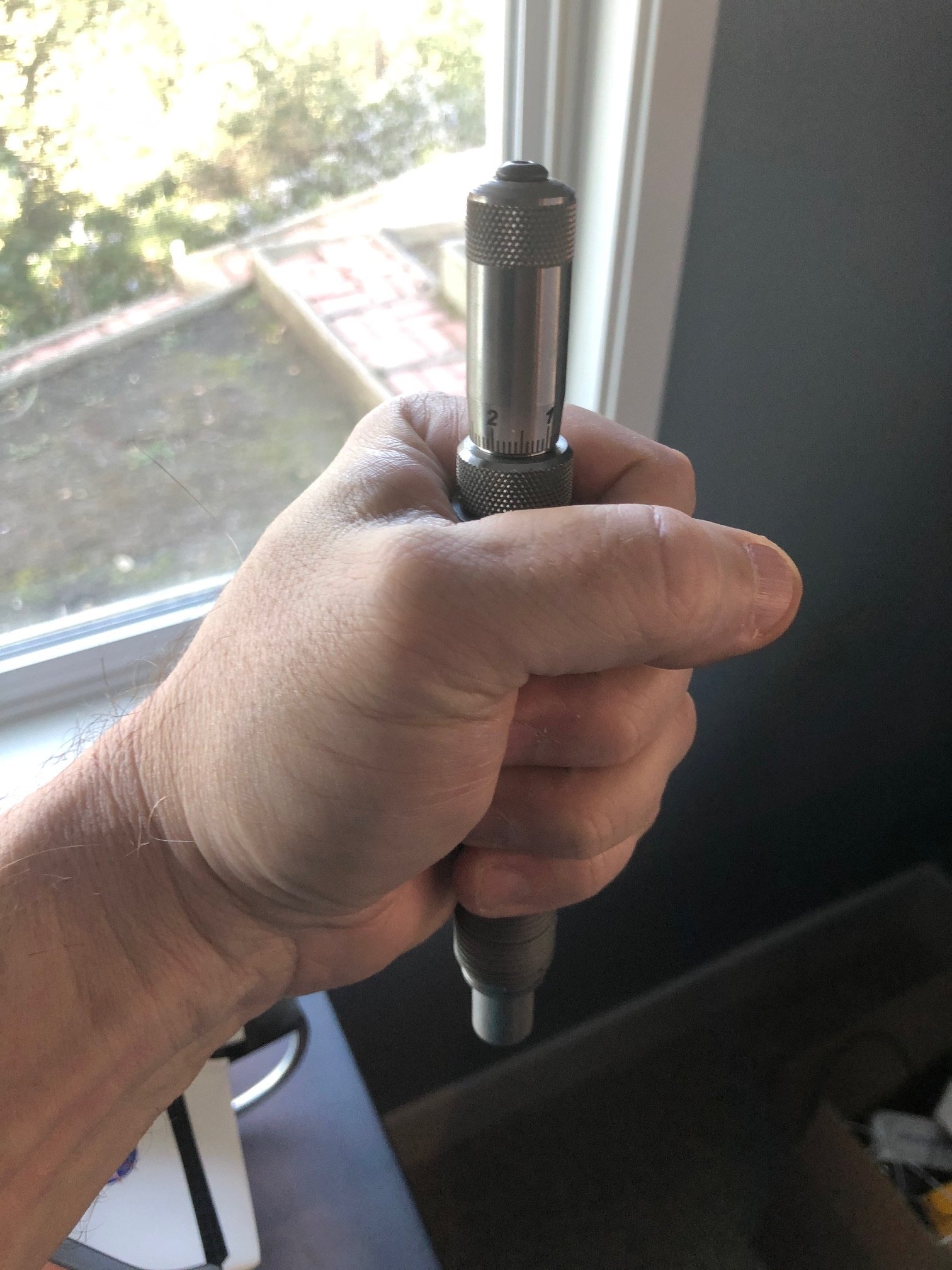

    I found the concentricity to be superior with the dies used with an arbor press, but the main gainer is knowing what your seating force is. Being able to put aside (as foulers, or whatever) rounds that fall outside whatever seating force range you're okay with makes a fair amount of difference in consistency of the rest. With my current process, I put aside about 1 out of 10.
    The last time I measured all the rounds I loaded for a trip to BLM land (a couple months ago), I got an SD of right at 6 with my 300 PRC. That was, if memory serves, 44 rounds. I used a couple of the foulers to warm the barrel up, then shot the good rounds. That SD is pretty consistent with other trips with my 300. With my 6 BRA, I'll get mid-4s across a similar number of rounds.
    I had good SDs before I got the arbor press and associated dies, but not quite this good. The dies play a role, but it's more the additional steps I put in place once I realized how much variation I had in seating force because of the force gauge on the press.

    Been contemplating an arbor press with force gauge for my ELR stuff
    Finishing sizing with an expander certainly helped with vertical.
    Press cost with inline seater is reasonable.
    The press cost is low, and the dies cost similar to regular press dies. No brainer to get one for new calibers going forward. Then, once you use it on a new caliber, and you decide to replace all your old seating dies, you find all sorts of nifty uses for them:
    Single Case Holder for Reloading (stabilizing apparatus not included)
