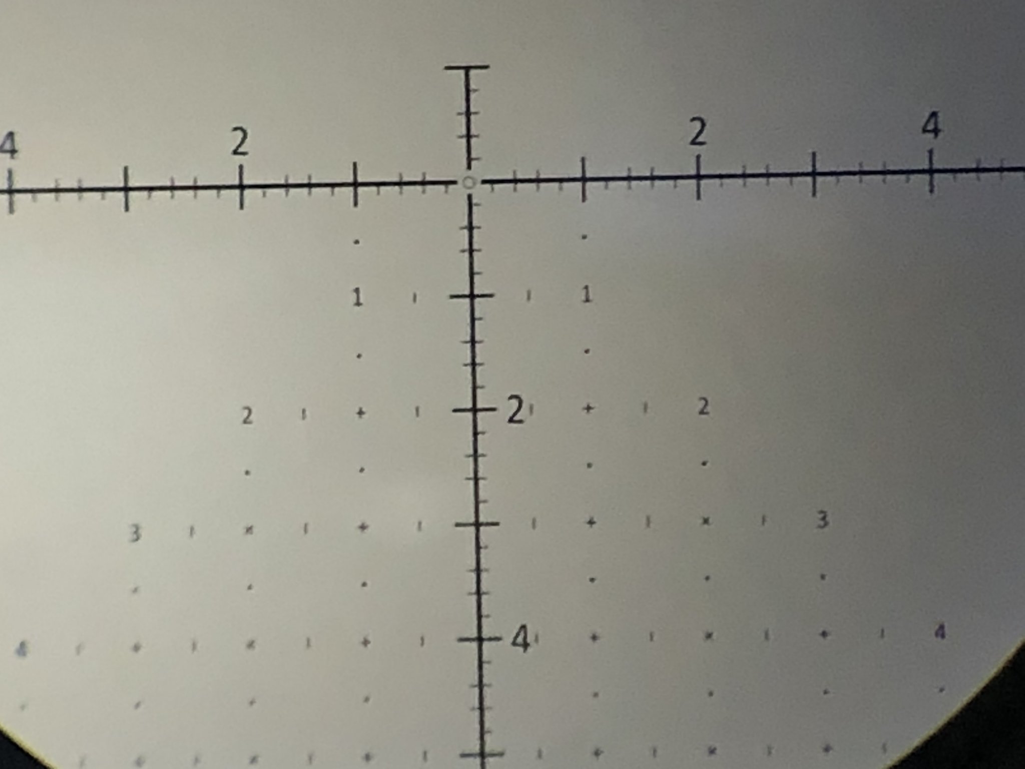

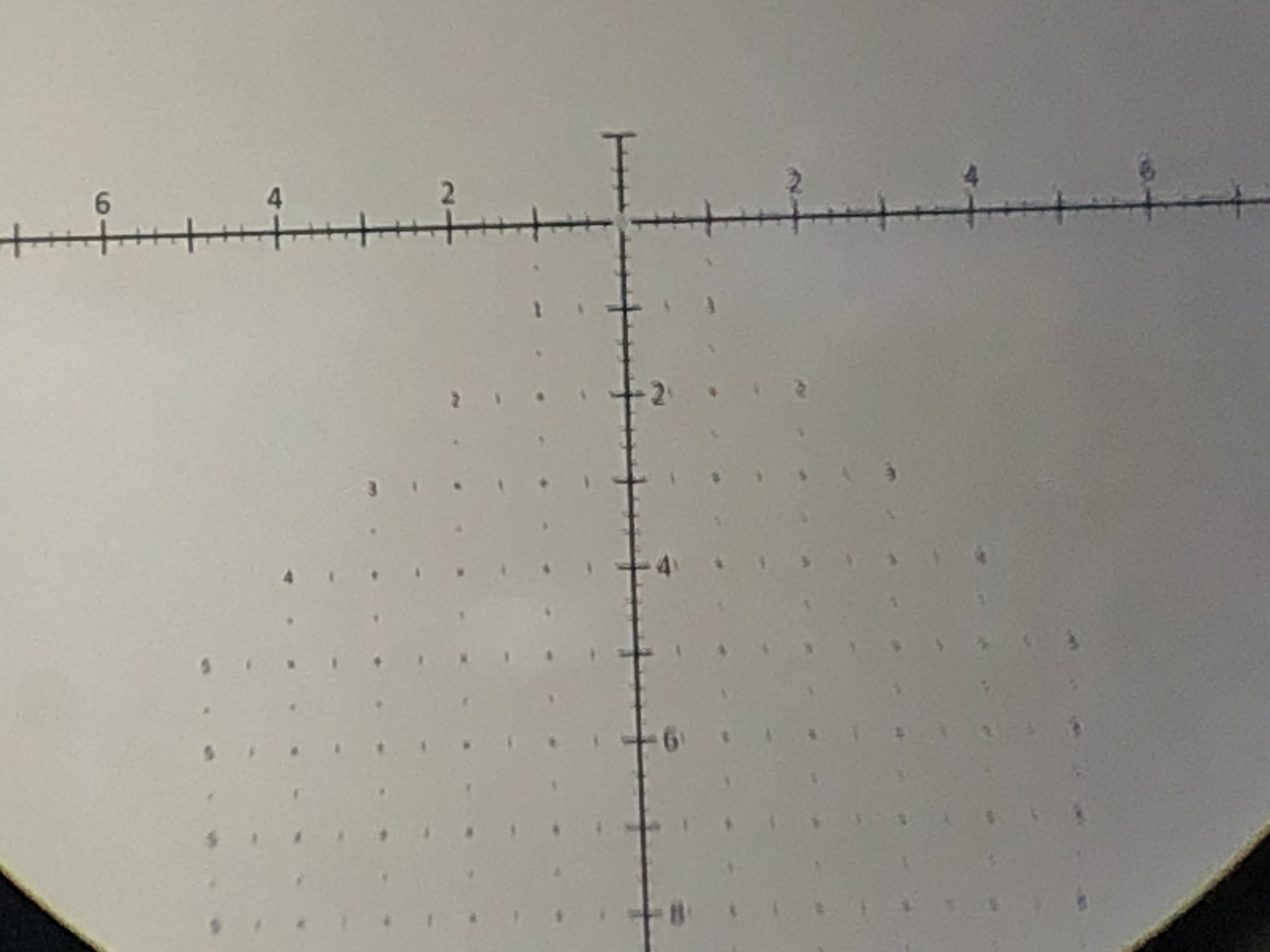

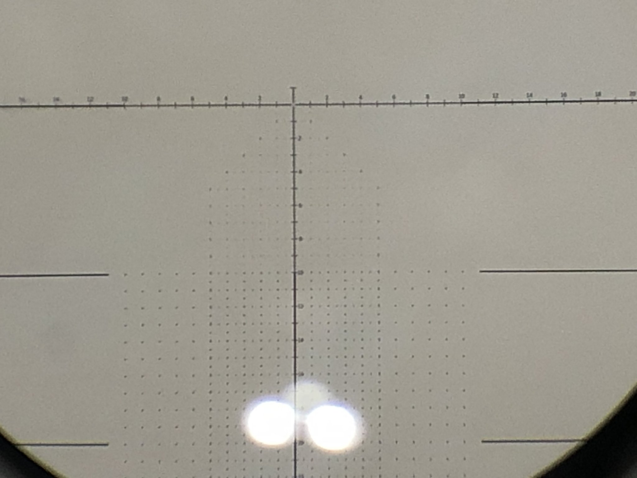

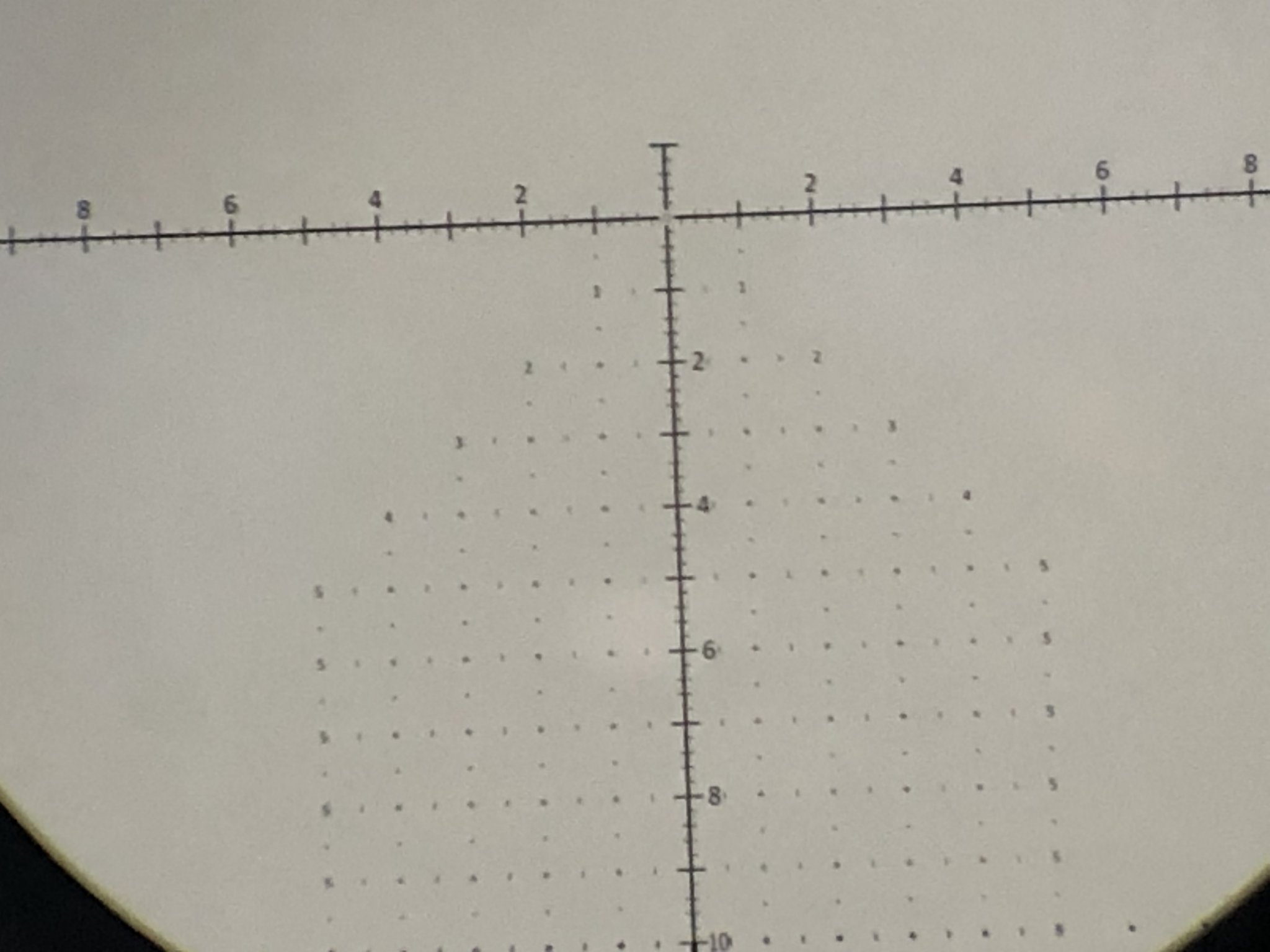

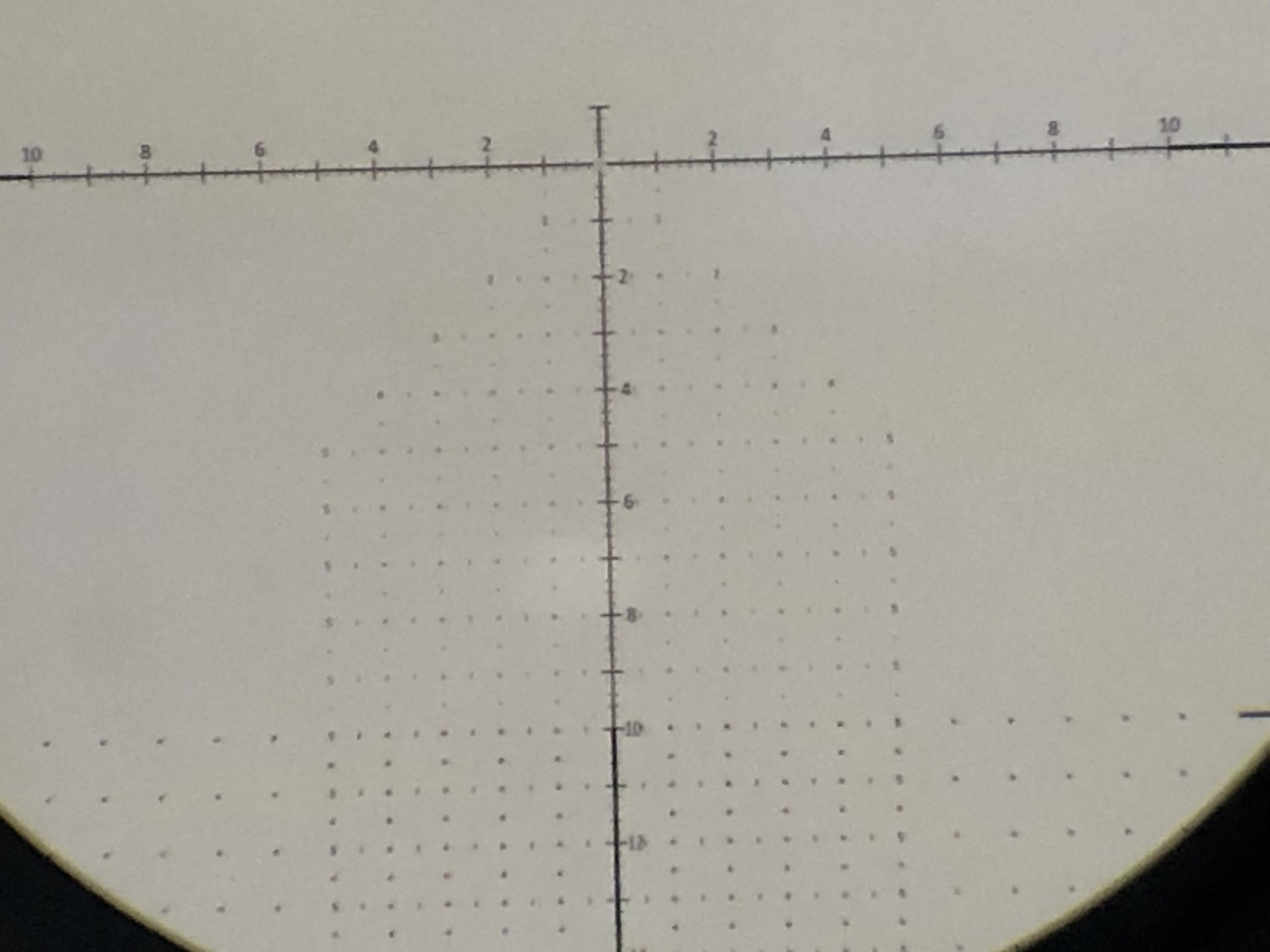

    I’ve had my Leica prs with the PRB for about a year now. I’ve shot a few matches with it and few like I have a pretty good grasp on it.
    At first the reticle definitely takes some getting used too. The open circle center is really nice for prs as its small enough to be refined but open and fast enough at the same time.
    My gripe with the tree is the X’s and +’s. Odds and evens, dots and numbers. It’s a lot of information going on. It is however really nice that it fades into the background when you aren’t using it. I think it’s an under appreciated quality of the reticle. With simpler aiming points it would be ideal. It functions like an MSR or SCR when needed but also slides in with Xmas tree when needed. 15x it’s a little hard to see if you are running a holdover stage or something. 18x is perfectly fine.
    The body of the scope is very much a Delta Stryker LOW made type. The internals from everything I can find are not. Ilya has a write up about it somewhere. I’m guessing they utilized the chassis to save cost.
    The glass is baller, like really freaking good. I liked it much better than my Nightforce glass. I have several MK5’s and it’s a bit above them. The coatings they use have fantastic contrast and color.
    Tool less turrets are the shit. The included zero stop Allen wrench is a great touch. The only reason I would consider getting rid of mine is for a 7-35 mk5 to standardize with all the rest of my stuff. Not because it’s any better in any way but because I have like 20 leupold products and this one German thing sitting on a rifle. Lol. Hope it helps.
    7x,12x,15x,18x and 30
    My mk5 T3 is right at 7 on 25 and right at 12 on 15x. The h59 is 12 at 15x also but it’s only a 3.6-18. That’s interesting info I had never compared before.
    Yes, I never gave it much importance, but after getting the XTR3, I think it really does make a big difference. Tried the MK5 also, and glass was very comparable to XTR3, but FOV was much smaller... just checked: XTR3 is ~8.4 mils @ 25X. I'll probably try a wide angle March next...
