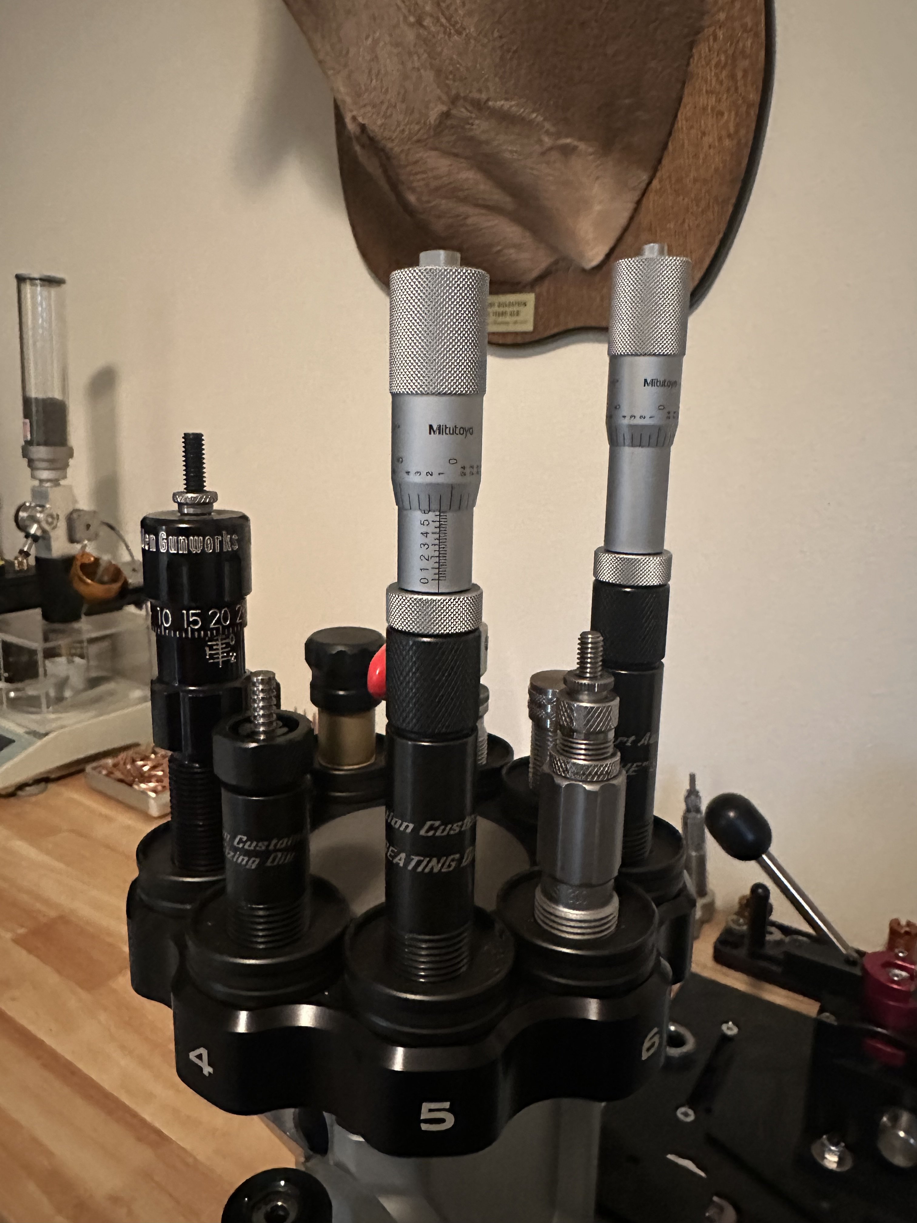

    @Maurygold
    Sick setup!
    Do you think the SAC dies load more accurate/precise ammo than something like the Forster dies or, for you, is it more of a luxury type item that is just nice to have; something that makes reloading more enjoyable for you? Did you run into issues with other dies that the SAC dies fixed? Also, do all the SAC sizing dies use a bushing? I didn't see any regular FL dies on their website just now when I looked. Thanks
    Again, very nice setup!

    @Maurygold
    Sick setup!
    They’re not more accurate but it’s def a luxury - unless you have a large magnum with clickers (300 prc, Norma or win mag). They run more smooth than anything and they use bushing. All their dies are FL

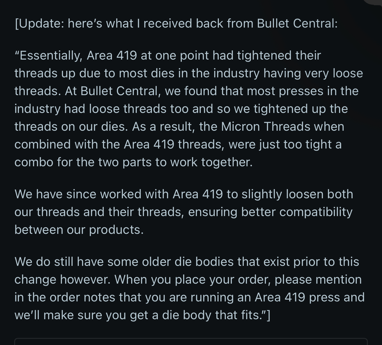

    Well crap! The Micron 7/8-14 threads are incompatible with the 7/8-14 threaded stations on the Zero press turret. It will not begin to thread into any of the 7/8-14 stations on the Hybrid turret. Will have to find a solution.

    Found this, it should help. Reach out to bullet central
    Thanks.
    I was actually aware of the above, and called them BEFORE I ordered. I got the wrong guy on the phone because he was clueless and acted like I was asking a dumb question. So I ordered, and got bitten by the issue above. I called back this morning and got the right guy, he told me everything listed above, and thinks I may have gotten a die assembled with an older body. They are supposed to send a return label and swap it out, but not sure when because they’re currently back ordered. The guy today (Rael Harris) was awesome. The guy I got before shouldn’t be answering the phone or advising anyone.
    Reactions: secondofangle2
    You have me at a disadvantage on that one - not familiar with the story.
    Thanks. Well, that's a cluster. I can tell you that the guy today was really annoyed at what I was told by the guy before him. I didn't misunderstand the first guy. I was forewarned with the info Maury posted before I called, and he completely dismissed all of it. Then the guy today confirmed it was all correct. In the end, they're going to make it right, and that's what counts. I appreciate that. I think I just got a guy the first time who wasn't qualified to answer the question, but wouldn't admit it, so he made something up. The guy today knew exactly what I was talking about, and jumped right on it. I'm definitely not here to bash Bullet Central. It was a mistake made by a single employee who was not familiar with the situation, and apparently unwilling to educate himself about it. The guy today was everything you could ask for in good CS, and knew his stuff. It's all good.
