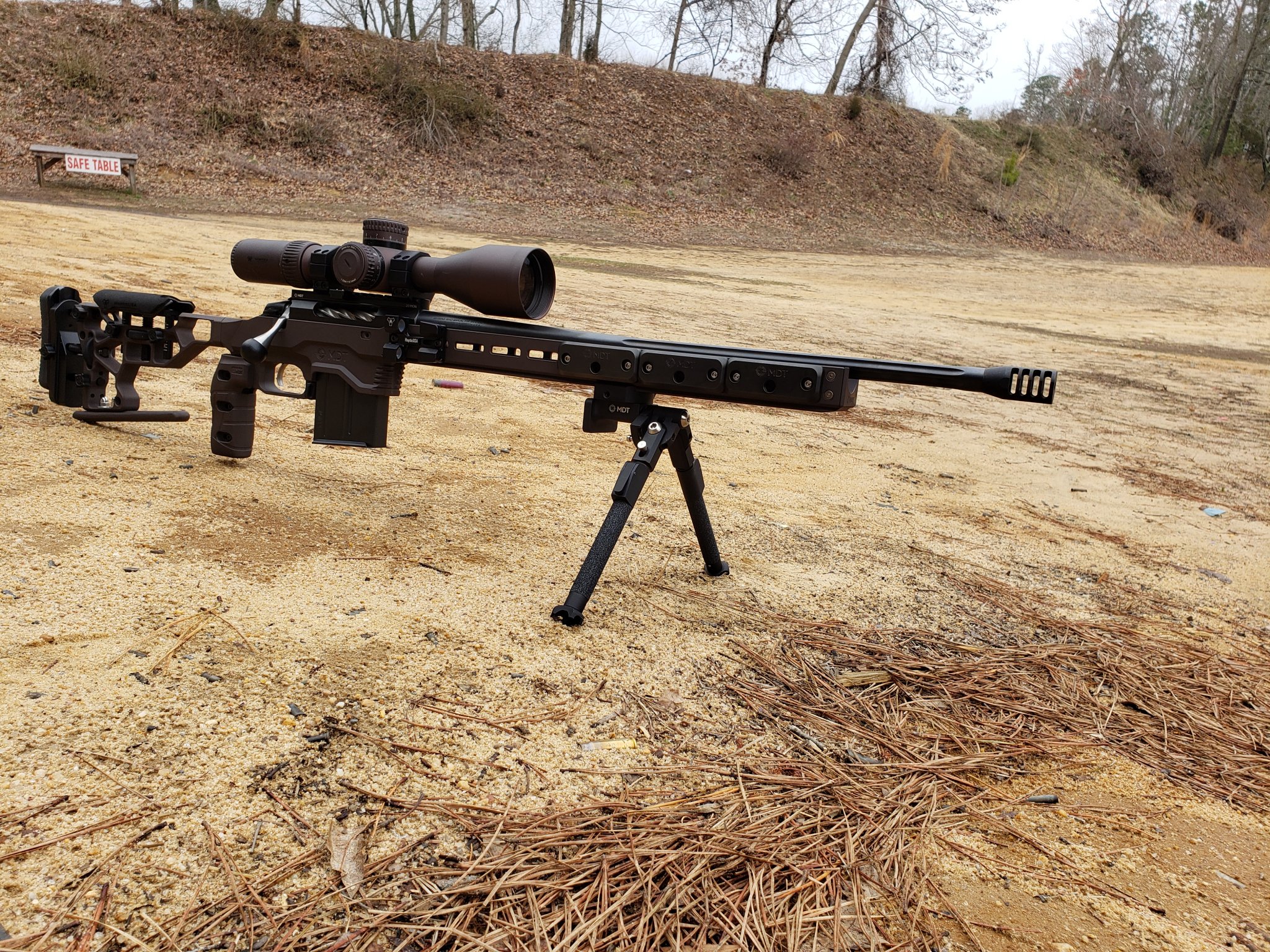

I'm shooting a 308 in the ACC so it kicks a little. I shot a friend's rifle (not an acc) in 308 and he had a limbsaver pad on it and I could stay on target better.
Is there a part number for a limbsaver pad for the ACC?

Doubt it, but there are universal grind to fit pads.

you could try just adding more weight my pop turned our rpr in 308 win through weights into the felt recoil of a 223 or something real close to it . there is no reason more weight would not work the same way on a mdt chassis I would get real weight not there weights 2 for 60.00 pop got a 14'' flat stock of steel 3.8 thick and added 14lbs 7 lbs per side .
more than 1/2 the price of mdt weights and more than double the weight just need m lock attachments and your good to go .

I have the EGW Spacecomp brake on there, definitely made a huge difference and I have most of the weights on there I think I'm just shy of 24 pounds using a bathroom scale.

I find the limbsavera too soft. Removed then from all my xlr chassis. Idk they just wiggle and squish, I feel I get steadier and more consistent shoulder pressure into the chassis with a thin stiff pacmeryer pad.

How heavy is the gun?
Almost 24#

I'm going to make a few suggestions, shorten your LOP a bit to where you're totally square behind the rifle with shoulders, hips and body to take the recoil straight line with body. Run the butt pad in against your clavicle/neck junction, the closer to center your body the better. You may need drop your cheek piece as usually this requires more jaw weld than cheek. You don't want your butt pad in the shoulder pocket, this usually causes recoil to send sight picture up and left on right hand shooters. Where is your balance point on that rifle? Appears to be a fluted Tikka factory barrel even with their heavier contour, that's a light action/barrel. To get that up to 24# if you're slightly rear heavy that will cause a lot of muzzle rise in shots too. Put some body into the gun forward, but also apply pressure from grip back to shoulder. Squeeze. These things should help. I mean I can spot shots from a 12# Tikka ctr 65cm thats using a mbm lil bastard, I'd think a 24# 308 wouldn't be tough.

Dude it's like you know everything about me. Yes, exactly, it kicks up and left. I can't remember where the balance is I rarely touch this gun but it probably is rear heavy. I also don't pull the grip back like you said, I just kinda let it sit there and free recoil.
