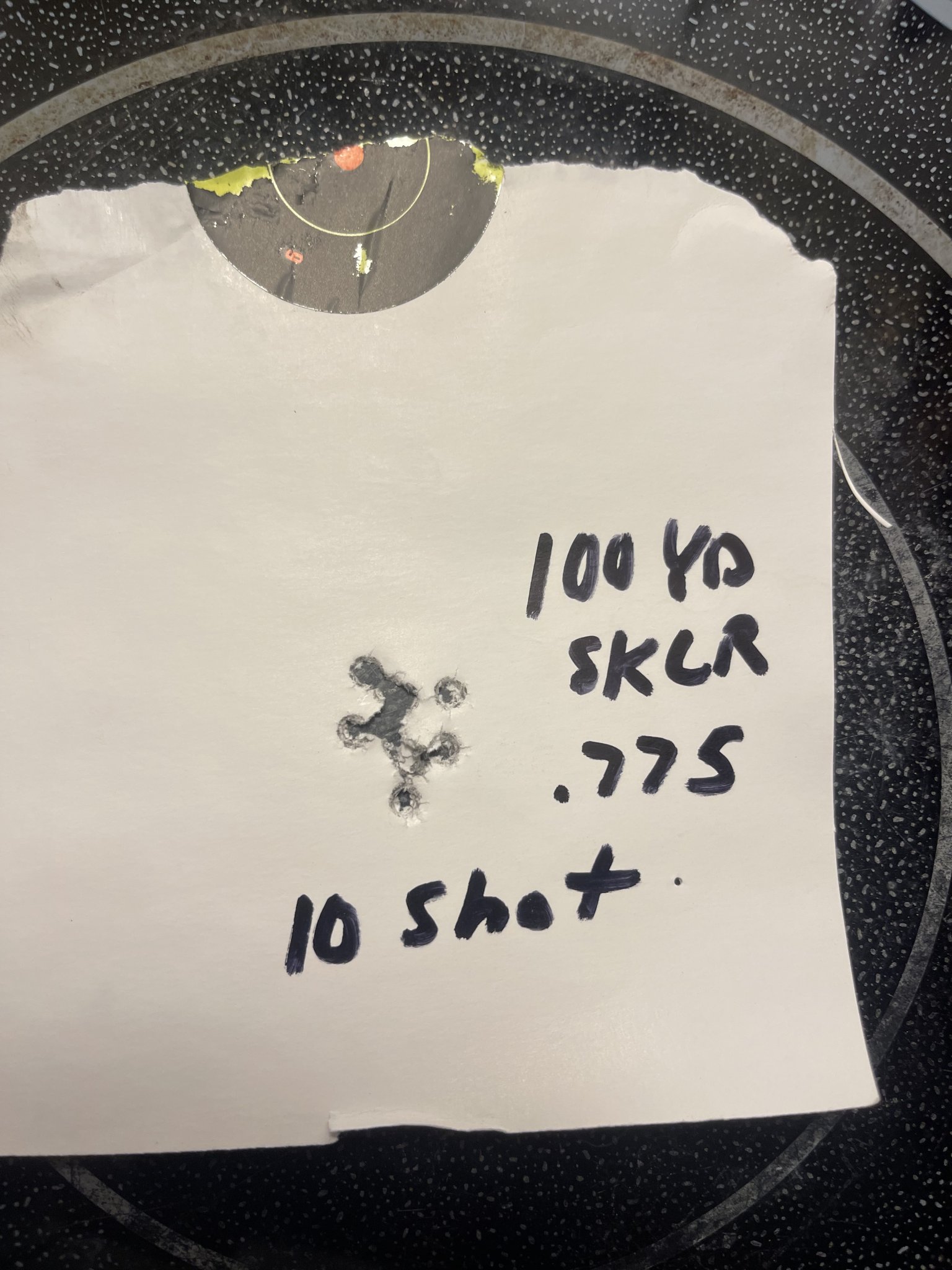

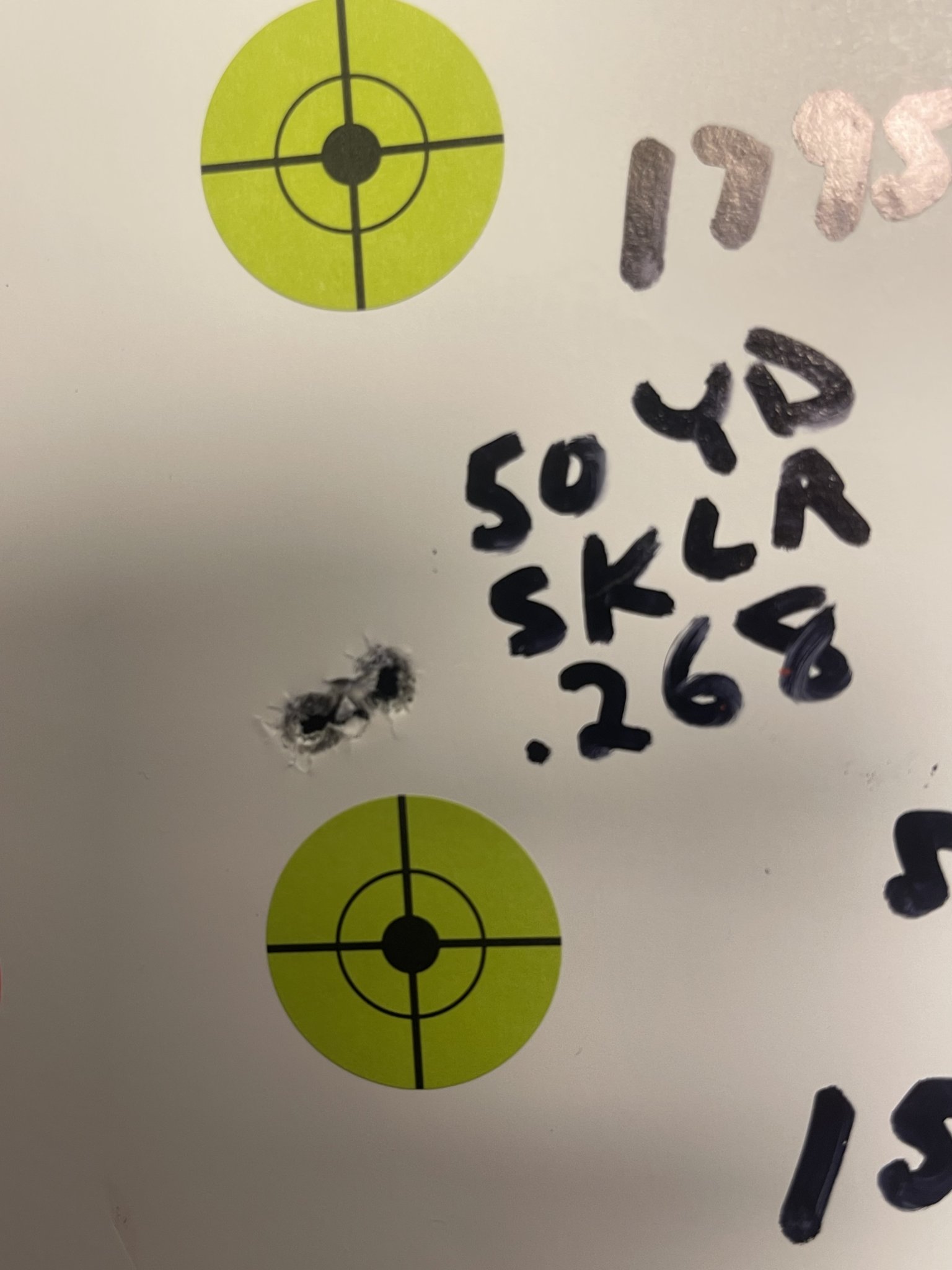

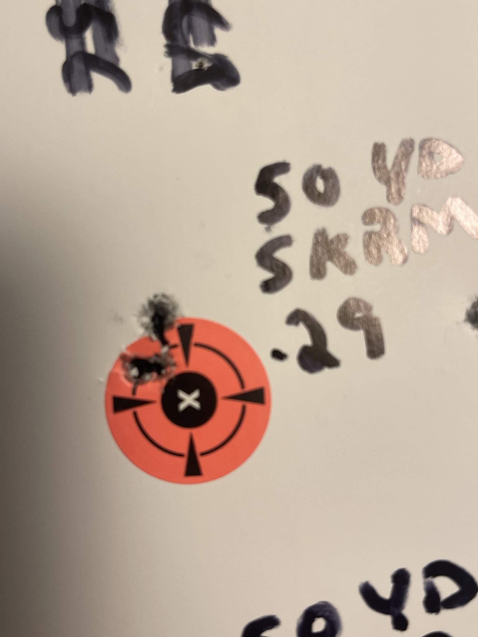

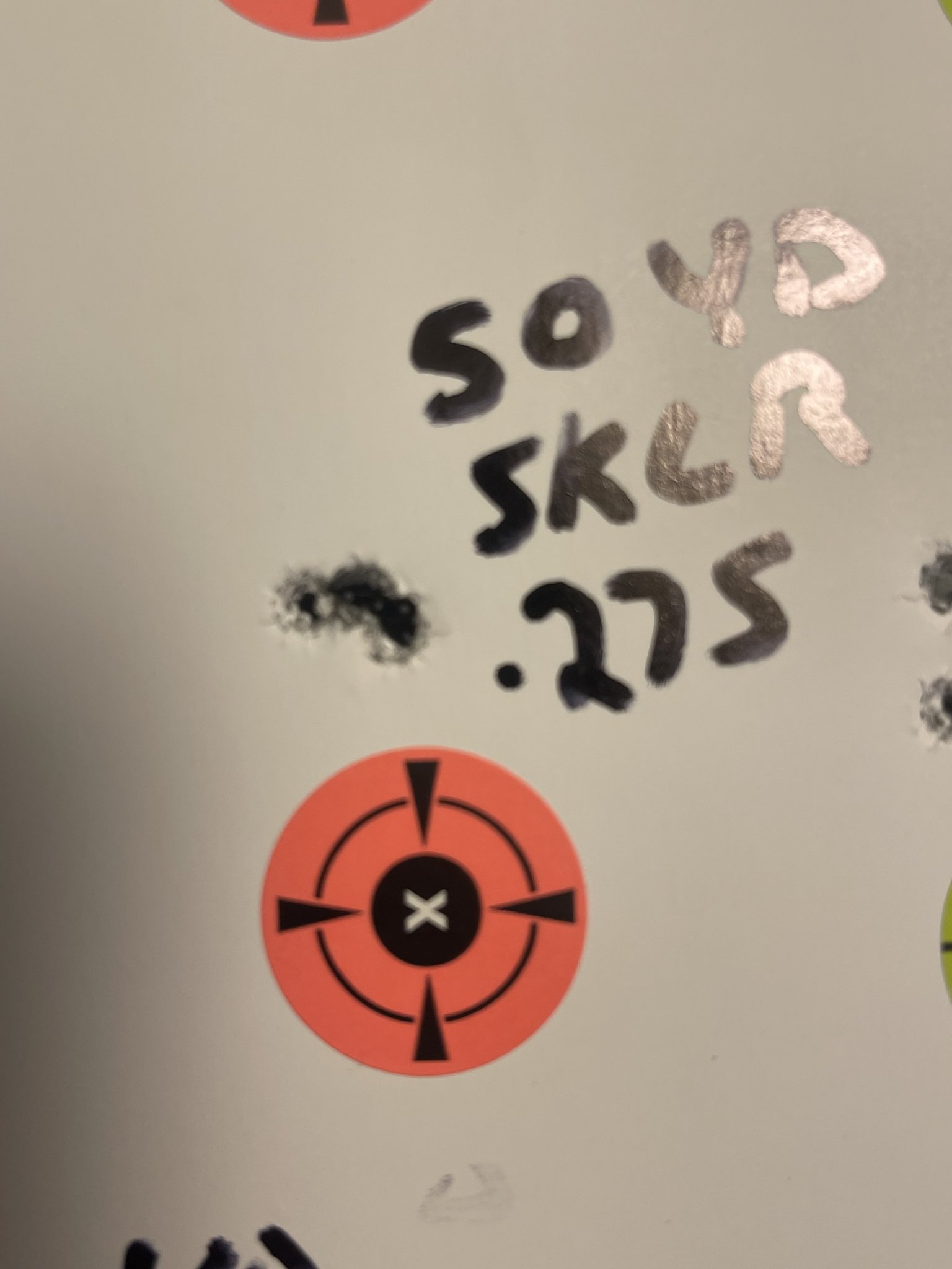

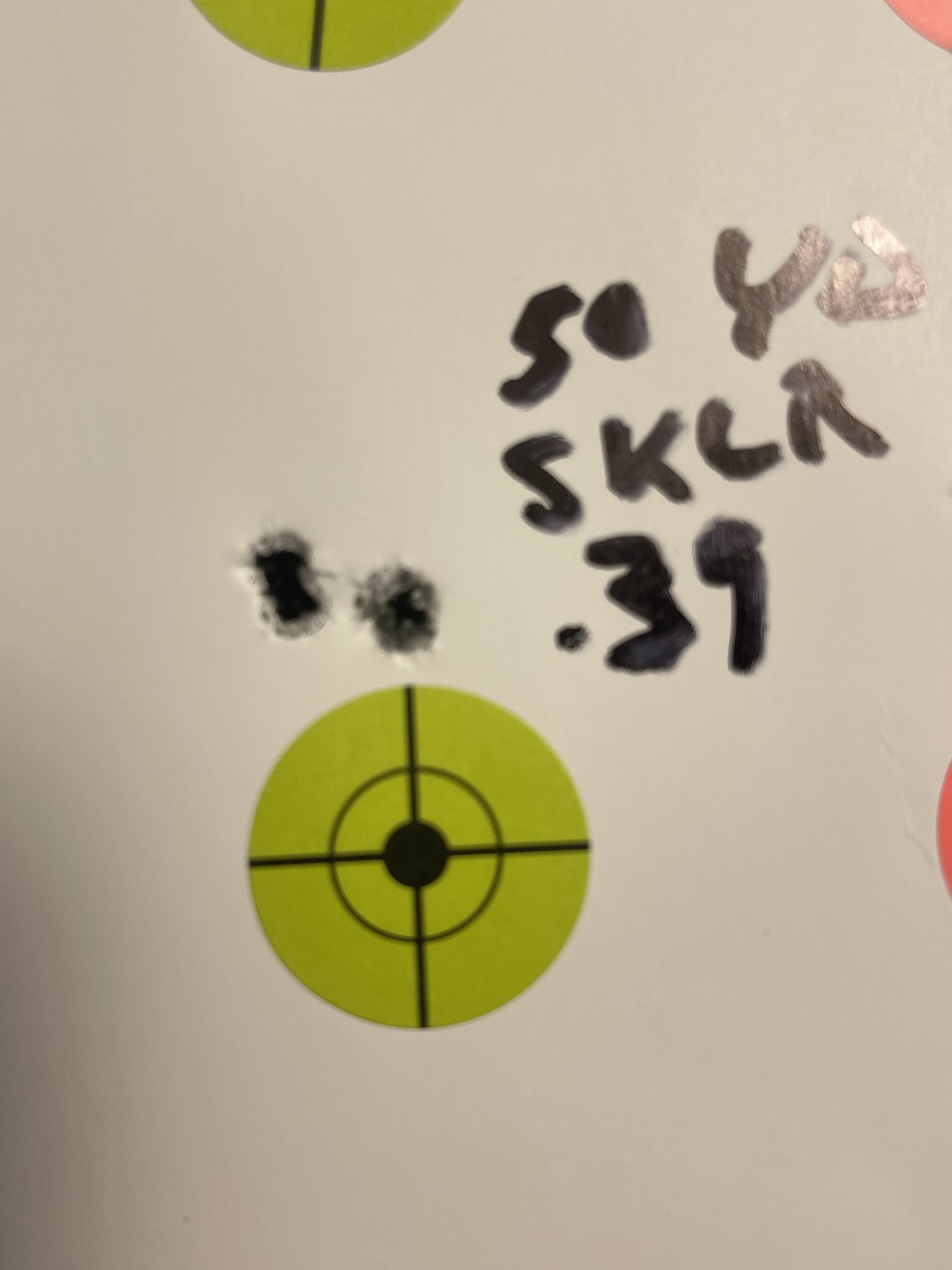

    Here’s a 100 yard group with my B14R/SK LR ammo. The SK match shot almost the same but with a bit more vertical. Like 1.25-1.5” for 10 shots compared to this 10 shot SK LR group below
    This is about 100 rounds down the barrel from new. Couple 50 yard 5 shot groups from that day as well
