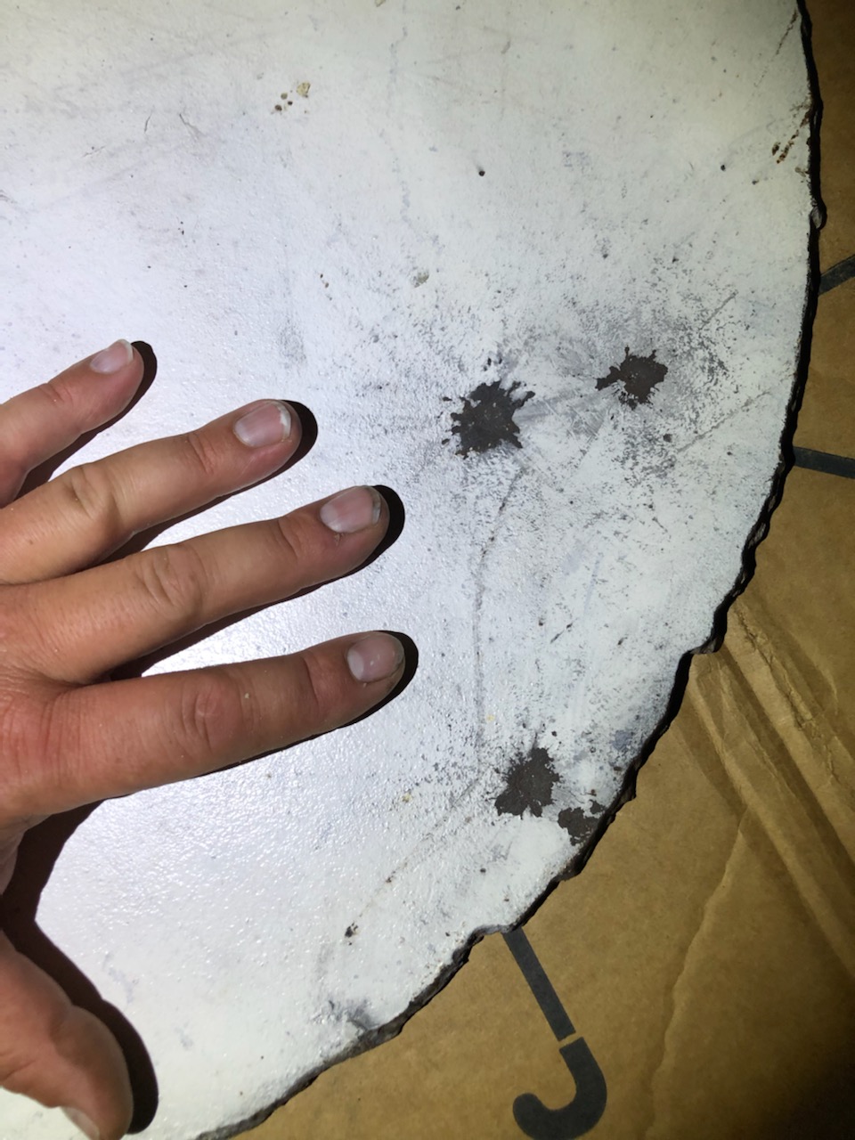

At 1,000 I've shot a 3 shot group the size of my open hand. my buddy has shot about the same.

If you scroll up a little bit...... There is a picture of 3 shots the size of my hand, And I am not Andre the Giant.

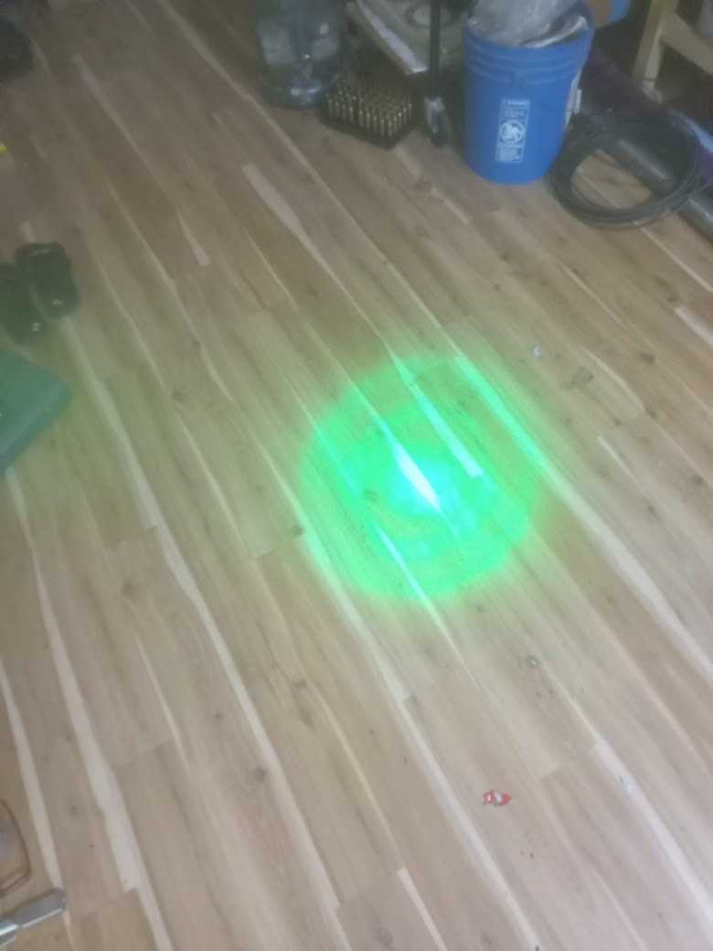

I also used Caldwell 'Flash Bang' LED shot indicators. They worked well and are only $30 per unit. Similar to Magnetospeed T1000, they have velcro hook and loop back pads.

Here is a picture of the new flash bangs in my reloading room. I am holding the light and the green flash is about 6-7 feet away.
