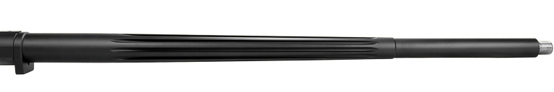

1.3" Where? Is there any barrel taper?
A barrel is usually listed by profile or contour. You can refernce these contours on many of the barrwl manufacturer websites.
Bartlein barrel
1.3 inch diameter at chamber end.
Tapered and fluted 26 inch long.
Don't know diameter at muzzle end but I can find out
Cadex rifle
Not purchased yet.....saving $$$$$ still !
Bartlein barrel
Cadex rifle
Little bit extra info from the CADEX website
In order for Cadex to offer the best extreme long range sub-MOA precision rifle, we selected Bartlein Barrels. Teamed with our Cadex designed 1.300” straight taper, fluted barrel and a threaded muzzle. All Cadex barrels are 5R Mil-Spec Match Grade Single point-cut rifling with an optimized twist rate.
