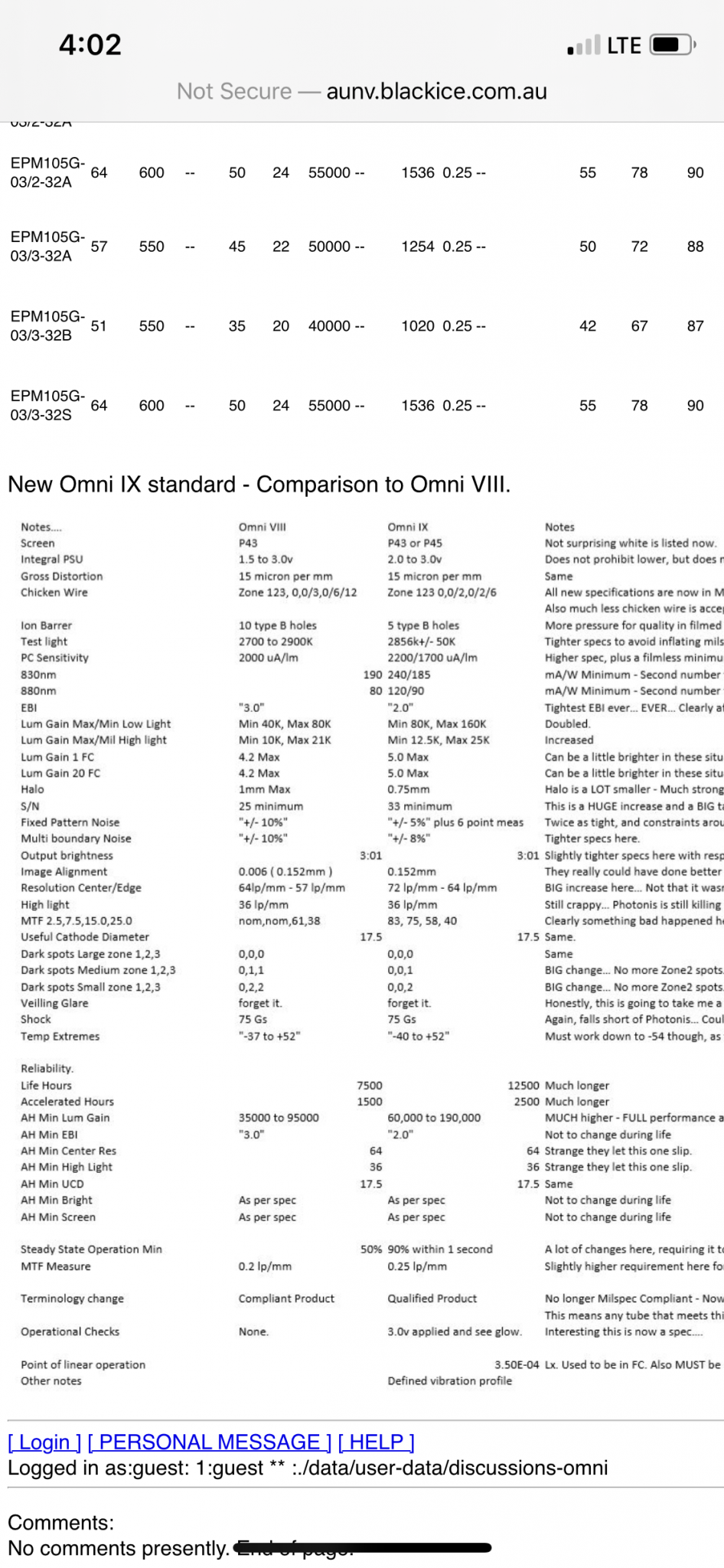

Thank you for the kind words. These tubes are not yet available for the commercial market. Their actual part numbers will differentiate these tubes via the spec sheets.
Here’s the specs I have seen. I have NO IDEA if these are actual. I’ve just seen them floating around.

So putting aside the L3Harris/EOTech drama, this increase in channel plate density will bump tube resolution I assume? Does it also have any effect on the other specs, or is it primarily juicing up the FoM calculation by going 80, 90, 100 on the res and maintaining high 30s-40s in S:N?
So putting aside the L3Harris/EOTech drama, this increase in channel plate resolution will bump tube resolution I assume? Does it also have any effect on the other specs, or is it primarily juicing up the FoM calculation by going 80, 90, 100 on the res and maintaining high 30s-40s in S:N?
I have not seen a spec sheet with the 81 lp/mm yet. I have seen a few with high SN ratios, like 37+, not that I have much experience though...
For someone that enjoys looking through nice glass and scopes, will there be a discernable difference between two tubes, one with 68LP but on paper is 64LP versus a true 72LP?
Trying to stay on topic. A 90lp 40 SnR would do it for 3600FoM. But thats meh on 1x devices. Im more interest in Vic's "too damn bright" indirect quote from the L3 rep. The supposed omni IX specifies min 81k gain. Ive yet to see a tube with gain over 69k. If we're at the cusp of seeing such tubes being released, thats a leap in that criteria.
edit: well guess more on topic, not exactly what the OP's asking but good information none the less

Agreed - if the channel density is only affecting resolution, I'm not too excited. It's the other specs that'd be interesting if there was a big leap. Blinding-bright tubes... hopefully that'd encourage folks to put manual gain into their new housings!

I can’t tell 64 from 72 in a monocular. Maybe with better eyes, if you were trying to read a book in the dark.
To me at least, with bad eyes, totally true.
Have used many, but my current personal monocular is very bright, un-noisy, unflawed, etc. but not esp high res (I forget numbers now). Fine for walking, shooting etc even in quite dark conditions (outside of training I have used IR Illum maybe three times) but /sometimes/ when trying to read a map, or a compass, small things aren't readable as they are with other units.
I work around it with no problem (go dim light under cover, have someone else read the map...), but absolutely to I think the point, worth recognizing what your real needs are and not just buying high-FOM for the sake of it or because "better," without understanding what you are getting for that number.
