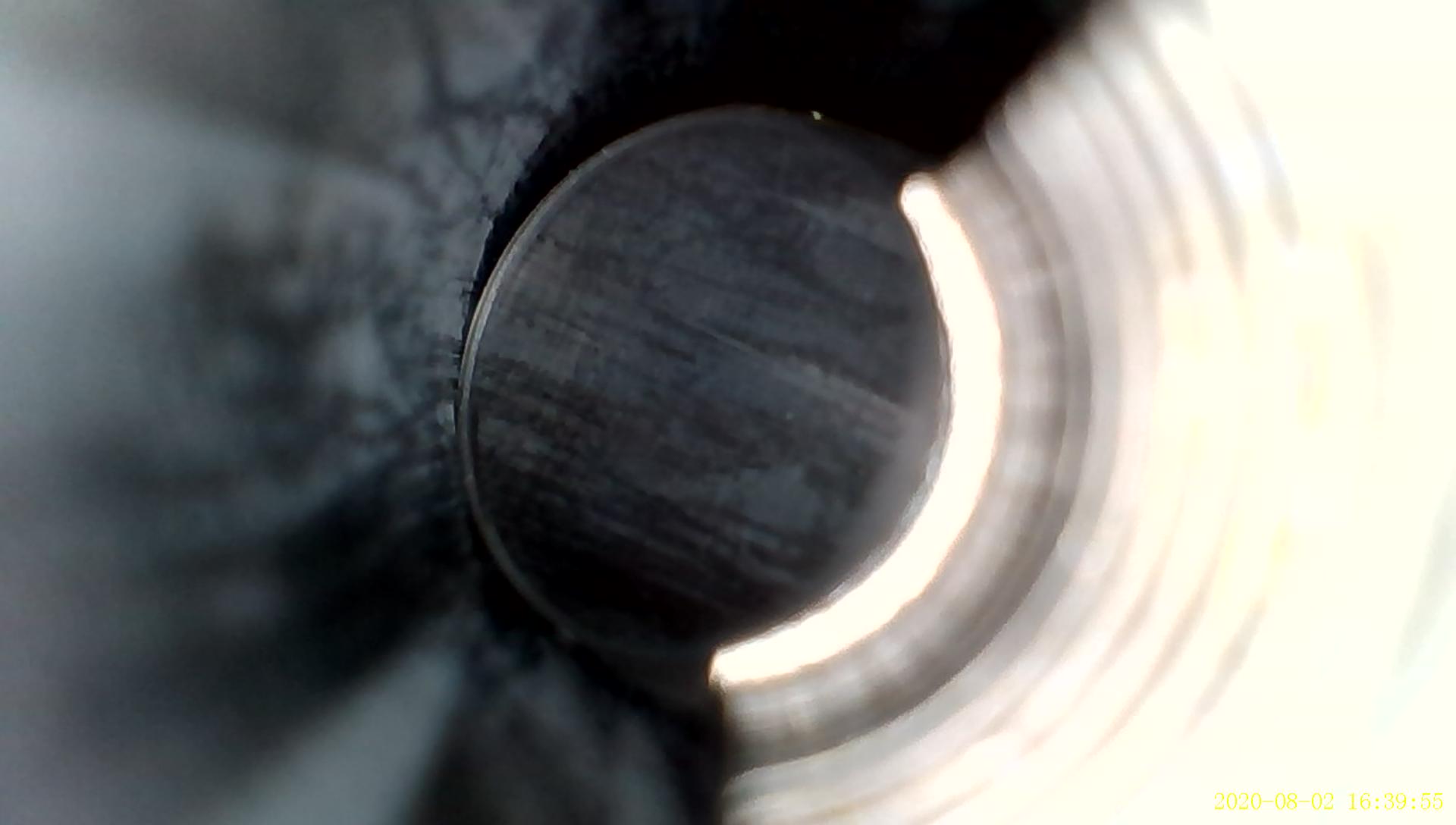

Is this a carbon ring???

    Well, yes...its a ring and its black so I'm assuming carbon but is this what people are talking about when they have concern/performance issues resulting from a carbon ring?
    I'm guessing that the ring forms just past where the neck of the case stops...that is, right at the beginning of the free bore? Right?
    Sorry my pic isn't that good...I need to experiment with this less expensive bore scope (Teslong) and see if I can up the quality. But this ring is showing at a point that appears to me to be back from from the little constriction which I assume is where the neck ends....right???
    Thank you

    It doesn’t look bad to me but you can’t always see a problem with your scope. If you’re having accuracy issues and you have reason to suspect the barrel it probably is.
    Reactions: Baron23
    It’s hard to see what’s going on with that picture. I Don’t see any rifling, Is that just a really rough chamber with some chips weld or scoring through it?
    Reactions: Baron23
    Could tell more if you can post a series of 4-5 pics of the area from the end of the chambering to the rifling. After that transition area is where carbon rings are typically seen. However I wouldn’t go scrubbing with abrasives just because it’s got some carbon. If it’s shooting bad and your sure it’s not something else then you’re probably not gonna hurt anything. Just be careful with your barrel because over zealous cleaning can ruin one.
    Reactions: Baron23

    The carbon ring that effects the bullets engagement with the lands will be after chamber neck ends, not in between the case neck and the chamber neck. That’s just a dirty chamber, and not that dirty from the looks of it.

    My pics suck ( working on that haha) but where the chamber has that small lip, which should be where the neck ends or close to it, is def forward of that “ring”.

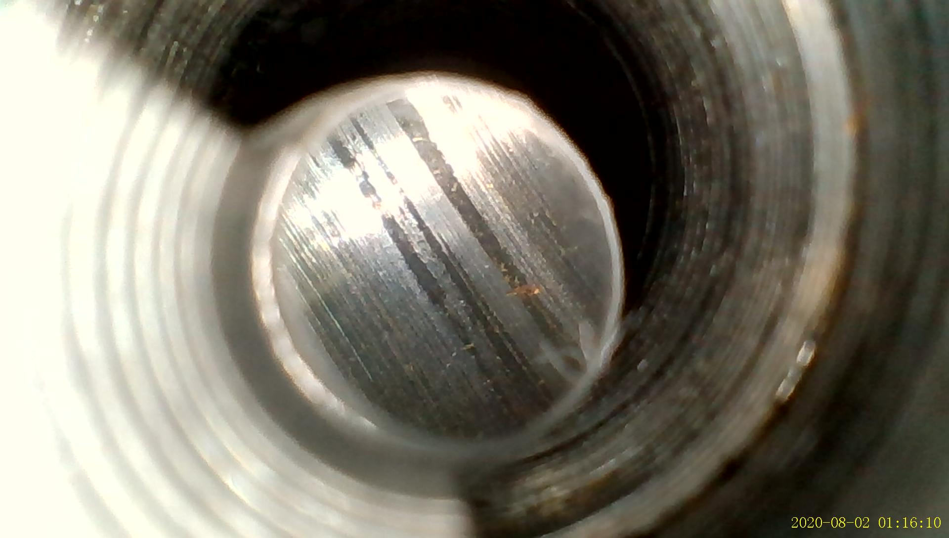

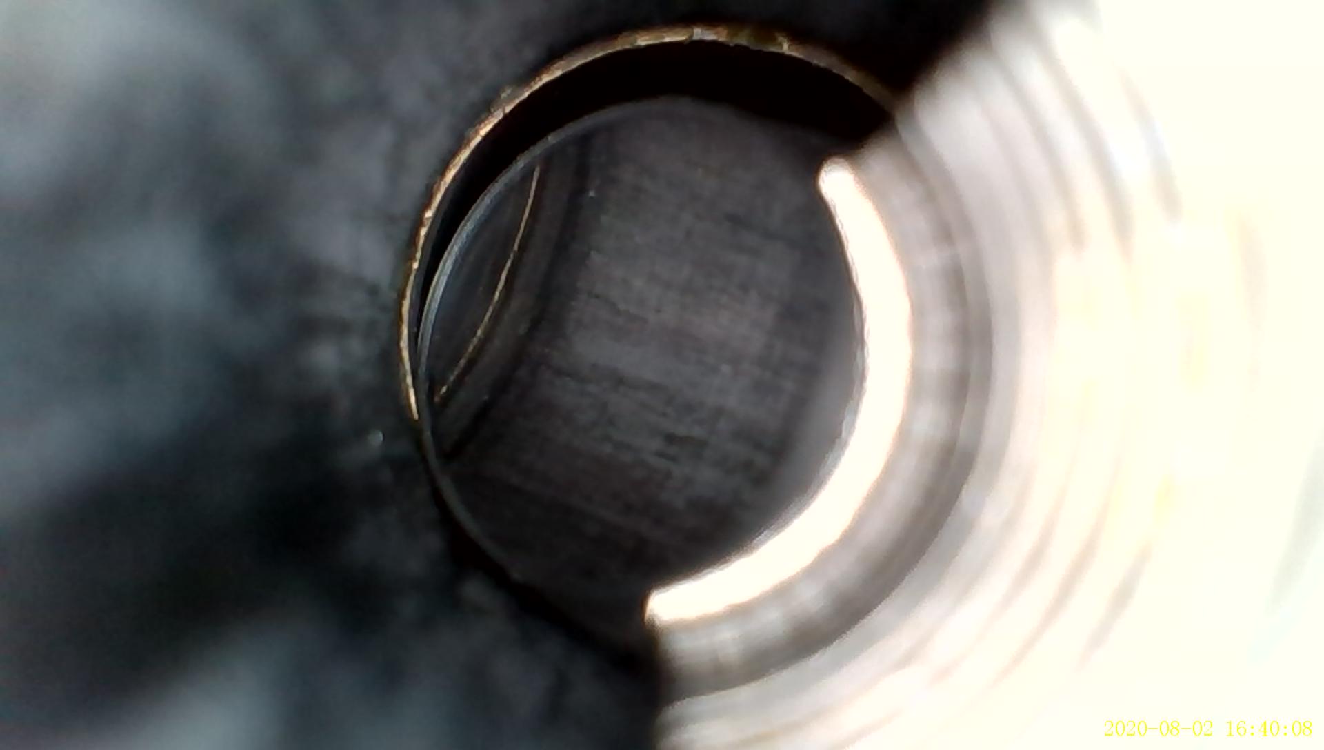

    Ok, got some more pics but I think my Teslong is defective. Note in the pic I posted originally in this thread that you can see the ribbed stem of the side view mirror and when I moved the mirror out further to get better focus, it all got a bit worse. I have talked to Teslong, they asked for pics, the CS rep said "dunno what this is, this should not be happening, I'm escalating to our engineer". So, in the pics below, please excuse the continued awful quality. They are also kind of dark as the higher the lighting the worse the symptoms of the issue.
    I tried the empty cartridge and scope from the muzzle but with a 25" barrel and a muzzle brake, the Teslong didn't reach far enough. Its a self-timing Pierson's brake and I can take it off (supposedly), but I have a clinic coming up in 7 weeks or so and do NOT want to fuck up this rifle. Be my luck that I would twist the barrel loose trying to get the brake off. Well, if that did happened, then there must be some bad juju in how barrel was torqued on so its not a very imminent danger, I think.

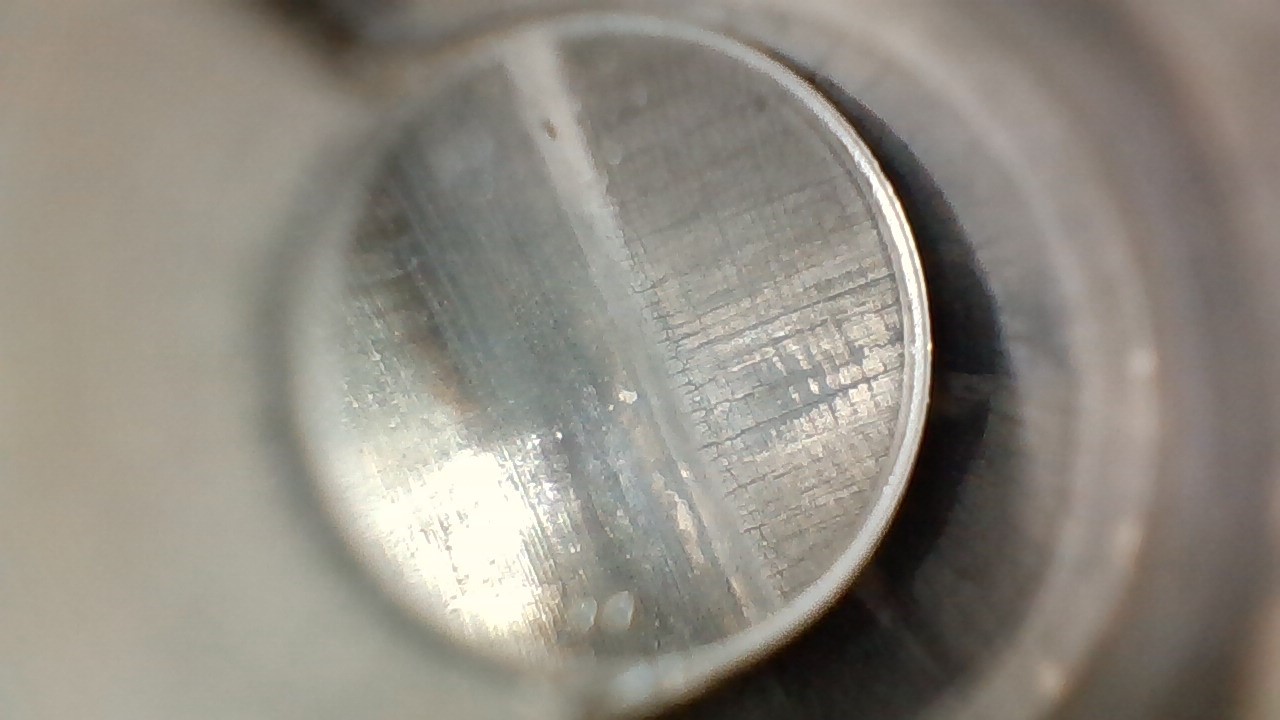

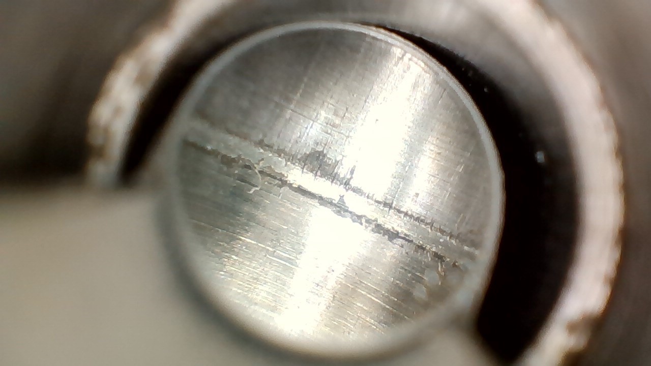

    this is the free bore/throat. Its clean
    Here is step down where the neck should end (more or less) and it is also clean from there forward into the throat.
    Here is the first "ring" which is a bit back from where the chamber indicates the end of the neck. Now, I did shoot some reloads trimmed with my friend's Gerard which was set for 1.90" instead of SAAMI 1.91" (I beleive). And, it really ain't much to worry about at all.

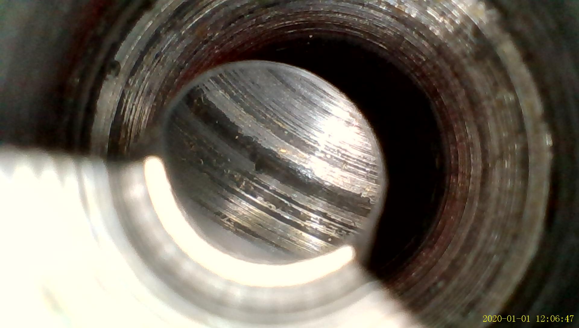

    Here are the darker rings I first posted and indeed they are further back in the chamber yet and I suspect you are exactly right that its just a bit of a dirty chamber as its not where near where the chamber indicates should be the end of the neck.
    By the by, its easy to find the step down in the chamber for the end of the neck as I can feel it with the Teslong probe. Easy peasy and Robert's your Mother's Brother (sorry, last job before I retired was for an UK company....a few British-isms stuck with me haha)
    So, I think this is showing that I don't have any immediate carbon ring problems to address. Are we agreed on that with this new data?
