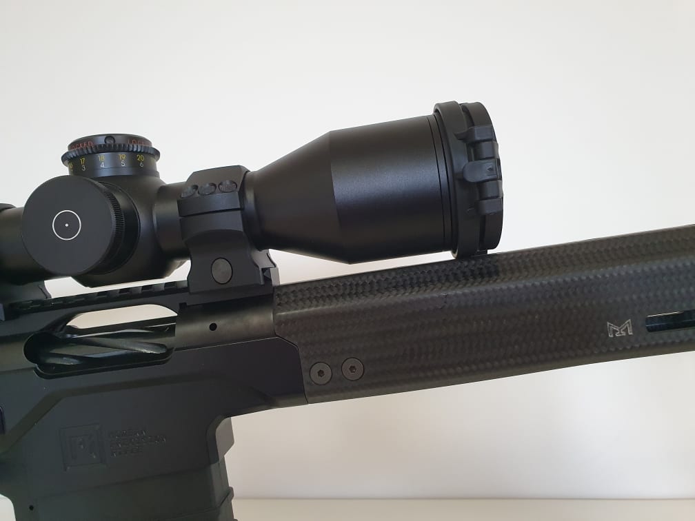

Hi all. As per title and attached image - is this something which could cause damage?
Rifle is a Christensen MPR (.308) with an Ultrashort mounted in MDT Elite (med. 1") rings. The OEM objective lens cap is just touching the (free-floating) CF handguard but is still able to be turned fairly easily (90 degrees to the right in photo) and has a little bit of give. The mounts/rings are tightened all the way down + pushed forwards, this wasn't a problem.
I've heard conflicting opinions.
Thanks.

1.
Sand down current or get new/thinner scope cap for objective
2.
get taller rings
For a more comfy upright head position, scope bell not banging stuff on recoil, peace of mind, etc
3.
Leave as is.
If it's touching the handrail and not the barrel, then it doesn't make a difference in accuracy
Which works best for you?
Personally, I don't like the idea of my scope getting ANY force from recoil other than rings. Scope bell may hit handguard. Even lightly that could be 300 rounds/times a month easily
I'd get new/higher rings. With sale of current ones, not prohibitively expensive.
Reactions: blindsheep
Since that is NOT the barrel, and it's just a free-floating handguard around the barrel... As long you're not having any issues with your scope, I'd leave it alone. It's likely not affecting anything at all, and never will. 👍🏼
Generally, there shouldn't be any part of the scope touching the barrel directly. You don't want the objective bell (and lens) slapping down on the barrel when it's vibrating from the shot! But this is just the objective cap touching the foreguard, which isn't as scary. I'd say file a bit of a groove off the cap so it can pass a paper test - otherwise the cap might still hit and work itself loose over time.
