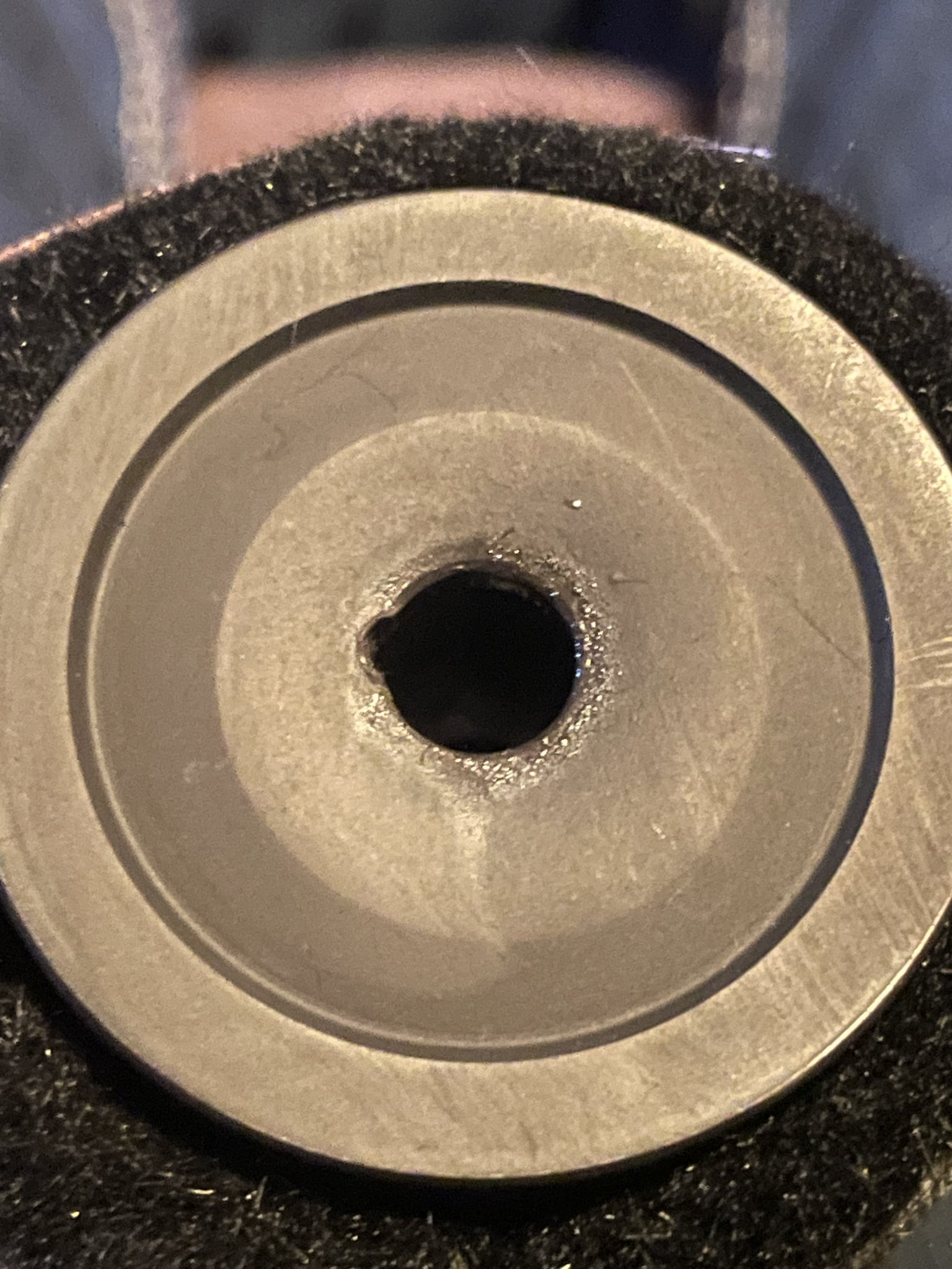

Does this affect accuracy? All other baffles look good. Can is an AEM5. Only been on two barrels. A CLE kreiger and a CLE criterion. Do not know when it happened. Just noticed it today. Maybe 200 rnds through the can.

Both barrels run the aem collar and brake. As of right now both shoot factory ammo. Either 55 grain blitzking or 69 smk’s.
I ran a .223 diameter rod down both before shooting. Rod came out center of both barrels with the can.
Both barrels are a 1-8” twist.
It happens unfortunately.
Double check your mounts & make sure the can is always locked down completely.
It’s happened here also.
My $0.02…. If you don’t know when it happened, and you haven’t noticed any detrimental effects that could have given you any idea as to when it happened, I’d say it’s not really worth losing any sleep over. 🤷🏼
Well I missed two coyotes back to back with no background splash. So after the second miss I unloaded and cleared the gun and started looking things over. That’s when I noticed it.
Went out to the prairie dog pasture the next day and hit four prairie dogs in a row so I dunno.
Shoot at a paper target
