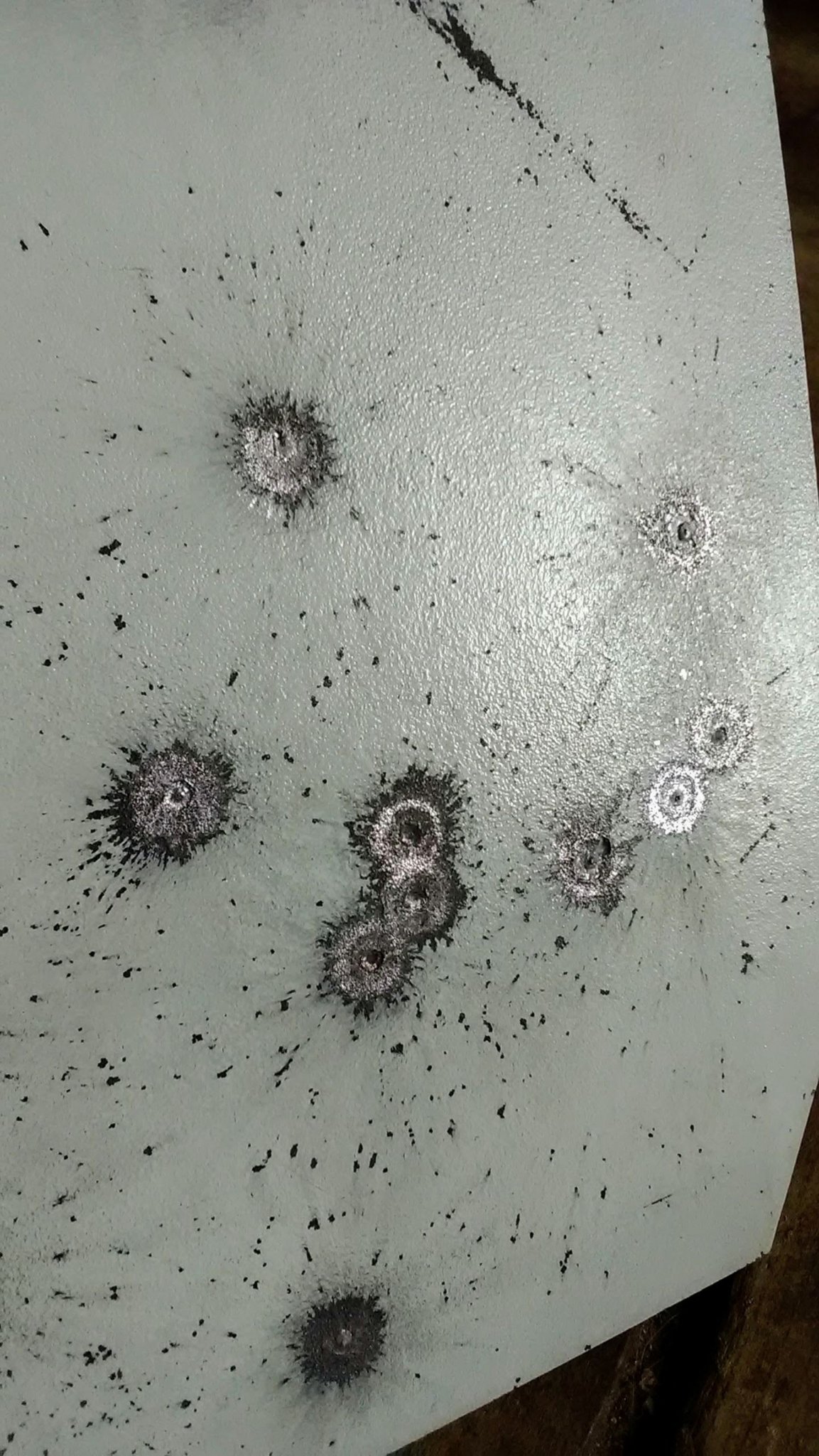

Target was shot yesterday afternoon from ~150 yards with a .223 with 55gr fmj and 50gr jhp, both federal. This is my first steel target so I was not sure exactly what to expect, in your experience is this common wear for this caliber at this approximate range?

looks pretty normal for what you were shooting and how far away it was. don't think there is much you could do other than to back up. I run soft nose 223 at 100yds some times and it'll still leave a small pock mark

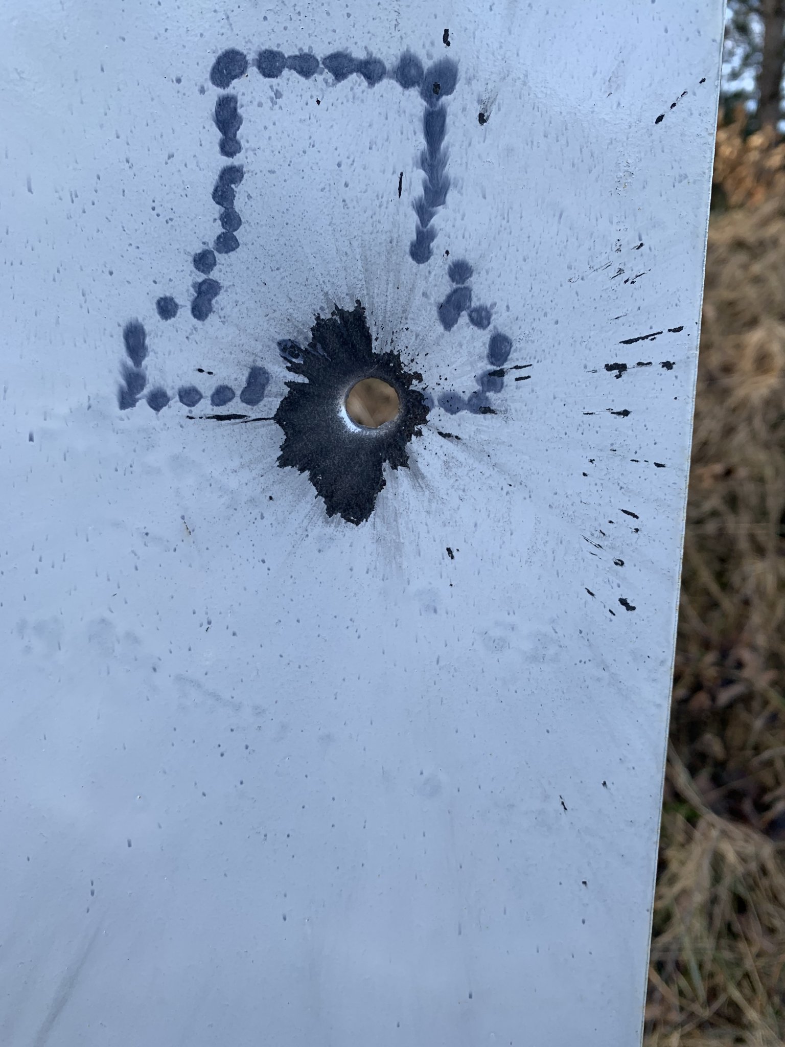

Before I knew better I shot some 1/2" non-hardened plate (mild steel??) and damn, 223 would easly go in 3/8" and 308 would almost go through. That was at 150yd with FMJ ammo. I will see if I can find pictures.

our 4 or 5 year old ar 500 plates look about the same as yours and , if they ever get banged up enough that it bothers me i have a palm sander and fine grit paper to clean them up a bit along with paint and they are new again till next time . as of yet it has never complained nor refused to hang there and take more abuse . bless it's little heart .

XM193 (~3200FPS) which is what you've basically been shooting will dent AR500, but 62gr M855 (~2900FPS with a steel penetrator) will not do anything at all.
I've seen that on cheaper steel and steel that wasn't cut properly, but at close range with a high velocity round it will sometimes do that. My MGM steel doesn't dimple and looks like new but I expect that out of a high quality american made product.

For a rifle target at some distance, a little damage like that is of no real concern. A word of caution though about using a pitted target for a close range handgun target: Those need to be kept smooth and undamaged. You can shoot a smooth, hardened target with handgun as close as 10 yards and be relatively safe (I think 15 is the recommended range, but I've shot as close as 10 quite a bit with no issues). But if you have pitting, it can cause deflection of the splatter angle and allow it to come back at you.
My MGM A500 targets that have gotten hammered for years with 556 and 762 as close as 50 yards do not dimple like your target. I suspect your target is not A500 or it was not cut using water jet method. I bought a couple targets from another manufacture a few years ago and they dimple like yours sitting next to my MGM targets that don’t dimple.
Water jet has nothing to do with it. That only effects the heat treating on the edges and it's debatable whether it matters. Fast small bullets will punch through ar500 like butter which is why you need to A, shoot at longer distances to allow the velocity to drop and/or B, go with a much thicker plate to resist the penetration and deformation. Want to really see some shit, shoot some old black tip or m885a1 through it and see what happens.
