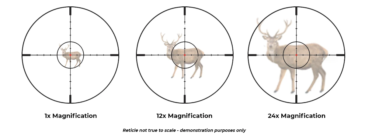

If they both look like this, then they are both SFP

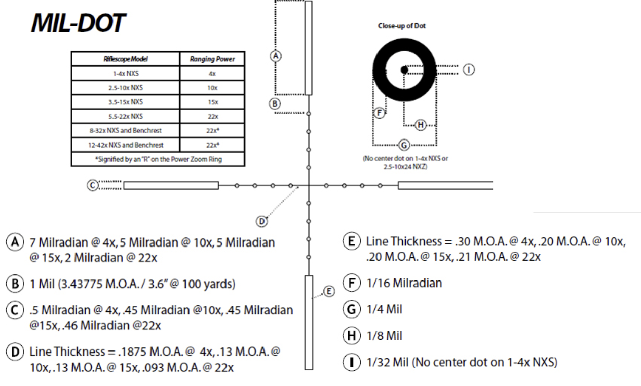

If I were you, I'd e-mail NF with the serial number and get a diagram of the reticle for each scope. This is what I could find from a link on EuroOptic for a C196, which may or may not be applicable to what you have.
