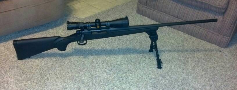

Gun: Dick's special Remington 700 adl with pencil thin 30-06 barrel. It's in a nice hs precision stock.
I started reloading primarily to save money so I could shoot lots more. I've done ocw with two powders and two bullets. Tried 6 kinds of factory ammo. I reliably get 1-1.25 moa with factory match ammo and my own ammo. The gun shoots best with relatively weak loads and is very consistent.
I'm relatively new to long range shooting. From what I gather this is reasonable performance from a cheap 700? I have a work trip this summer for a few months and am considering having the action trued and a good barrel put on while I'm gone. I know this is a loaded question, but how much of an improvement could I expect?
I'm far from an expert, but I don't believe that my reloading or shooting technique is a huge limitation. Does anybody shoot at quantico? I'd like to see someone with much more skill and experience try my gun. I'd also like to try a high-end gun with demonstrated excellent performance to see how much my skill(lack of!) is costing me.
