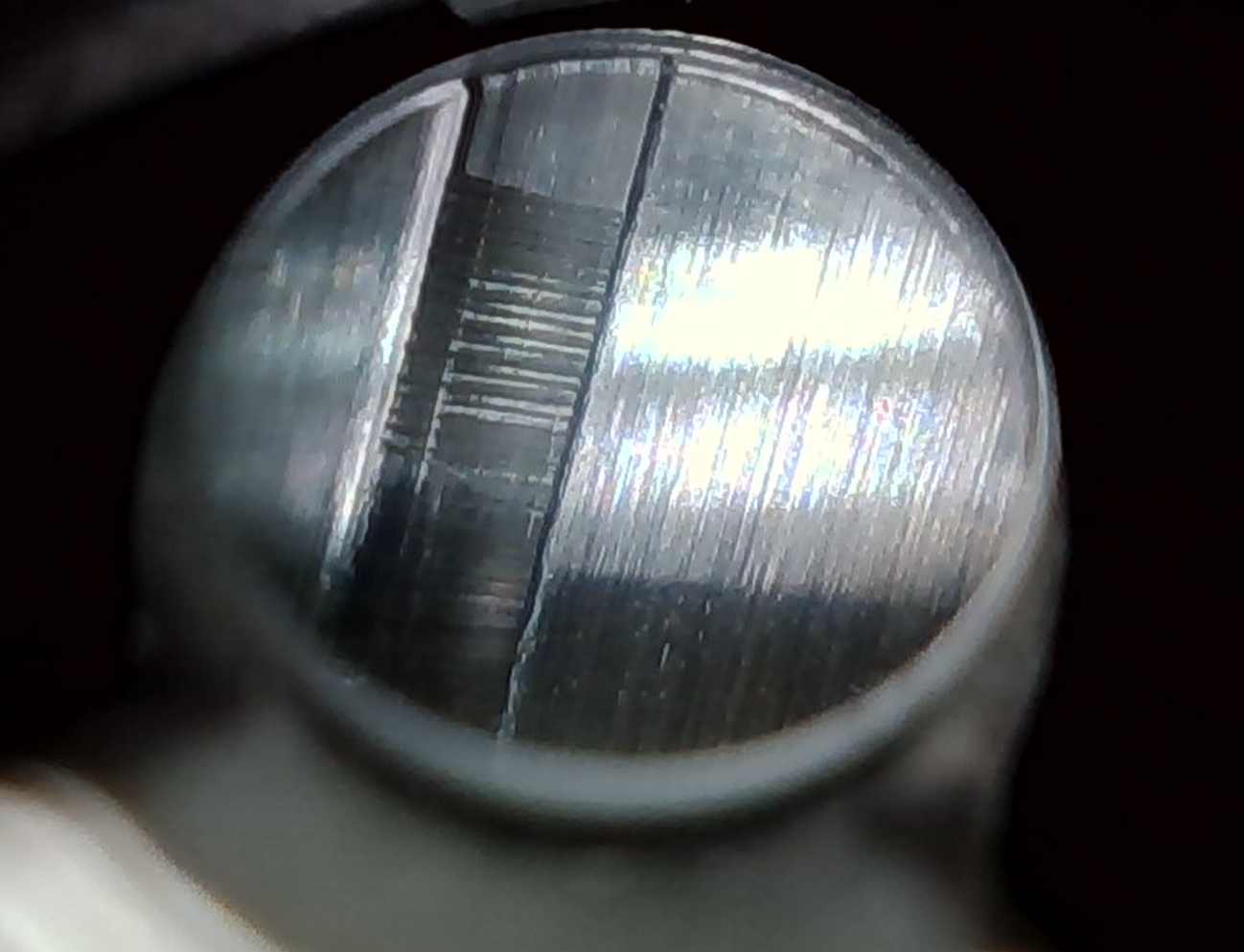

is this throat work acceptable?

I recently ordered a 308 barrel processed from a Bartlein 4 groove blank. At this point, I don't want to reveal the name of the company. But I received the barrel today and immediately examined it with my bore scope. The throat seems concerning: each of the lands at the throat showed at least some degrees of machine marks. In addition, in the second image, you can see this rifle land's transition is not smooth at all. In the third image, the transition of the two adjacent rifle lands is not consistent - judged from the bore scope, the three rifle lands' throats look deeper than the last one.
Should I be concerned and sent this back? This is supposed to be a precision rifle build. I don't think the throat is looking very good compared to my Wintac AI barrels. My 3 Wintac barrels have a very smooth transition in the throats, with no machine mark at all.

First off it would be advisable to contact who or whom you purchased the barrel from and find out what they did or how they "processed" the Bartlein barrel. That may explain a thing or two.
Secondly, borescopes tend to show imperfections that are minimal in their effect on accuracy.
Thirdly, if what you are concerned about, truly originated at Bartlein, Frank Green most likely will address the issue in a clear, concise and professional manner.
Fourthly it is considered 'Bad Form" to air ones grievances in a public forum prior to addressing the matter with who/whom most likely has the ability to make things right.
And Fifthly (is that even a word?) the barrel is pure crap, not worth the trouble even to use it as a handle on a bottle jack to jack up your car/truck. Your need to send it to me right away before the poor workmanship of it infects all the other firearms in your gun save. Bwahahahaaaa, just kidding you should be fine with what you have. Don't consternate over what is not important.
Borescopes are great ! What other tool known to man could do such a great job of facilitating a self fulfilling prophecy ? :rolleyes:
In other words, you've looked, you're now bothered by what you (think you) see, but you have yet to shoot it ? How much do you think your (now) pre-existing bias is going to affect your ability to shoot the barrel accurately ?
I've got news for you, the majority of my barrels (Bartlein, Kreiger and Lilja) look a lot worse than yours, but they all shoot lights out. Funny thing is, I shot them all (and established highly accurate baselines) before ever even owning a borescope. Once I did look, I thought "huh, I wonder if what I'm seeing is affecting the barrel's accuracy ?" (That's sarcasm BTW).
Do like many others have done and put your borescope in the back of the bottom drawer of your toolbox to gather dust and just go shoot the barrel. Sadly, borescopes have helped to create a lot of boogeymen when/where they didn't previously exist.
I would disagree with you. I own 3 Wintac Bartlein barrels for my AT and one factory AI 308 barrel that came with it (I believe it's made by Lothar Walther). None of these barrels have a throat cut like this. All these barrels with AI logo shoot lights out (sub 3/8moa). I got this one about the same price range and also made-to-order, so I don't think being a little upset and concerned about this situation is me overreacting.
also I don't think it's wrong to at least see what people think of this before reaching out to the maker, because who knows what they'll say? I have had the experience to be fooled by someone who blames me for something he did wrong. That's why I post this here. If this throat is not good to the opinions of gs here, I will request to send it back at least with some ideas. otherwise, I will keep the barrel and no drama.
BTW, thanks for the suggestion from another member, I have reached out to Frank and am curious to see what his opinions are.
Reactions: Baron23
I will never own a bore scope. The only way to ever know is go shoot it with quality ammo or work up a load if you roll your own. Over many years of loading for some different calibers their are always 2 or 3 go to powders to use for each caliber to use. Some good quality bullets seating depth and power charge will let you know what's going to work best.
Reactions: 338dude

Pic 3 is slightly concerning to me. If it were mine I would contact the company or person that chambered it and just see what they have to say. It may shoot lights out but I would just see what the opinion is and go from there.
Not questioning your opinion, but if it did infact shoot lights out, exactly would you be after? It just seems to be more expedient to shoot it, result crap, THEN take your concerns of the chamber AND the fact it is shooting sub par to the smith.
Unhappy with the machining, don't use his services again, whether it shoots or not, but if it shoots why fuck with it?
Thats a bummer. The throat being "off-center" is the most concerning part. If the barrel is off the action, try to drop a factory 308 round in it. It SHOULD drop in fully......or at least until bullet/throat contact. Typically, when throats/chamber are off-center they won't allow a round to drop in and out freely.
I've also seen throats off enough that you can literally look through the bore and see the end of the freebore "edge" that gets thicker on one side and disappears on the opposite side. Or you can clearly see a rifling land the reamer freebore should have removed. In my experience, these problem chambers are really finicky to load for and can cause bullet blowups (on more sensitive jacket bullets.....i.e. Hornady).
I don't think any builder is above a mistake, I know I am not. So give them the chance to take care of you and move forward.

With one land showing slightly longer or shorter than the other three I would be concerned that the chamber is just slightly off center. I have a barrel like that I'm running now and have never thought that it shot to the full potential of the barrel blank. But, it could just be me shooting it and thinking that it could do better.
I think that the centerline could be verified to be inline with the bore with the proper measuring tools. You might want to ask your gunsmith if he would be willing to reverify it for you. Mistakes happen.

How eccentric does the chamber have to be before it starts to affect accuracy?
Reactions: 338dude
That is the golden question. There are too many variables to say for certain. I have been in too many arguments on here to take a side. I will say that you will never convince me that an off-center chamber/throat/freebore/whatever will shoot BETTER than a straight one.
Not a true "measurement" but I will say that any off-center amount that doesn't allow a factory round or a good reload to go in/out of a new/clean chamber easily has a good chance of effecting accuracy.

A good gunsmith who takes his time will cut a visibly concentric chamber that will make the customer happy.
How concentric to you want your ammo to be .002/.004/.006? It seems these would go hand in hand. Concentric chamber combined with concentric ammo should produce good results.

You do realize that the reamer itself defines concentricity, right ? (assuming that the 'smith has dialed in the bore to the lathe with the minimum amount of runout).
If the bore of the barrel is not dialed in to the headstock of the lathe properly, that's about the only way to get a chamber that's "out of concentricity". And, even that's difficult to do.

That is incorrect.
Even a mis-dialed in barrel will not end up like the above.......the reamer will just act like a boring bar and cut a larger hole (Another issue I have seen regularly, look at the amount of swell just above the case web). Assuming you are machining in a traditional way (spinning barrel and dead reamer).
A grossly undersized pilot may have been an issue here but I doubt it. Bore sizes are a known and very consistent in a Bartlein. You can pretty much guarantee a great bushing fit in a Bartlein by going .0002-.0004 under land size.
The chambering issue above is common (especially in 5R) and can be minimized with particular methods while chambering. Nuff said.

Ern, Don't see issues with the 5R or any other type of rifling that we chamber barrels here etc....
The OP's barrel is a 4 groove.
Also Ern you are correct our bore sizes are very consistent. Thanks for the nice comments!
Later, Frank

Borescopes are good and bad.....Most people don't have a clue as to what they are looking at. Just last week we had two different customers call us complaining about pitting in the bore or porosity in the steel. One guy wanted us to have the barrels shipped back on our dime just for us to look at them. We got in almost heated argument over it and told him no pitting or porosity in the steel. You don't know what your looking at!!!!
Told both guys to run a couple of patches down the bore and look at them again. So both customers where stand up in the end...they called us back and said sorry! All the pits where gone after they patched out the barrel. Just dust/lint or solvent in the barrels.
Pic 1 are what I would call bushing marks from the pilot on the reamer. Are they bad? Hard to say. Might look worse then what they really are.
Pic 2 and 3. Again I don't have the barrel in front of me...so hard to say if it's how the borescope is being held/indexed but it would appear that the throat doesn't stop in the same spot on the lands. Also it looks like the reamer is starting to leave a burr in the throat as well. Could've been in the set up....causing the issues and or how the reamer was ground or how many times has the reamer been used.
Pic 4 kind of goes back to pic 2. How the reamer was ground or how many times it was used leaves the finish questionable looking.
Before you shoot it...I would call the gunsmith/shop up and talk to them before you do anything.
Next step would be to shoot it. If it shoots good and the barrel doesn't foul bad etc...don't fret over it too much. The throat area of the chamber is the only thing you break in on a good barrel. The reamer cuts opposite direction of bullet travel. The nicer the reamer cuts (nicer the finish) the faster this area polishes and breaks in / settles down etc....
If it doesn't shoot good and you have fouling issues....then you have problems for sure.
Give the gunsmith a call....that's the first stop.
Any questions or problems give me a shout.
Later, Frank

Thank you, Frank and everybody who tried to help here! I reached out to this company last night, and this morning I heard back from them. Apparently, the owner of the shop was not happy after seeing those pics. He wants to take this barrel back and apologized for this situation. I'm going to send this barrel back today after work and see how things go from there.

I totally understand your point, Frank. I've look through a lot of dirty and high-mileage barrels using borescope. Trust me, I can tell the differences. Compared this barrel with my Wintac bartlein barrels that I knew were made right, I found that the throat on this one look nothing like those, that's why I asked for opinions in the first place. My 6.5x47 lapua Wintac bartlein barrel has ~2200 rounds through it and has some degree of throat erosion. BTW, the accuracy is still amazing. However, even with all the firing cracks+carbon fouling, this used Wintac barrel throat looks better than the one in the pic. It is not visibly crooked or full of machine marks at all, just firing cracks.
The amount of cash I paid for this barrel is enough to buy a new, nice hunting rifle, so I want perfection. If it's a 100 dollar barrel with same issues, I won't care a bit.

Your welcome Frank, just being honest about Bartlein's consistency.
I agree there is nothing wrong with a 5R barrel, in my experience they need to handled a little differently when chambering. This may very well be an issue I see ONLY with my chambering setup too.
I only offer my opinion because I used to have the same issue unknowingly...... then it hit me square in the face and I figured out a better way.
Gee....bet you're glad you didn't listen to the "just shoot it crowd".
I'm glad the smith is a stand up guy and will...hopefully...make you 100% whole on this deal.
