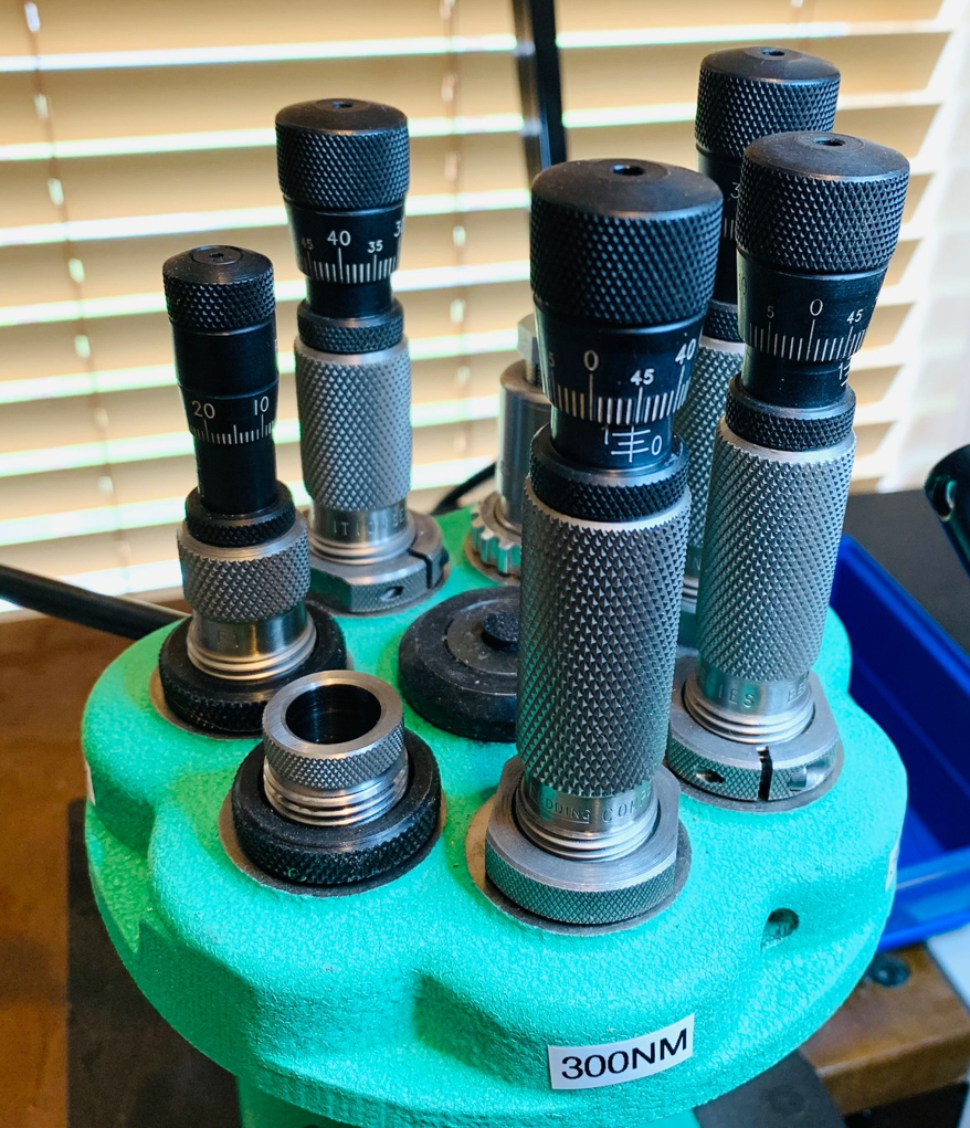

Yup ... pretty darn accurate ... I use the Redding Competition Micrometer Seating Dies for 6.5-CM, 300-WM, 300-PRC, 300-NM, and 338-LM. The thing that's not so repeatable is when I come back to them after days or weeks for a new batch. I always tune back a hundredth or two and retest to find the exact seating depth I'm looking for. But once there, it works through the whole session and adjustments are very accurately. I dial a 2/1000th's change, reseat, and I get 2/1000th's deeper measurement on my comparator.
Pretty much. I use Redding too.
I do get COAL SD of 2-3thousands so it takes few rounds to confirm but it is there.
The best test is to do a full turn and see how much it changes, much easier that way.
And when compressing, things get complicated.

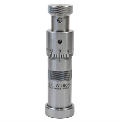

Is your seating die micrometer accurate, not repeatable/consistent, accurate? When you move the micrometer .003 does it move the bullet depth .003?
My Wilson seating dies are very accurate. But, you know, a lot a variance can be induced with the neck tension isn't consistent or the seating is quite tight. Since I anneal my cases after every firing, I get very consistent/repeatable seating with my die adjustments, and the adjustments are accurate.
I do anneal after every firing and set neck tension with a bushing die to control neck tension the necks are also lubed with graphite. I do get pretty consistent seating depths after I get the die adjusted which isn't hard just a little fine tuning to get it right.
The issue I had is related to doing a bullet seating test. I wanted to extend the die out about .040 so I dialed in .050 assuming I would dial it back down to get my starting point, well it only moved about half of that amount so I dialed another .020 to get it out there and then started working it back. Scratches head but oh well.
Then as I'm running the test it is going good moving very close to .003 with each .003 adjustment until about the 6th move then I moved .003
and it only moved .002. It repeated that for the next 3 moves. It seemed to help if I tapped on the top of the die lightly after making the adjustment.
I've had this die apart before but I don't remember any floating parts in there that might be sticking. After I get this test done I'll likely take this die down again and see what I can determine.
The Wilson dies do seem like the hot ticket for repeatable accuracy.
Wilson dies have an adjustable seater stem. The setscrew that keeps it from spinning sometimes comes loose and then the micrometer spins but the seater stem doesn’t move. Maybe that’s the issue.

I use Wilson Micros exclusively with an arbor press and am very happy with them. I get +/- .001" or .0015" variation, but I'm not seeing that it's affecting anything negatively.

I use the Redding micrometer seating die and it works pretty damn accurately.....003" dialed gives me .003" of depth. I pitched the sizing die that came with the set in the trash....they are apparently not vented and dent brass unless you play games and fuss about lube.

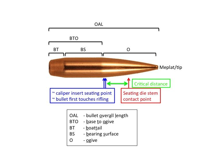

My point was that you have a variance in the bullet between the spot you measure on the ojive and the place that you seat from on the tip area. Even if the ojive relationship was perfect between two bullets the variance between the ojive and the tip could be moving the measured seating depth because the tips have a variance between the two bullets. By measuring at the ojive and seating at the ojive you would remove one variable.
The ogive is the entire curved surface from where the bearing surface ends to where the meplat begins.
If you want to sort by the difference between your seater contact and the comparator contact then you can use the bob green comparator to do so. It measures this “critical distance”
You can shape your seating stem to whatever profile you like for it to contact your bullet wherever you want. I shape all my seating stems with a sacrifical bullet and lapping compound
I have lapped my seating stem as well but it still isn't going to contact the bullet on the ojive comparator contact point. I guess you could get a comparator that would measure from the seating stem contact point, that may be the easiest way to maintain consistent contact points.
I'll have to look into that a little more I don't think he is doing what I'm trying to describe but the BGC is purely for comparative measure of ogive radius variances.
I want to measure and seat from the exact same spot on the ojive. That only leaves the variation in that one spot on the ojive as the determining factor in seating depth. Aside from neck tension, lube, seating speed, etc.
The way I see it, BTO is simply not important. It's the CBTO than can be important for those who want to seat their bullets into the lands. And of course, it's important for a CBTO when one is first deciding a just where one wants their jump starting point (the mag length being an issue), then working the seating depth for tuning the load. (BTW. many newbies are confused by the the difference between BTO and CBTO as these are often used interchangeably in thread discussions)
Since seating depth, is so important (like reloaders will adjust in .003 increments to tune the load), having the base of the bullet seated at the same depth in the case goes a long way in making the load consistent since that's what effects volume in the case for the particular powder charge. If one is only measuring BTO, then that "critical distance" can produce significant differences (like .003 or more) depending on the quality the bullet manufacturer has for them or that of the particular lots.
In measuring different bullets, I was surprised by the large amount of variance between the seating stem contact points and the Meplats, which play a major roll in the bullet's OAL and the COAL measurements. Apparently, the molding or tipping process, however that's done during manufacturing, induces a lot of variance there. Of course, the OAL is just a net measurement of all the sections of a bullet as shown in your picture.

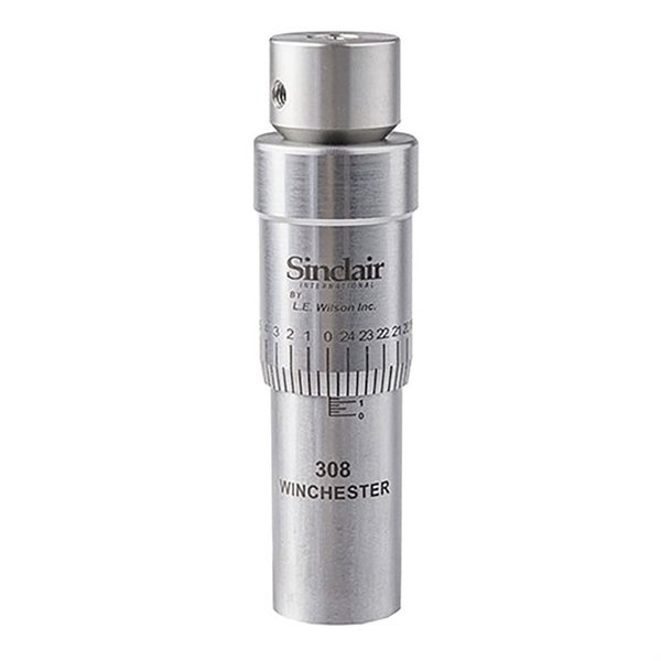

FWIW, I borrowed/tried using a Wilson in-line micrometer seater and arbor press for a while to seat bullets (to compare the against the Forester) and it was a wash for me, the Wilson/Arbor method was just slower and more annoying. YMMV.
