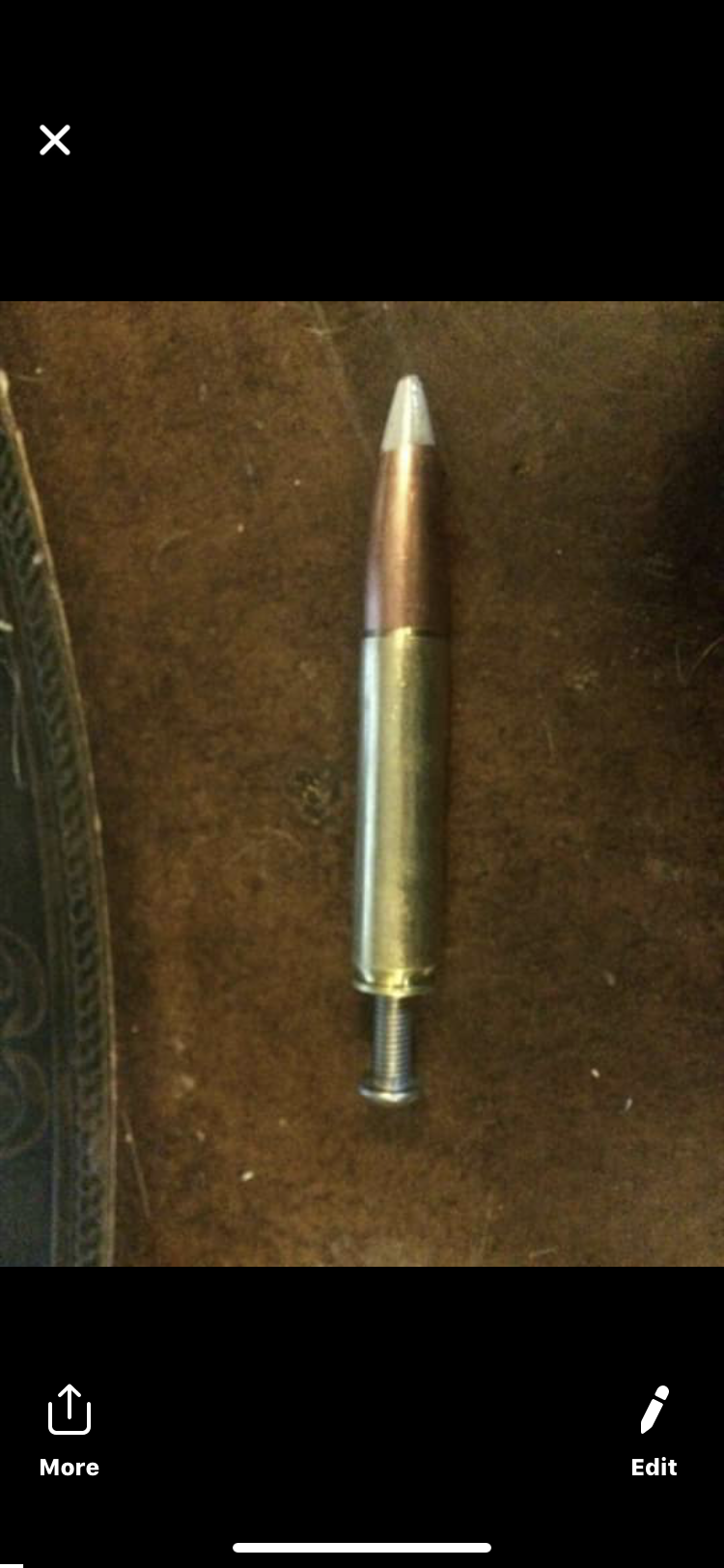

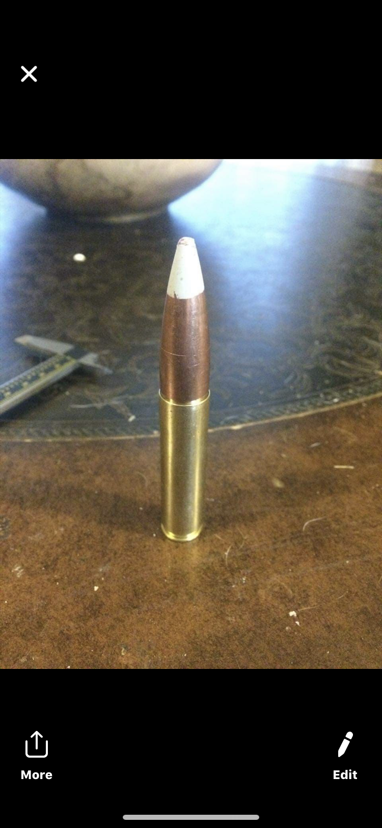

A friend uses 50 AE cases to shoot 50 BMG pills at subsonic velocities. He said he wanted more range in a standard gun.
After digging around through reamer prints it looked like the 50 Alaskan might work. For the cases I uses 300 RUM cut off at the length as the 50 Alaskan. With a 50 BMG bullet it will feed from a standard long action. Using cast bullets, I found some 950g, it will feed from a short action.
It was a go until the other guy decided that the recoil would be way too much. The screw in the bottom of the case is to push the bullet out. During seating if I would have went too deep I had no way of getting it back out without destroying something
