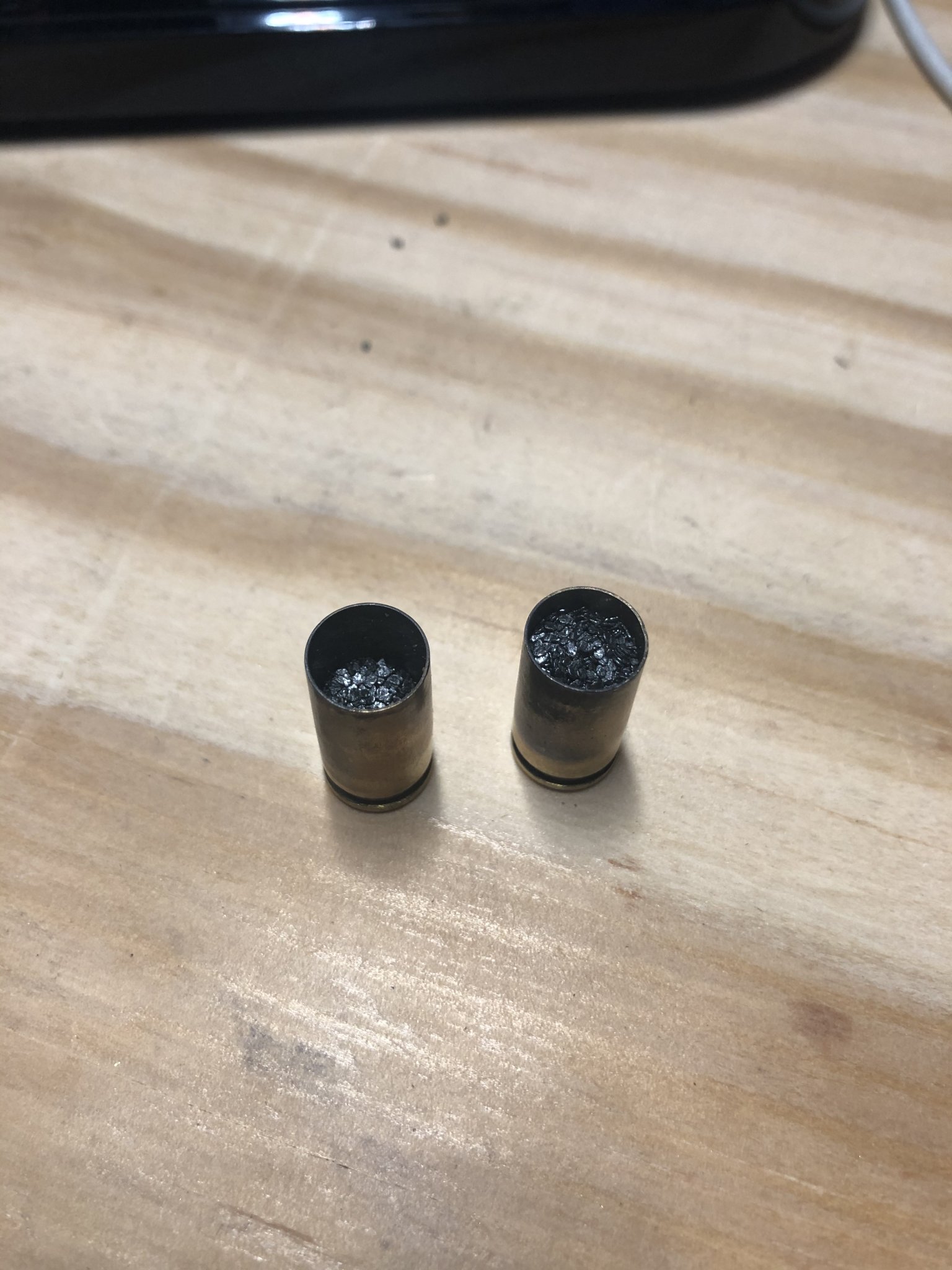

And quite a bad idea at that. Last kaboom I saw was a guy who loaded up his CZ racegun with max load Titegroup and subbed small rifle primers. Blew the extractor out of the gun and both grips cracked. Further inspection showed a cracked chamber. It is unlikely this was a double charge... the 9mm case isn’t big enough to hide it.

You say, "quite a bad idea" and your example is a dumbass who's loading at, or above max charge weights and then changed primers without reworking his load. That could happen by just switching primer brands, let alone types of primers.
The 9mm case is definitely big enough to hold doubled charges of Titegroup and it doesn't matter if it "hides" the charge, if he doesn't catch it then its easy to get in there. I'm assuming by having a CZ racegun he's shooting competition and probably has a Dillon 650/1050 or some fast progressive press, which makes missing a doubled charge that much easier.
Theres HUGE difference between your example, and working up middle of the road loads with SRP vs SPP.... Not to mention every guy on this thread who's talked about using SRP in pistol calibers, including myself has said to work the load just like every other load smart reloaders work up. And I specifically said myself that it would be unwise to run max loads with anything other than the book suggests.
Attached is a pic of a 9mm case with 4.5gr of Titegroup, which is the Lyman Book max charge for 115gr bullet. The second pic is double that, 9.0gr of Titegroup. Thats at the max charge with only 115gr bullet. If you lower that to 3/4 charge, or put a 124gr bullet in there, it gets even easier to double charge it without noticing.
Just trying to put out accurate info...

You could easily fit a triple charge of TiteGroup in a 9mm case, and double without noticing at all....even with 115gr projectiles. I put so little in for my 165gr projectiles I have to double check to see if there’s anything in the bottom before dropping the projectiles on there.
I know my light loads with .38's and Titegroup, I check every single case. At 3.0gr of Titegroup, I think I've gone 4-5 times doubled before I filled the case...obviously that was just setting up my powder measure.
9mm case capacity point well taken. I can see the difference easily enough,p. I imagine a 357 mag case it could get 3-4 charges of Titegroup and it wouldn’t be noticeable at a casual glance.
