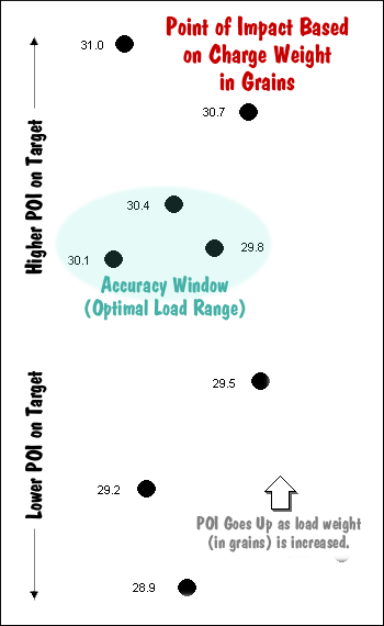

Typically what i see for standard load development is some sort of OCW test where they go form min to max charge and find nodes or flat spots in velocity. So they are tuning a specific bullet to exit the barrel at consistent speed and at the optimal time in the barrels harmonic wave. Then once they have found their optimal charge weight they do seating depth. Usually in .003-.010 increments and find the seating depth node, then if that has low sd/es and a good group thats their load. But the problem for me is If you have already found an optimal charge weight at a specific seatting depth lets say Jam -20k or 10 thou off lands what ever seating depth used for OCW then if you change that is it not going to change pressures, velocity, harmonics? If you change seating depth that changes case capacity, jump, jam, pressures and velocity. So if you already found the best velocity for lowest vertical dispersion isnt changing seating depth going to change your velocity and in turn change when ur bullet leaves the barrel? so what point is there in doing some sort of OCW test if seating depth change is going to change when the bullet leaves the barrel, other than for pressure test? So why not just charge cases with a safe ammount of powder and do alot of seating depth test and never change powder charge, just stick with the same one given no pressure signs? What do you guys think of this because i find it hard to belive that charge weight is vertical spread and seatting depth is horizontal spread.
Not sure where or who says powder is vertical and seating is horizontal. That’s nonsense and is likely something passed around from times we didn’t understand as much as we do now.
The only affect powder will have on bullet placement is:
At distance as it’s basic math that a slower round will impact lower than a faster round. The key in loading is to keep the ES small enough for the desired target size and distance.
When using to time the harmonics. This happens when someone picks a seating depth and then uses powder charges to adjust group size. It can work, but I prefer to pick a powder charge and then adjust seating depth to reign in the group size.
Unless making some extremely large seating depth changes, you seating depth won’t change capacity enough to screw up your powder charge. Basically if find a charge weight that has 2850fps and 15 ES with .020 jump, it will still have 15 ES and 2850 with .060 jump.
I personally use a chrono to find my powder node without using any groups to analyze. Then I use the chosen powder charge and find a seating depth node.

I just completed load development with a new 6.5-284. I have found that changes to jump/COAL produced a much larger difference in pressure/velocity than I would have expected:
156gr Berger EOL
57.5 Retumbo: 2975, 2986, 2990 (ejector mark)
Same Charge weight with COAL increased .043:
2917, 2914, 2922
Reactions: Bbracken667
Everything can affect everything, to an extent. In GRT if you change seating depth in a Dasher by 0.020" it changes velocity by 8-10 fps. Certainly it is well documented that choice of powder, primer, and brass can change group size, POI, and velocity spread. If you read Tony Boyer's book he talks about tuning both seating depth and powder charge together, because they are not independent variables.
However, he had the advantage of using a cartridge with a vast amount of collective experience, so he was searching a pretty small space. If we tested everything then we would burn out our barrels before finding an optimal load. As DThomas noted, if you are using a reasonable cartridge with high quality components, then things should tend to work pretty well.

I think the vertical is powder and horizontal is seating is being misconstrued from ladder testing/positive compensation goals (whether you abide by this theory isnt my point, just attempting to explain the phrase)
You tune the powder so that you find where the charge weights tighten up on the board at distance. That takes care of the vertical.
And then you tune the seating depth so that the groups themselves shrink down, that takes care of the horizontal.
1) OCW has nothing to do with any "velocity node". OCW maps gross barrel movement in a sine wave pattern. There will be a point where 2 or more groups in a row will have the same POI in relation to the target.
2) Seating depth maps another harmonic all together. As the barrel is whipping up and down, it is also vibrating in an eliptical pattern and the bore is dilating in and out like a nervous sphincter. Seating depth tunes this harmonic. When doing seating depth, you will notice that the actual center of POI changes very little, if at all, while your groups will elongate and contract.
3) In my experience, the good powder node almost always shows up between 1%-2% off of max pressure. This means that the powder is burning within it's optimal pressure range for a clean, full power burn, and is not hot enough to get pressure spikey when the temp gets hot.
4) There have been some fairly interesting tests done and published on PRB that there is usually a very narrow seating node around .010" off the lands. It is often the best performer, but also the narrowest and finickiest.
5) That same experiment found that there are most often far wider and forgiving nodes starting at .060" off and extending to .100" off. Though they tend to be less accurate overall.
I thought OCW stood for optimal charge weight. Charges that impacted in the same place on a target, therefore identifying a velocity node.
It does stand for Optimal Charge Weight, but velocity isn't the primary indicator.
If it was, then you would be doing it with a chronograph and looking at numbers rather than looking at the paper.
Your problem is that you do not understand the fundamental point of the Optimal Charge Weight method.
The point is not, as you think, to "tune a load to a consistent speed and a the optimal time in the harmonic wave".
The point is to find a range of charge weights (and by extension muzzle velocities) that will create little to no change in point of impact on target. One then selects the mean of that charge weight range (where the load is most resistant to changing POI with MV variation) and then proceeds to adjust seating depth to reduce group size.
Of course changing seating depth is going to create small changes in MV. But since those changes in MV are occurring within a range that has little to no effect on POI, the end result is an optimal load in precision AND accuracy.
