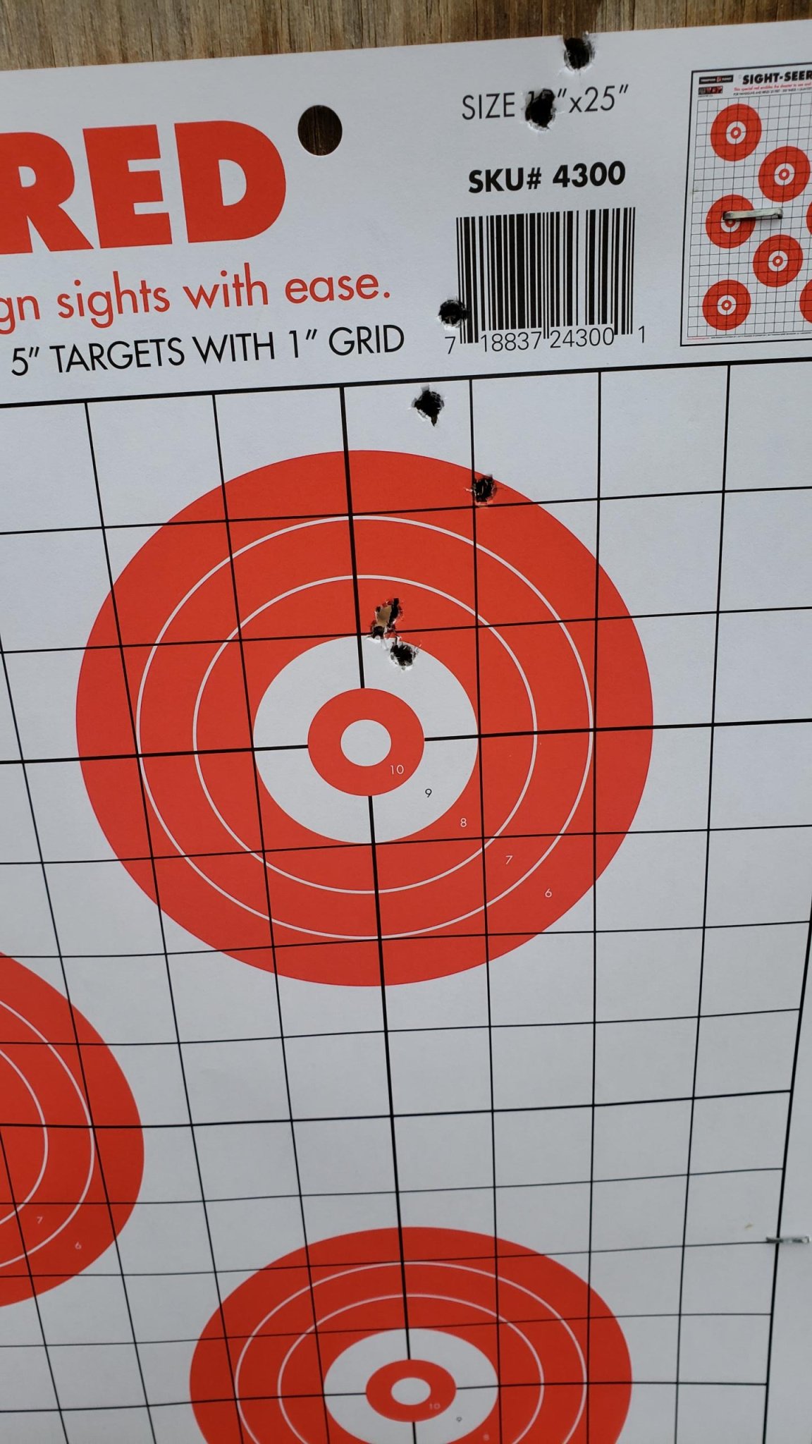

Anybody having issues getting their B14 Trainer with Carbon barrel to group with a suppressor? Recently just picked up a Bergara B14 on a sale. Had it out yesterday for the first time and noticed very large POI shifts while running the can and poor accuracy (2-3 MOA). Unsuppressed the rifle shot great. Issues were present across the three types of ammo I tried (CCI SV, Eley, SK) the POI shift was high which I thought was a bit strange. I only had one can with me (Silencerco Switchback) but I run it on all my other rimfires so I doubt its an issue with the can. I'm assuming the problem is with the Carbon Tension barrel. Just wondering if this is a common known problem with them or did I just win the unlucky lottery? I did run across an old post from ORKAN (primal rights) where he mentioned similiar issues with the carbon barrel.

Agreed, I own and shoot lots of different 22s, suppressed and unsuppressed but this one takes the cake. Its obviously something is happening outside just normal "harmonics issues". The lower group is unsuppressed, the five founds running vertical are with the can "on".

Where did I say they are junk barrels? Maybe you should re read the post. It's an honest question if it's a known issue with tension barrels and cans? Thru some additional research it doesn't look like my issue is all that unique. Luck of the draw I guess. I have lots of cans and lots of rimfires, this one is the worst that I've tried with a can by far. Without a can it shoots very well. I've tried two different cans on it, same result. POI SHIFT isn't a big deal if repeatable, but the horrible groups are. Mostly vertical dispersion, not a random "splatter" type group.
