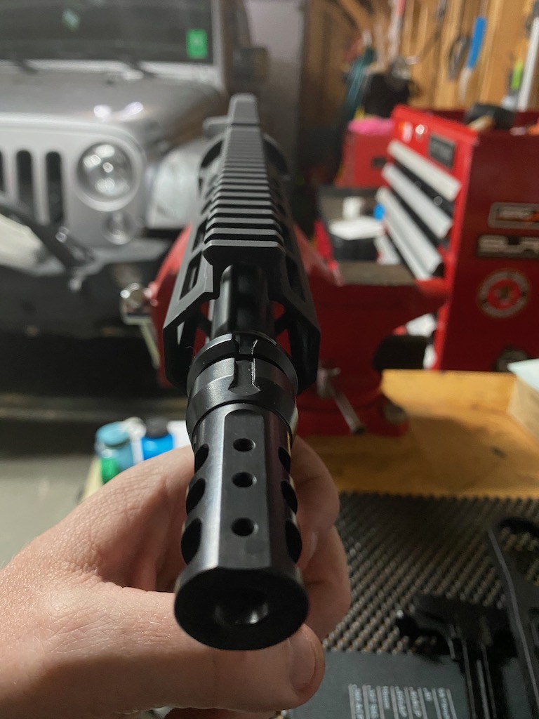

Has anyone had issues with the shim package that comes with the dead air muzzle brake? For the life of me, I cannot find a combination of shims that allows to me to install the muzzle device so that the ports are aligned facing upwards. I can get it off-center, but not dead center.
Pick a combo of shims that gets you closest but it still slightly too large. Then lay a pieces of sandpaper on a flat surface and place one of the washers on it and move in a figure 8 pattern until its the right thickness, check periodically with calipers.
Just did it on a muzzle brake for a friend, took about 5 minutes.
Manged to line it up with the big washer, a medium, and the thin washer.
Reactions: Sheldon N
I use 120... But I think anything between 100-600 would work fine.
Just go slow and use the same pressure for each pass. I turn the break every 3 strokes.
Blow out the threads then recheck alignment. You want the break sitting at 11oclock before you torque it down.
I never use anything like thread locker
Do you recommend sanding the brake over the shims?
Just depends on how far it's off honestly. If I thread it on and it's off between a 1/4 turn, I usually use a combo approach and use a thin shim first, recheck and if it just needs a hair of sanding too be perfect, I'll take a couple passes at it so that it's square with the one shim
