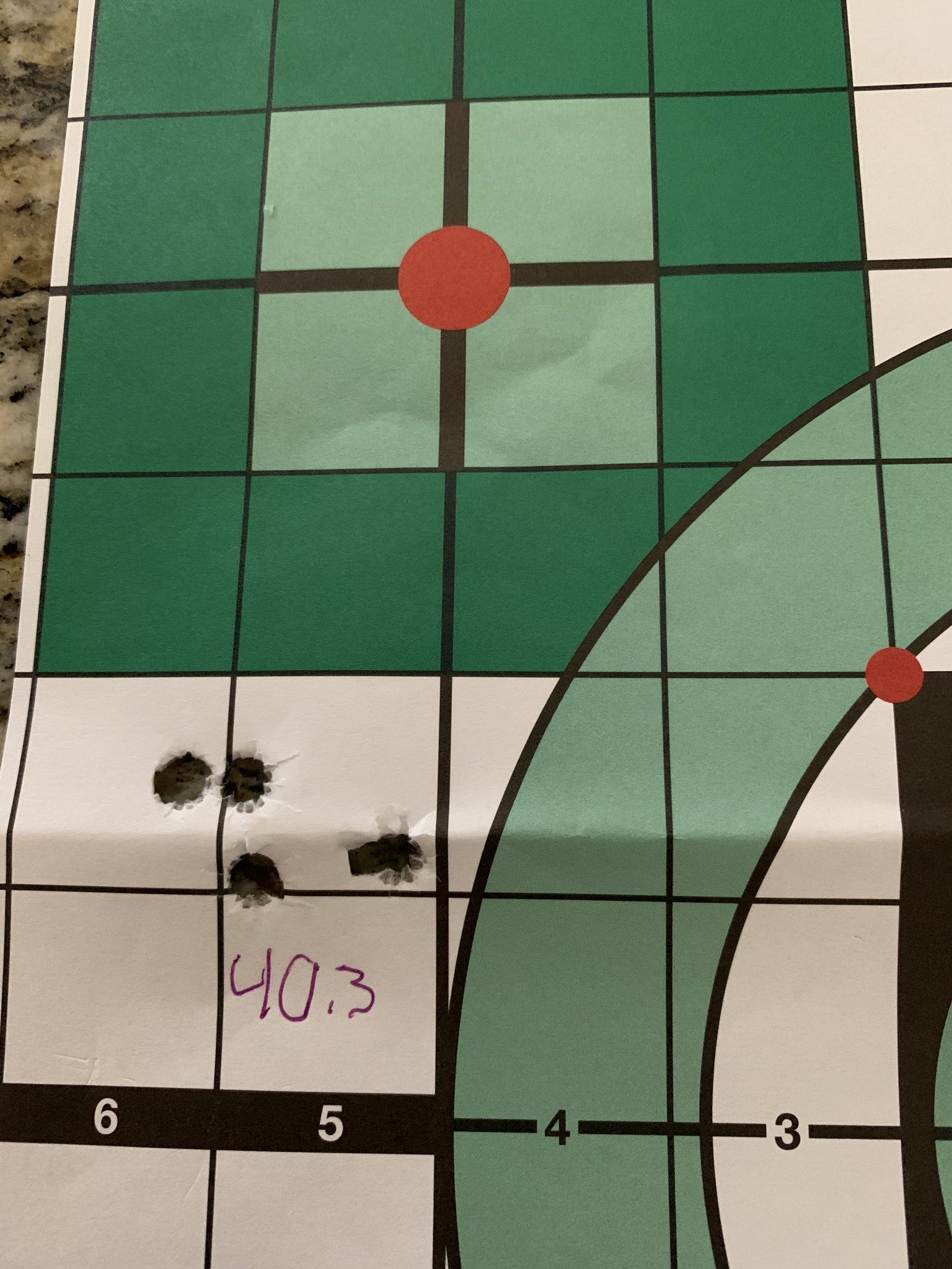

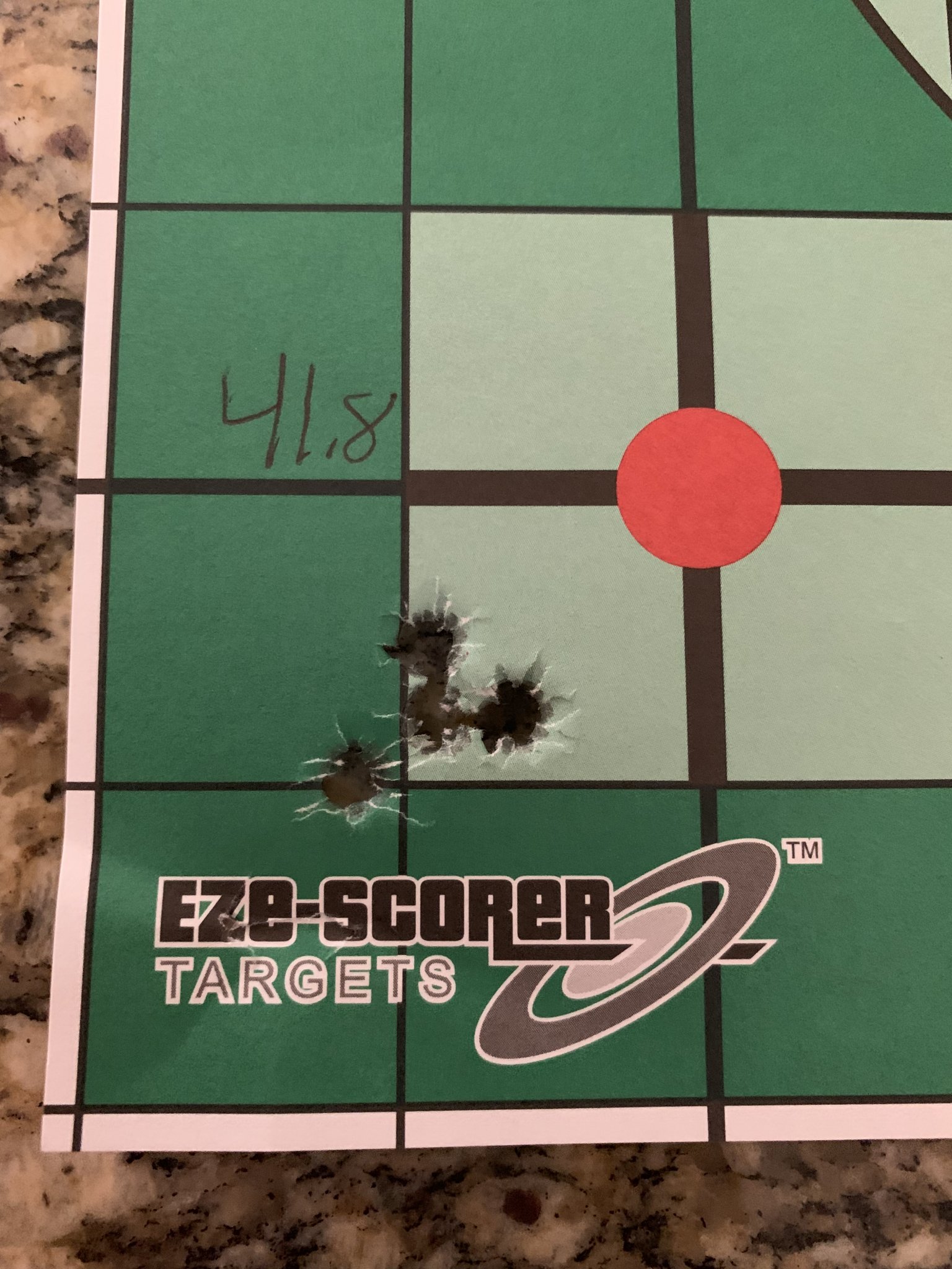

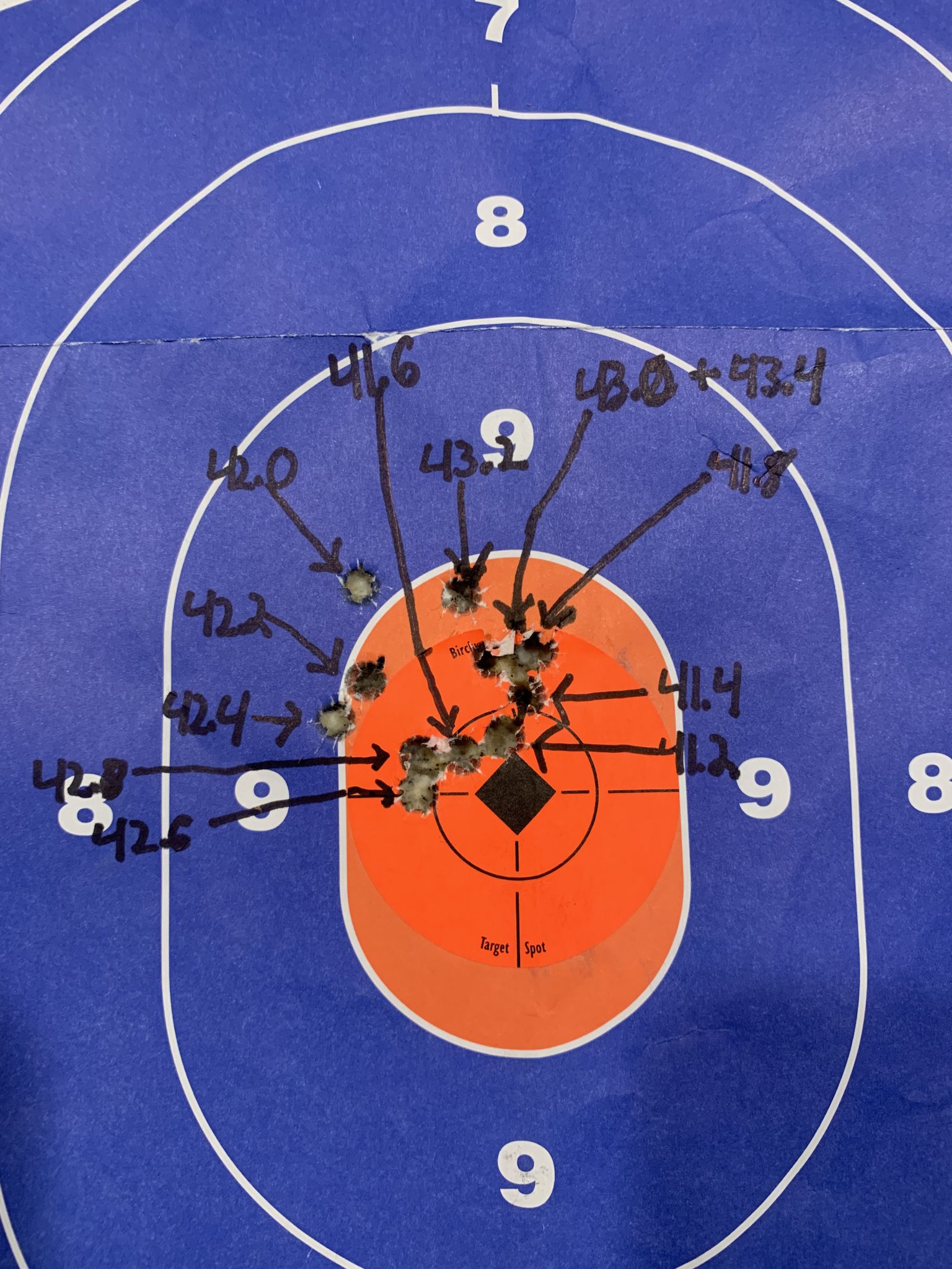

I performed a ladder test early this morning. I fired a total of 26 rounds. I feel like I can see where consecutive powder charges land in the same area, but the velocity differences between each charge is alarming.
All cases are once fired Prime brass. I fully resized each case since the brass was not fired from my rifle. I’m using cci#200 primers. Every round is load to 2.825 COAL. Hornady 140g ELD-M. I’m thinking of switching to Barnes match burners unless there’s a reason I shouldn’t. Reloader 16 with charges from 41.0-43.4 in .2g increments. Bighorn TL3 with a 24” Hawk-hill barrel 1/8 twist. I’m using a Redding press with a charge master and Redding full length sizer and a Redding seater. I plan on getting the #7 micrometer seating stem soon.
I’m seeing a major difference in velocity between rounds that are the exact same powder charge! Is this due to poor practices on my part? I had 2 stuck cases, but they were easily pushed out by a cleaning rod.

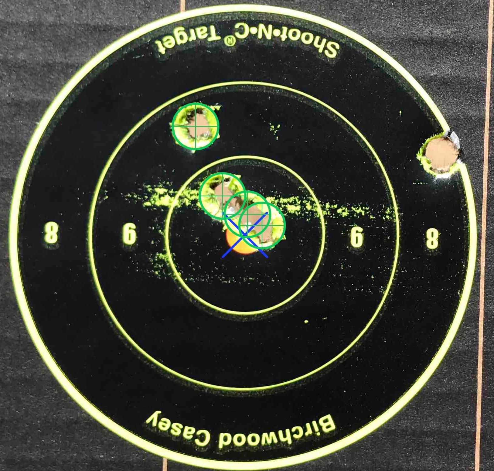

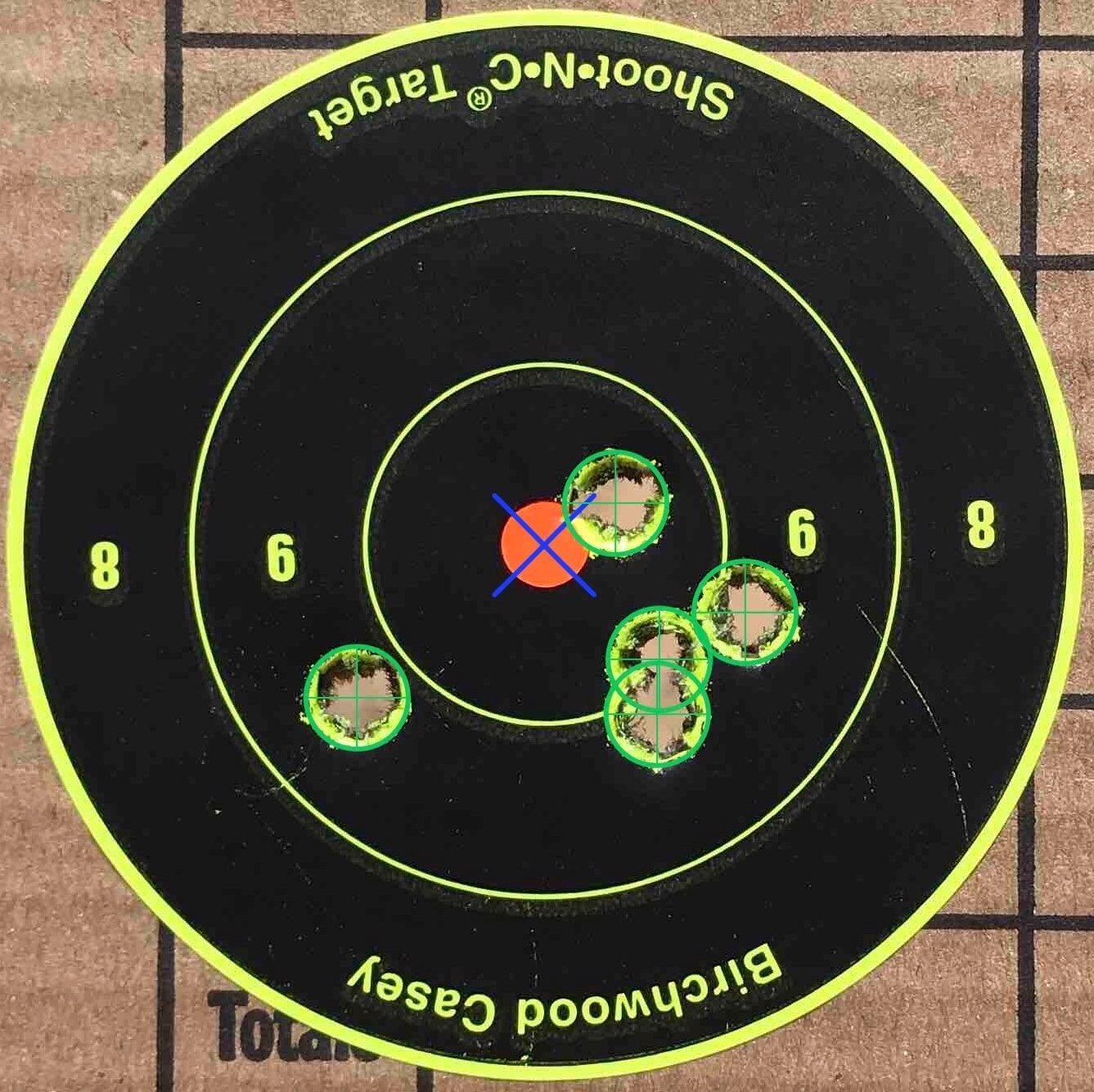

Here are the targets and velocities. The first velocity of the charge is for the blue target, the other is for the red and white target. Please excuse my terrible hand writing.

I dont know what to make of your targets, too close to tell. Also, your blue target leaves 41 missing. And your red target with the shots unspecified makes them basically useless too since we dont know what is what.

Be sure that you wait for the final readout on the CM before you drop the powder, if you aren’t doing so, so that you ensure the charge is as close as you can get with that scale. Mine at times will drop a little after hitting the mark, even with the straw mod, and I use a little powder scoop to adjust the charges as precisely as possible when I’m working up ladder loads.
Is this a new platform for you? Don’t have any previous data? Your charge spread is quite wide... I usually focus on a 1 grain spread when I’m working up a ladder myself. I do like working in .2 increments as you are using.
I also believe that your sampling is far too small... I work up everything in 5 round groups, and usually do two groups at each range (10 shots total) so that I have more data for each node.

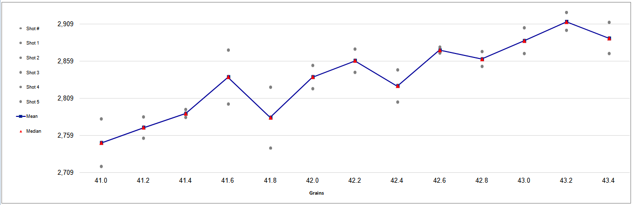

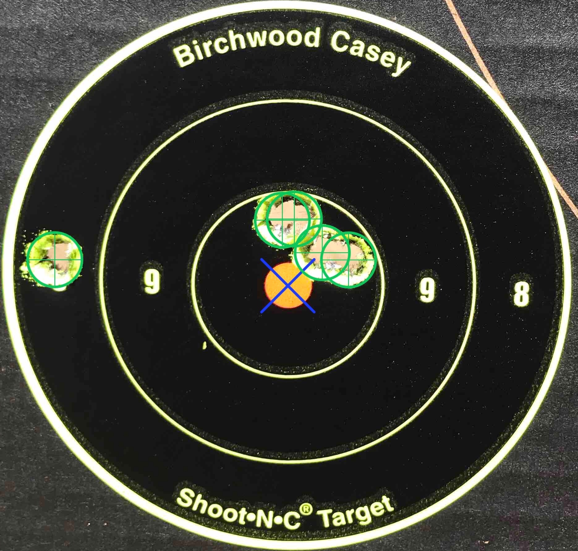

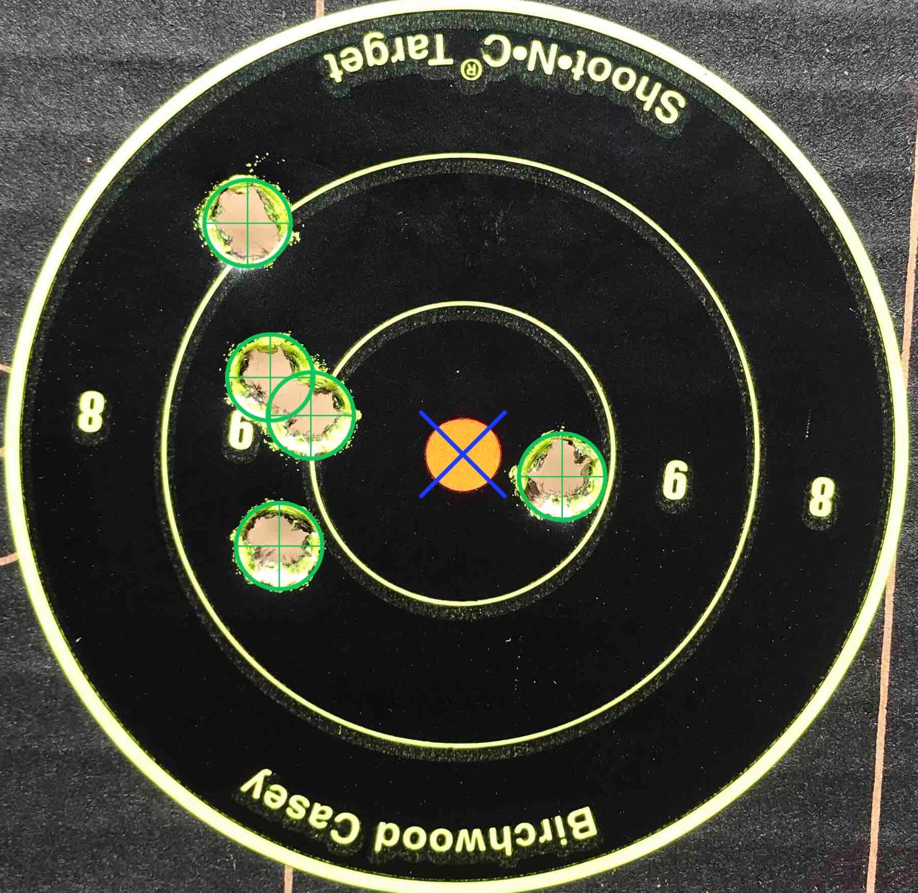

I am working up my load for my Tikka .260, and was out last weekend with a Labradar that I just picked up. I shot a ladder from 42.2 - 43.0 (H4350), and had the following results:
Avg - 2691 ES - 19 SD - 7.6
Avg - 2694 ES - 21 SD - 11.2
Avg - 2702 ES - 50 SD - 18.9
Avg - 2723 ES - 52 SD - 20.7
Avg - 2754 ES - 31 SD - 15.1

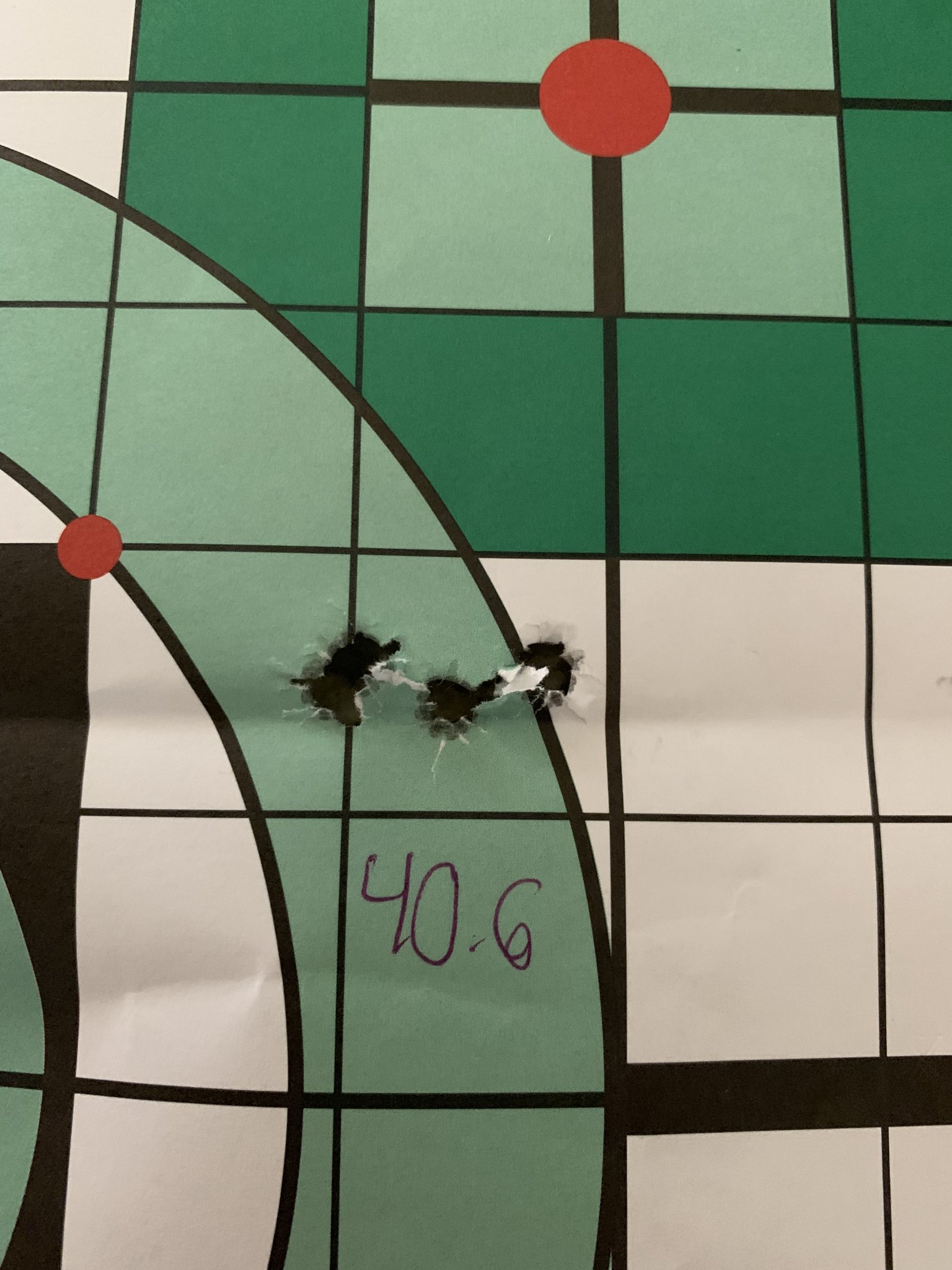

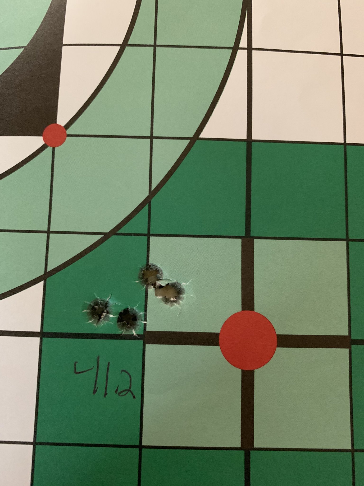

Here are the results for each grouping:

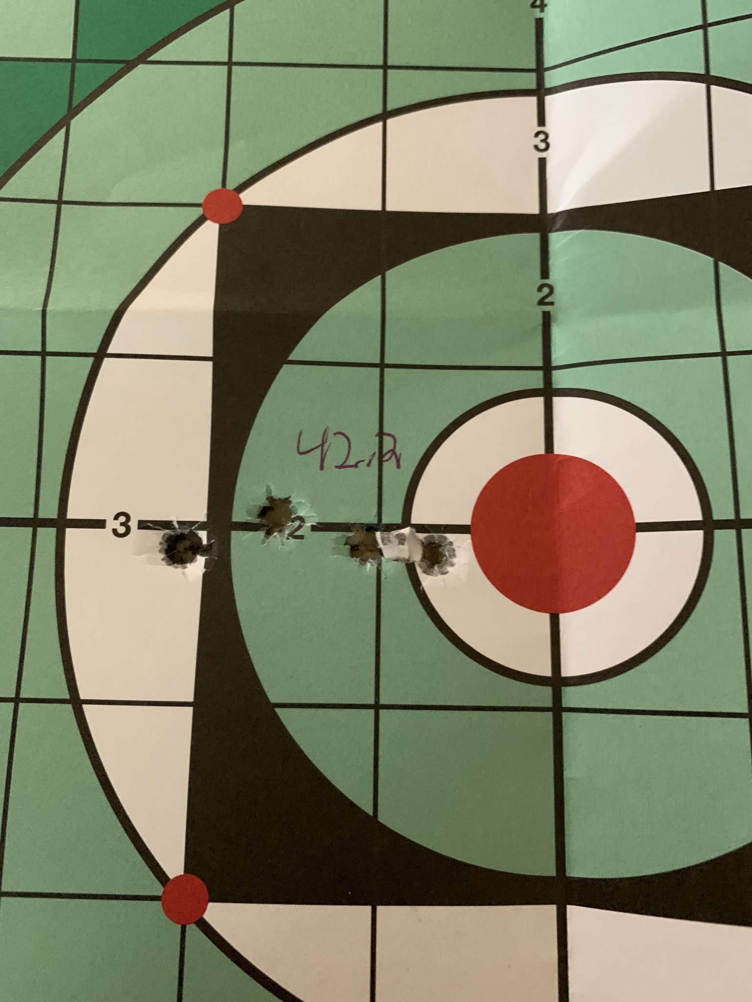

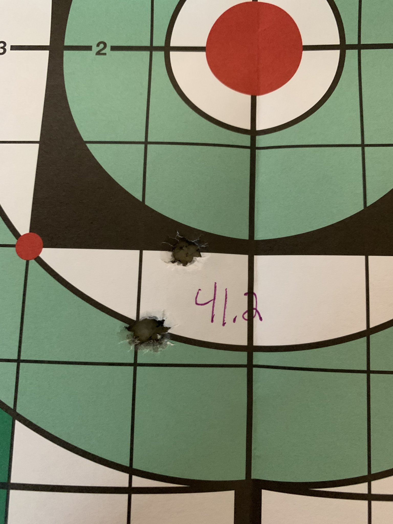

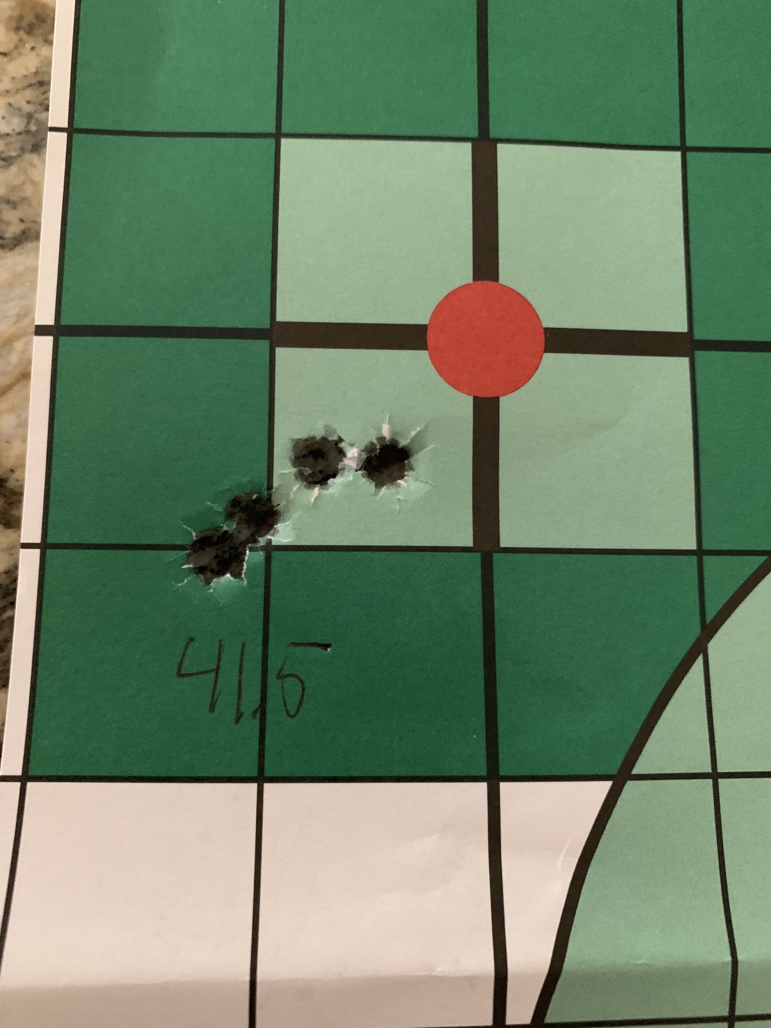

Obviously mine likes the lower end. I was only able to shoot one 5 shot group for each node, so I’ll be going back soon and repeat the process to see if the results are duplicated, but I’m narrowing the range down pretty well so far.
Obviously the hardware is far better than the software (shooter) at this point - I’m pretty novice in all honesty. I pulled a shot in nearly each of the groups, but what I’m paying most attention to is the vertical data as that is where the deviations will manifest themselves significantly.
I know that the lower values shoot well in my rifle, as I was able to hit two straight out to just over 3/4 of a mile about a month ago. I didn’t have any chrono data until now, as I just got the Labradar, so I look forward to having that input in addition to anecdotal data from target results.
Good luck!

The blue target 41 grain charge was accidentally shot in my group of sight in shots. I felt the same way about the red/white shots as well. Something had came up where I had to get home earlier, forcing me to rush things. I thought I’d rather shoot the leftover ammo and maybe get some velocity data rather than take it home with me. What programs did you use to make those charts?

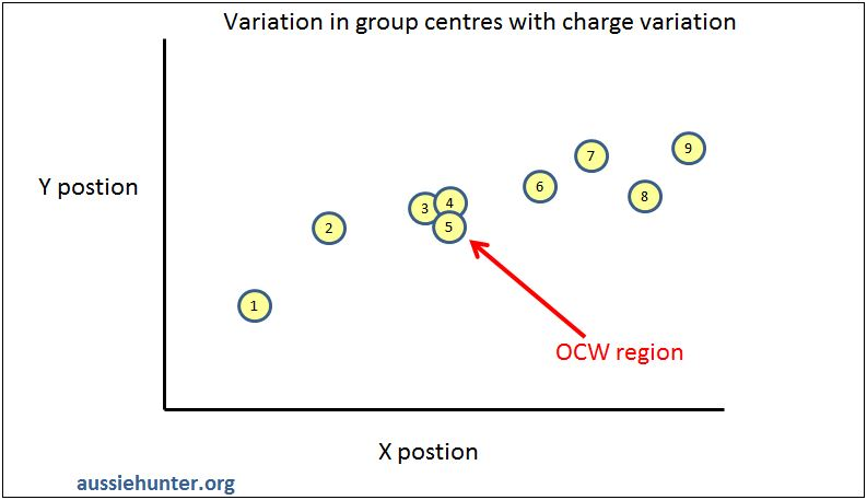

there is an embedded link in the article, it only goes to 10 so you have to edit the formulas and charts to include the extra lines necessary.

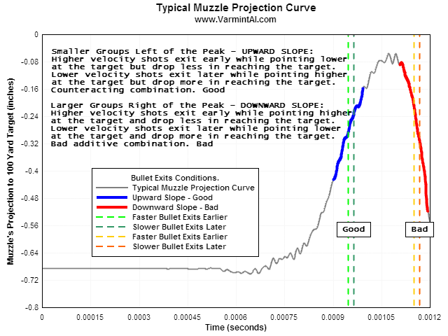

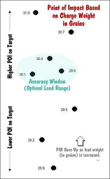

No, dont shoot a ladder at 200. Do it at 300 plus with 5-600 being way better still. The ladder test allows you to see how the bullets flight and gravity interact with respect to the theory of positive compensation can do its thing.

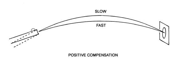

When you fire the rifle the barrel whips around and expands and contracts etc, look at these gifs for examples of all the various ways https://www.varmintal.com/amode.htm
A ladder test is extending the distances so that those small effects are minimized in relation to the gravity component, the longer gravity can influence the bullet in flight the larger that one component will appear.
If the fast bullet leaves the barrel a bit sooner while its lower in its vibration pattern and the slower bullet leaves the barrel a bit later at the top of its vibration then ideally the bullets at some point will cross back onto one another.

If you only have access to 200 then ladder testing in the incorrect methodology. You should instead go with the OCW methodology.
In this you load up 3-5 rounds groups for your charge weight increments (more data is always better) and fire each charge weight at its own target. You then compare where consecutive groups impact the same area in relation to the point of aim. Ignoring group size you want to find a series of charge weights where the point of impact is consistent from one to the next and then work on your seating depth to shrink the groups.
If you were to take all of the individual targets after they have been shot and stack them on top of one another you would be looking for where they are clustered together.

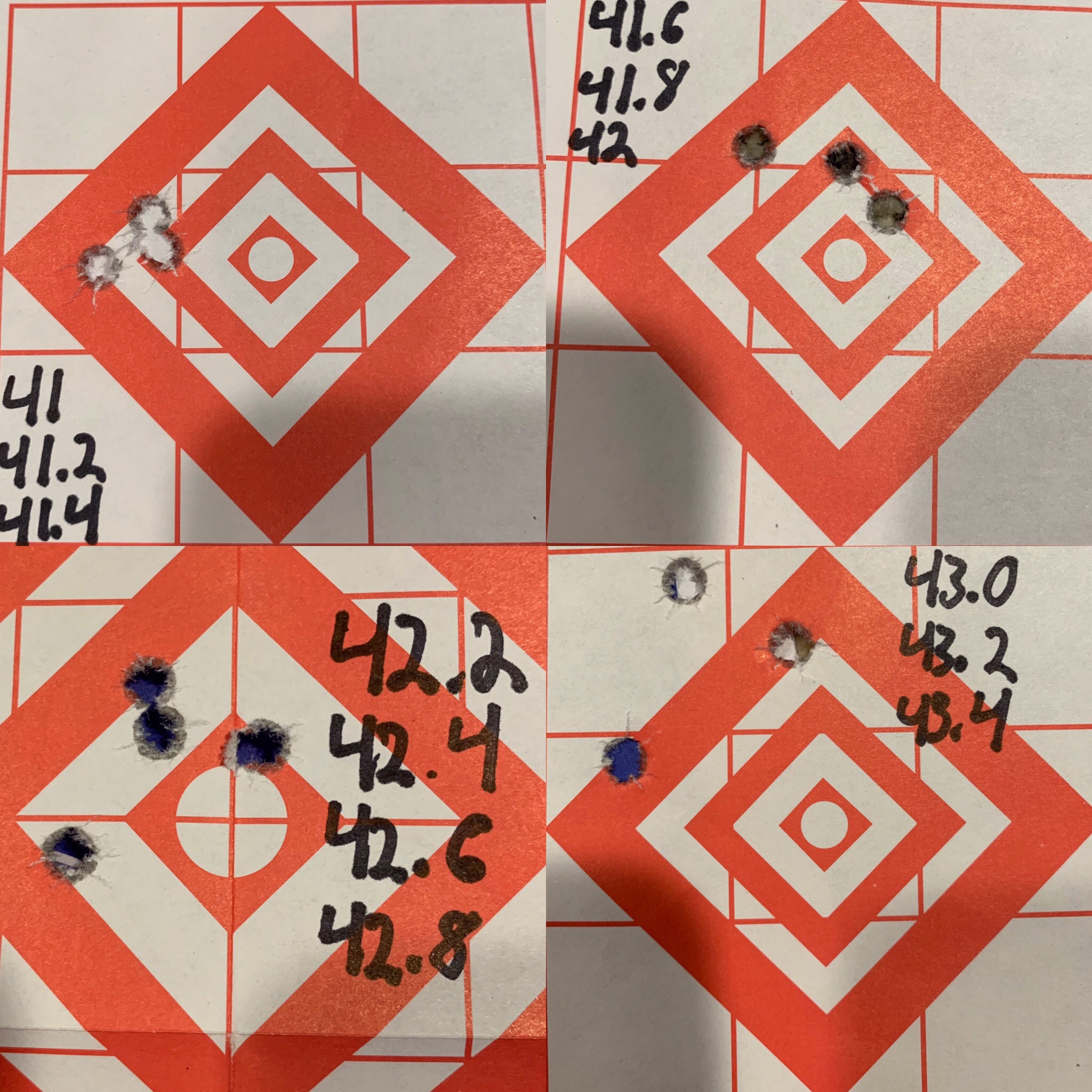

I can’t discern any useful data from the targets you posted, sorry, so I can’t deduce any node ranges to focus on. Presuming that you were aiming dead center for each shot.
I myself would maybe research some posted pet loads, and focus on a smaller range to evaluate. Looking at Hodgdon load data, it appears that the min/max range for 6.5 CM varies about 3.5 - 4 grains more or less, depending on the powder. Looking at the .260, the range is much more narrow. Given that, and presuming a blank slate, I would start with 5 (or 10) rounds near min and go up in .4 increments up to, or near, max. This data should give you some areas to focus, and then you could work up ladders in .2 increments to refine your optimum node.
Otherwise, if your research finds most seem to have good success in a more narrow range you can throw out the high and low portions of the range and start working up in that window. Paying attention to vertical spread, along with ES and SD, should give you good results to then take farther out in distance.
Every gun is going to be unique, but I’d be willing to bet there are a lot of commonalities in load results for a given caliber on a given platform.

I think what I’ll do as I perform the ladder test I will load some rounds at the known pet loads as sighters and also shoot groups at that distance to see how well those work.

Personally, I like OCW more than ladder methodologies.
Ladders are great if you have your shit together, you can find out where you want to go with very few shots.
If youre just learning the ocw method is a bit more beginner friendly and you can shoot groups with as many data points as you care to. 5 rounds groups is really informative and helps weed out what the load is doing vs how you pulled that one shot out etc. just by giving you a larger data population to sample from.

In knowing what most others are running I would probably look at the 41.8-42.8 area. I see 42.X being a very frequent report from others. Or go for 4 shot groups and run

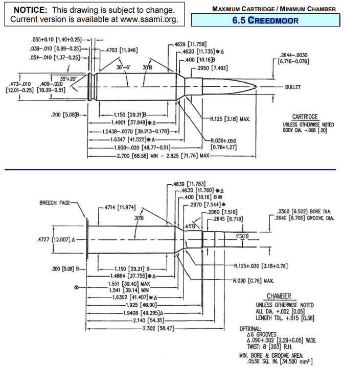

Why did you pick 2.85 COAL? You should figure out where the bullet touches the lands, then seat back 0.020 further. Measure the ogive of the bullet, not OAL.

The reason I went with 2.825coal is because that seemed like the place to start from reading others load development and I did not have my modified case in yet to do the measurements for finding the lands. I have the comparator to check the measurement from the ogive but I didn’t go that route because I knew I already wasn’t basing the oal. When I got home I started to look up videos and found the video where I remove my firing pin assembly and extractor and test the oal, I cannot recall the videos name but it seems to be fairly popular. I will be doing this when I get home from work today.

Your seating depth numbers seem fine but I’m assuming that’s a dial or without zeroing the calipers for the comparator?
I would bump the shoulders back .002 from the longest fired in your rifle, which is 2.602-.002=2.600. That 2.600 should chamber smoothly. If not, cover a case in sharpie and chamber it, see where it’s rubbed off to see where you’re not clear. Probably not the shoulder but the base if there is an issue at all after you having sized and moved the shoulder to clear.
Here are the targets and velocities. The first velocity of the charge is for the blue target, the other is for the red and white target. Please excuse my terrible hand writing.View attachment 7100826

  2. Velocity spreads: the DIY Magneto mount may seem like a good thing but it may be adding to the velocity spread. If the sensor is moving in any way or angled slightly up/down/left/right, you will probably get funky readings. Verify its working properly by sending 5-6 rounds with magneto attached to barrel then 5-6 rounds attached to your mount. If you see a difference in SD between the two, it's likely the mount causing issues.

The black marks and possibly slightly stuck cases could also just be gunk in the chamber, since its a used rifle give it a good solvent cleaning and wipe that chamber out clean. Tossing them works too with fewer headaches lol
Better if you have a copy of your own reamer print but saami spec is 1.920-.020 so anywhere from 1.900-1.920 is in spec. Usually I split the difference so I would trim to 1.910

Magneto mount: some use them but I work in precision velocity measuring equipment (albeit doppler radar) and, typically, issues with data are mainly from setup issues. I would suggest mounting to barrel. I have seen slight POI shifts with magneto speed (usually higher) but I would suggest you do the following: either test for velocity/SD mounting MS to barrel OR test for accuracy/precision and take the velocity/SD with a grain of salt until you can check with MS mounted to barrel.
Group size could change (in my case, it was slightly better with the MS than without) but generally, they are pretty consistent in size with a slight POI shift. Others may have experienced differently, but setup (how close to boreline) and barrel profile are going to effect POI shift.

made it out to the range today, no magnetospeed. I didn’t adjust my scope before shooting the 40.9 charge and shot it off the paper. Nothing special from what I could tell.
Since there's no Chrono.....My inclinations are towards finding out what 41.6,41.7 and 41.9 would print like because 41.5 and 41.8 "seem" huddled into the same spot. I wonder what others think. I'm always wrong and constantly learning))
