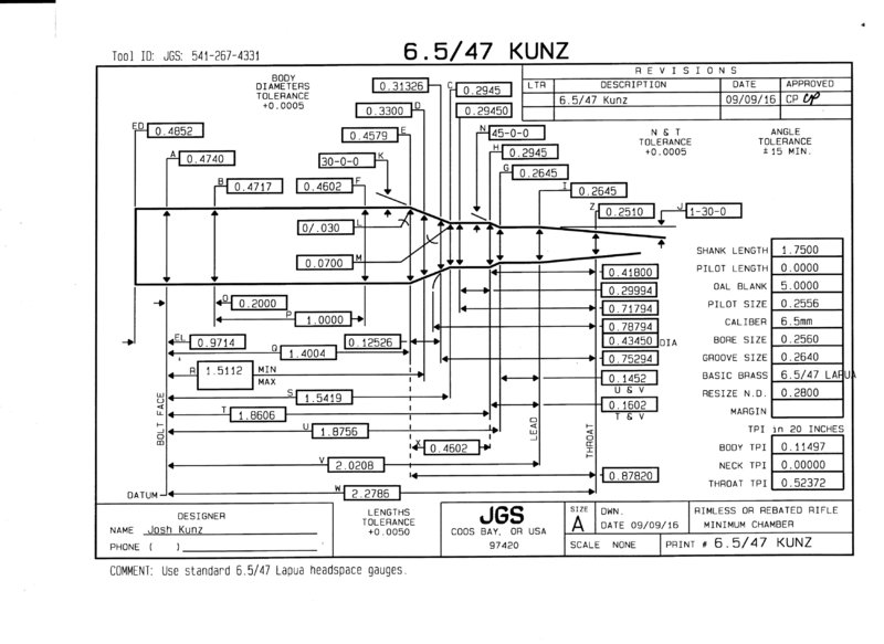

    Ok, something weird is going on. First, this is a pretty standard JGS reamer, nothing really custom except for the neck diameter and freebore. Second, the Whidden dies are full length NON-bushing dies, with the button neck ID expander. This means there is no radius on the neck/shoulder junction like you see with bushings dies. LRI did the AX barrel with the gun in hand, so it headspaced perfectly with the virgin brass I provided.
    Here are the measurements I'm getting:

    Measure, compare to reamer print, also, stick your caliper in the die mouths, and get basic idea what it will size brass down to.

    Is your reamer a removable pilot or solid pilot?
    Do you have access to high quality measurement tools (not a $30 set of digital calipers). I have some too but it'll add credibility to your measurements as literally .001 makes a difference here.
    I find it troubling looking at a fired case shoulder diameter that measures larger than the finish reamer print. It appears as though the "mid" measurement is larger as well, but uncertain if that was made 1.200" north of the case head.

    My next three questions would center around determining if in fact your fired brass diameters actually do indeed exceed the finish reamer print diameter dimensions.
    Diameter of cases with several firings on them at
    1. 1.200" north of case head (your reamer print has this 1.200 dimension spec'd)
    2. Shoulder diameter (if it's .050 south of it it's ok)
    3. Solid pilot or removable bushing pilot reamer

    1. At 1.200" (as best as I can measure) the fired brass is right at the 0.460" that the print shows, and the 0.004" bumped case is right at 0.459".
    2. The shoulder measurements provided before are about the best I can get with the 1" mic. The print shows a shoulder dia. of 0.458, and the once fired brass is measuring about 0.459" a little bit lower than the shoulder (maybe ~0.050" lower). The important thing is the sized cases are 0.002" smaller in dia. at the shoulder.
    3. It is a floating bushing reamer.

    The shoulder diameter of fired cases shouldn't exceed the reamer print dimension.
