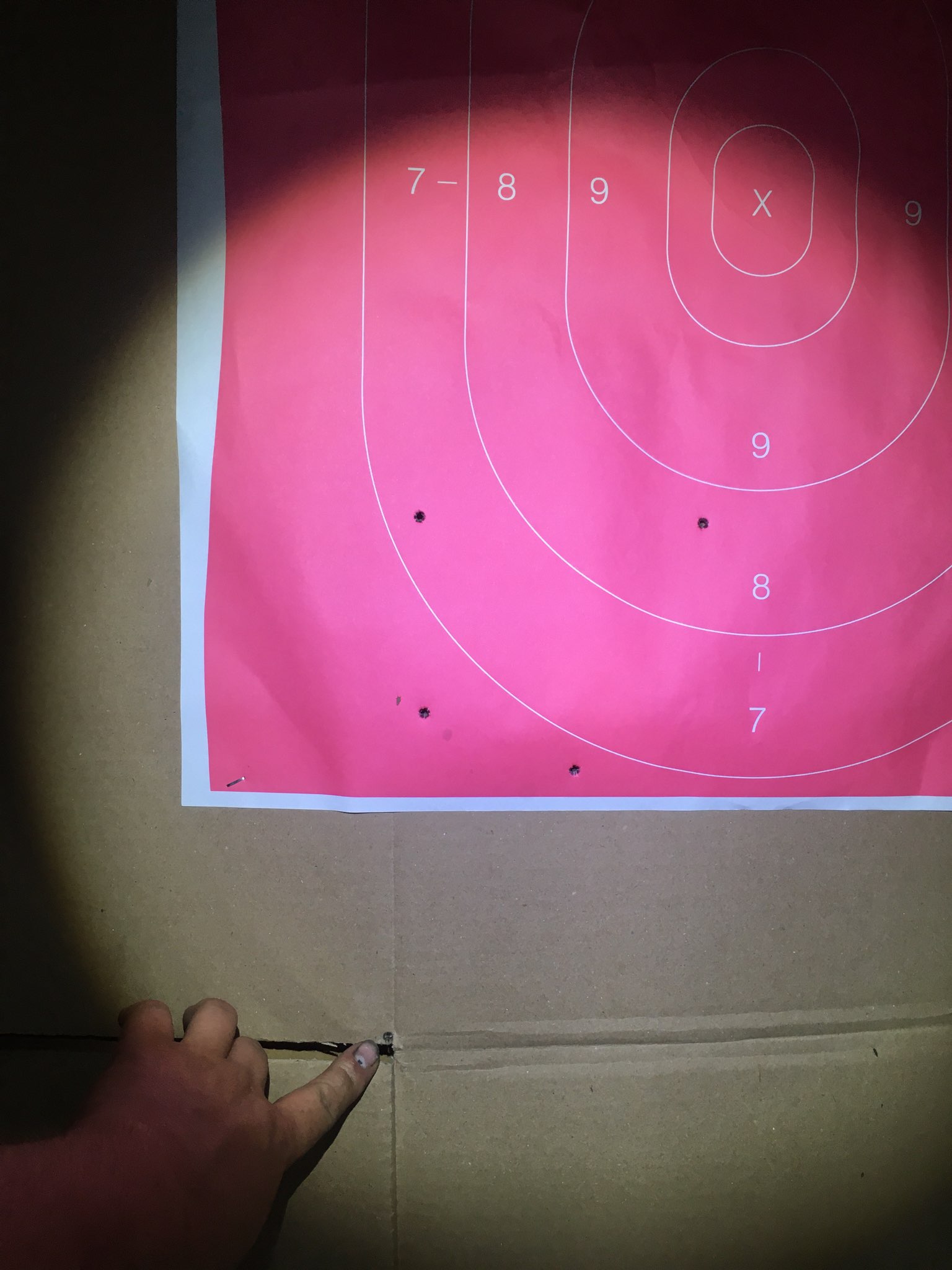

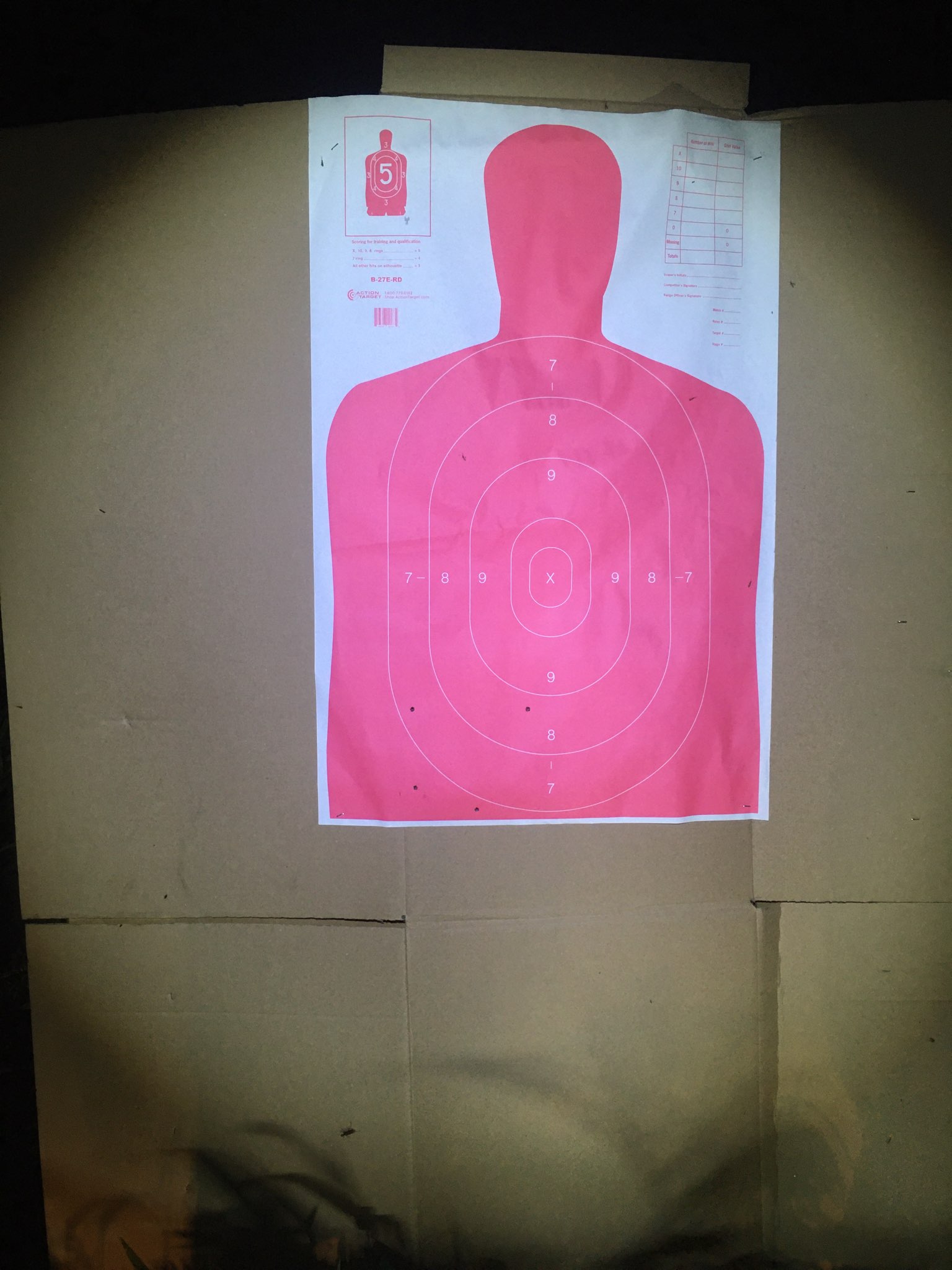

Last night my shooting buddy and I pushed out to 1,000 yards. Set up targets and shot at 450 to make sure we were still on from 2 weeks before. Pretty much have shot all prone as we moved out over the last few months. Last night we shot out of the bed of his truck because the grass on the field roads is so tall, that was pretty cool and a first for us. I shot about a 10-12 inch group and he shot an 8 at 1,000. It was pretty awesome.

My first group at 1,000 caught the right edge of the cardboard. Adjusted .7 left and shot this group.
